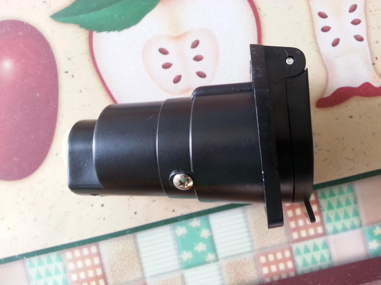

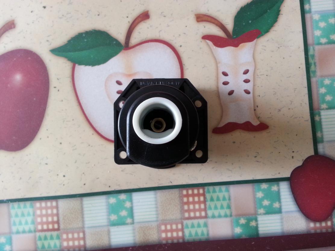

I have an '08 RAM 1500 and would like to replace the seven contact trailer plug. Problem is, the connector on the truck is an eight pin rectangular type but I can't find any new plugs with that type of connection.
Any ideas? The old connector's contacts are very corroded and this is causing my trailer lights to not function properly.
All the newer types of plugs have the right number of contacts to connect to the trailer but the connection that goes to truck is circular and I'm not it will work.
Here is the new connector
Attached Thumbnails Replacement trailer plug-20130731_141229.jpg   Replacement trailer plug-20130731_141241.jpg

I tried cleaning the contacts on the truck plug with a wire brush and contact cleaner, but no difference. I don't have right turn signal or right brake light on the trailer. the bulb on the right side of the trailer is good because it comes on when I turn on the truck lights.
Anyone tell me how the connector in the pics comes apart?
