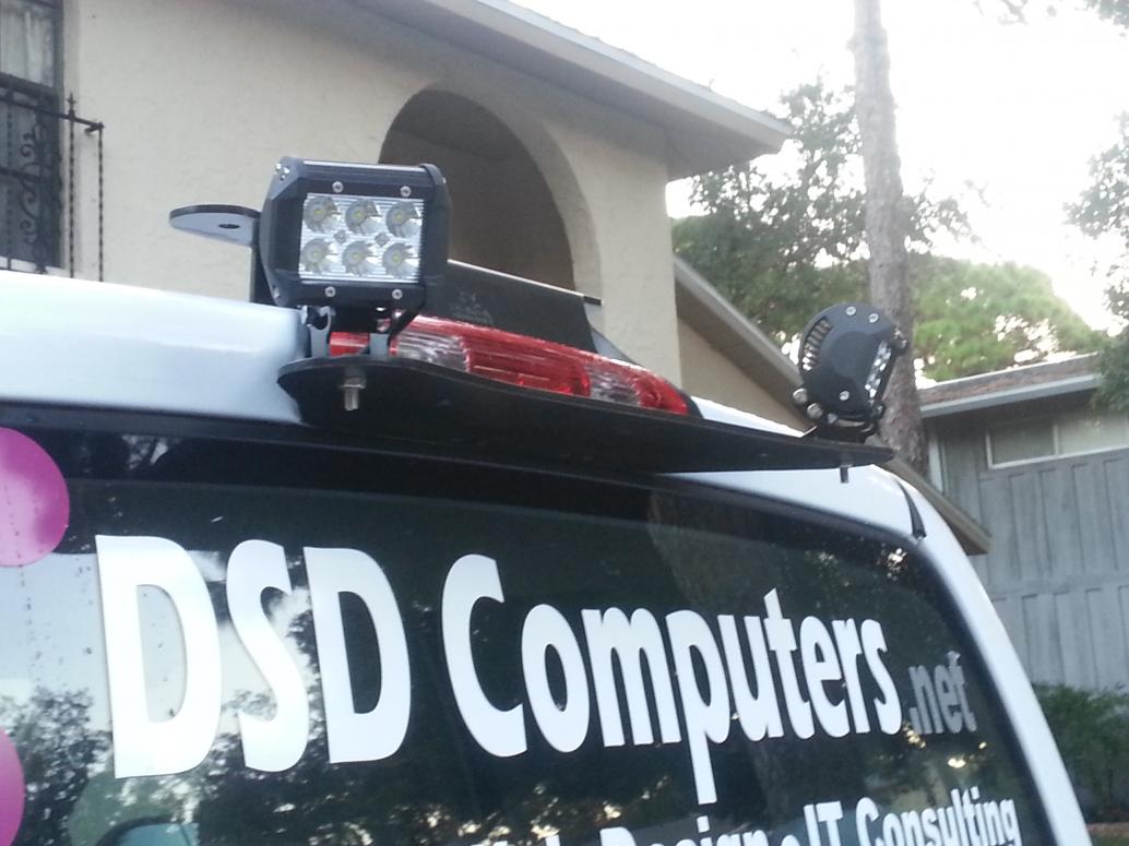

I searched hi and low and wanted a simple no drill way to mount a pair of work lights and was about to give up and buy a full headache rack until I came across this:
http://www.pickupspecialties.com/Lig...ight_mount.htm
I ordered and installed and it actually looks pretty nice IMHO so I figured Id post about it.
It has 5 attachment points on the lower rear deck and 2 more on top which I may use for a LED strobe deck for when i'm towing.
Attached Thumbnails Clean way to mount some cargo/work lamps.-20130913_073136.jpg

Thats pretty cool! Were u able to tap into the existing wiring or did you run new power and ground wires?
Im using my existing harness and tapping into the "Cargo" light wire, which is ok when using LEDs like I have, Anything bigger though Id run a new wire.

A important factor for me is it must look "clean" like something that could have been a factory option and not slapped together, this is why I like to use my factory harness for all my lights and factory mounting points.

Couple other pics when complete.
