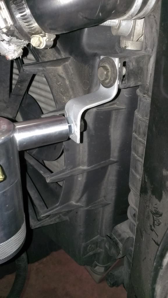

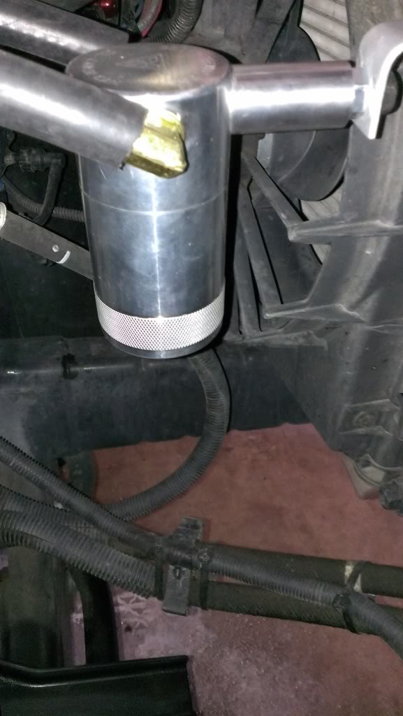

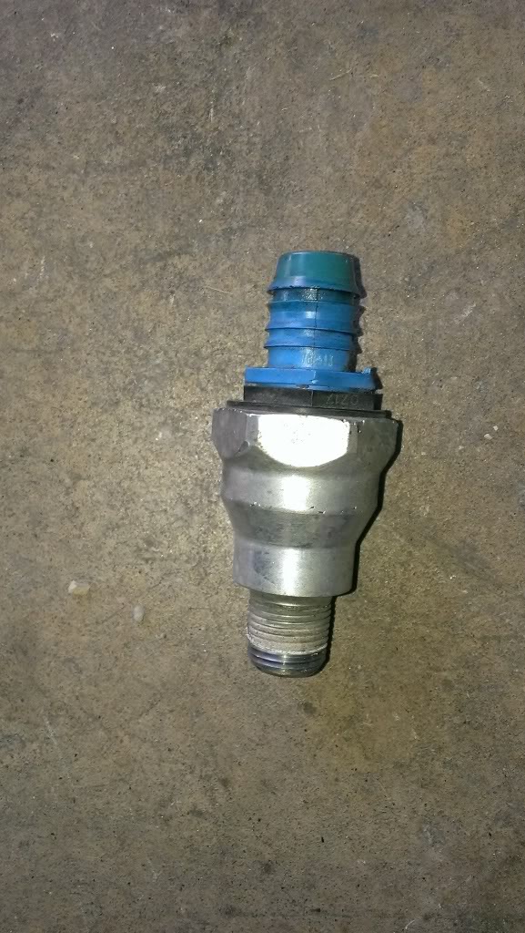

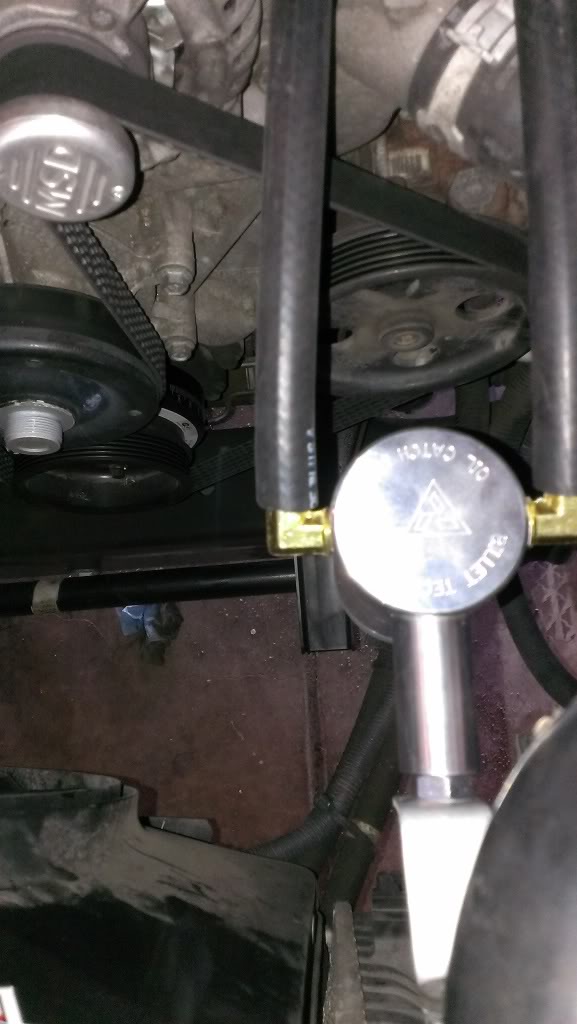

So everyone says it cant be done or wont work, that may be the case on the 3rd gen Hemi but not exactly on the 4.7. The 4.7 has an external PCV system opposed to internal like the 5.7. Anyways here's some pics of the install on my 07, i also changed the PCV valve while i was at it and made a bracket to mount it.

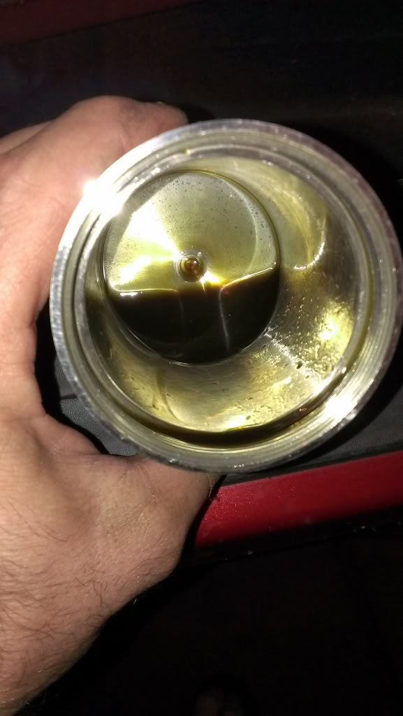

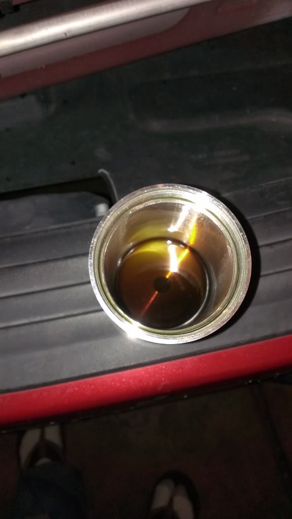

After 2 days of driving maybe 150 miles.

looks good.where did the hoses go on the engine?.I've seen these done on other vehicles. but this might be something I would want to do.i just don't know where the hoses go after the can.

It comes from the pcv valve to the can and the other hose goes into the back of the intake manifold. I have the 08 intake manifold so the input for the pcv on the IM is on the side vs the back which makes it a tad easier to do.
