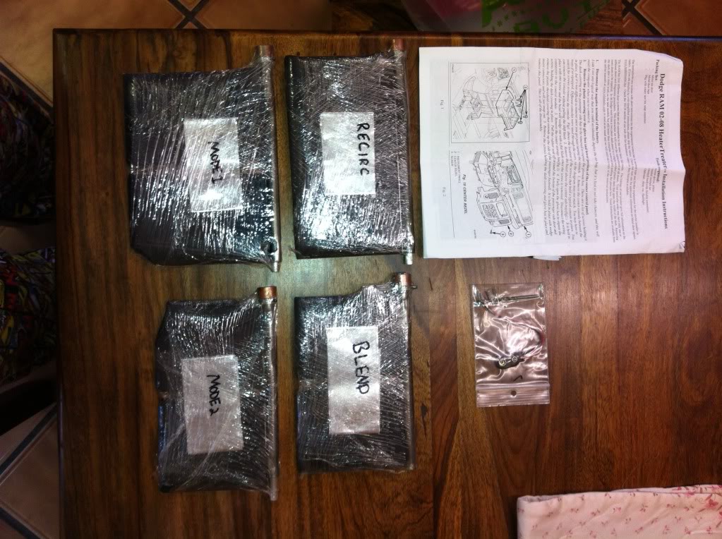

Just thought id post up a pic of the Heater Treater upgraded doors, to repair the common damaged Dodge ones.
The doors appear to be very much more robust than stock.

I was very lucky.
After using the Heater Treater diagnosis video, I only had one issue, a defective recirc door. By happen chance, the easiest of the faults on these HVAC systems to repair.
I bought the whole shebang from Heater Treater, as the stock doors are of such poor quality it's only a matter of time before they fail.
Heater Treater are right on that one.
As for cutting etc, on the recirc door it says to cut the grating above the doors to allow fitment.
I didn't.
I'd previously dropped the HVAC fan and motor earlier this year, reached up and yanked out the defective door. I did the same last month when I got my replacements from Heater Treater, and just refit the door through the opening left by dropping the main fan and motor again.
No cutting and the repair all looks stock.
I only have the single zone heating so can't comment on the dual climate system.
I wouldn't have any problems following the instructions with the doors to repair the other doors such as the blend and mode doors if needed with these replacements.
