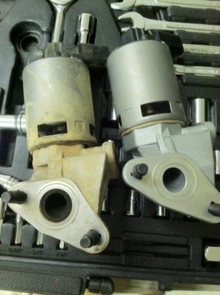

I replaced mine in 2011 with just under 95,000 on it. Same deal through a code. Was quoted 2 to 3 hundred bucks to do it. Did it myself in a hour or so.
Attached Thumbnails EGR valve replacement-hemipower45-98765-albums-begining-pics-5013-picture-223110-1965835830896-3943173-n-45493.jpg
