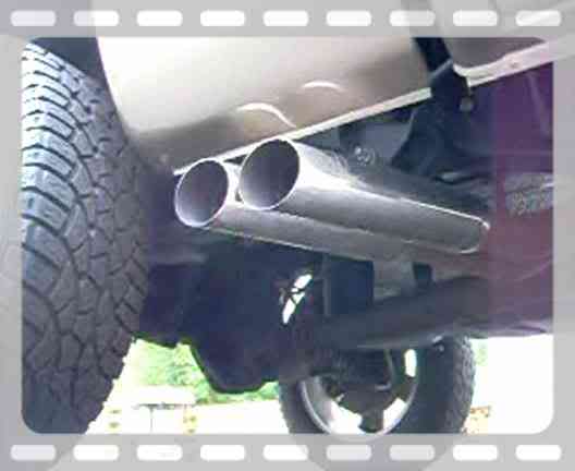

I have Magnaflow catback with a dual exit in front of the rear pass tire. It's an 18" oval body muffler, it has a mild tone to it and is very quiet inside the cab. I tow a bunch and have zero drone. When I hammer the gas, I can hear a mixture of engine and exhaust. The exhaust does Not over power the engine scream so the 18" is probably borderline for you.
