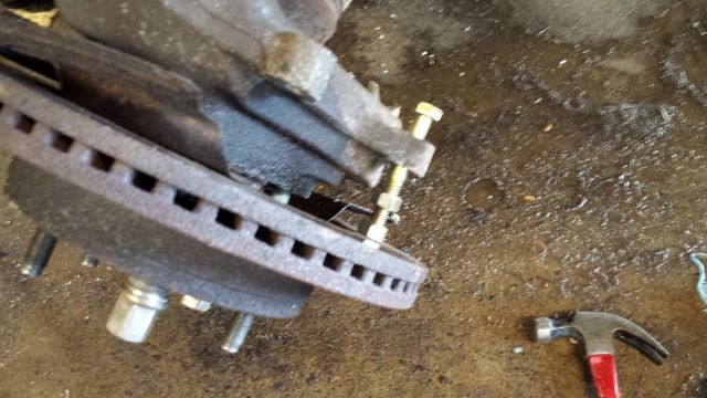

I used an old trick to remove rusted on rotors to quickly break the hub loose (pic attached). For this, I used two grade 8 bolts and 4 nuts. The idea is that you thread a nut to the inside of the caliper mount, and one nut on the end of the bolt. The nut on the end of the bolt really just protects the bolt. I also use an old pair of brake pads to help make up the distance and prevent gouges in the rotor. Put a wrench on the head of the bolt and one on the nut against the knuckle. As you tighten the nut, the bolt will push out. This works great for popping off stuck rotors, and in this case, stuck hubs. I put the rotor back on with two lug nuts to keep it in place. Keep alternating on the top and bottom bolt to keep the pressure even. Once I had a lot of tension on the bolts, I partially threaded two of the old hub bolts (closest to the side I was working on) back in. It only took about two good whacks on each hub bolt to pop it completely out. To be fair, I had used a lot of PB Blaster and already tried pounding on the hub bolts to get it out. I'd go back to this method of getting rotors off if I had to do it again.
