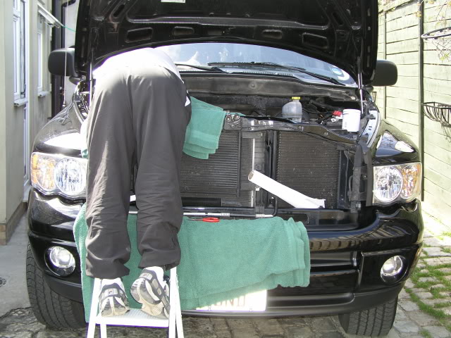

You can just see it mounted here. Bottom right of pick near headlight.

Kinda hard to see, but there's a white circle around it at the bottom of the driver side headlight. This is how 03-08 have it; 02 is an oddball with it mounted under the hood.
