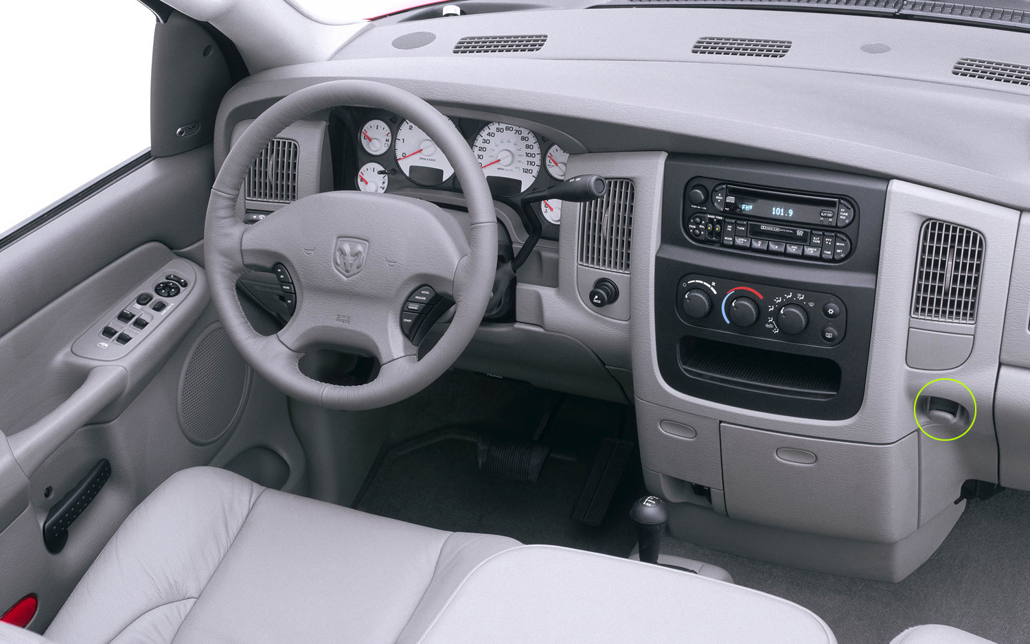

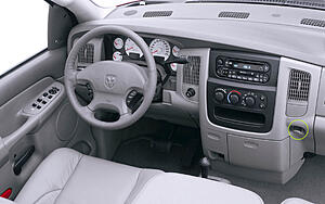

Next look at the radio bezel locate the Phillips screw located here.
A/C, Heat Temp Control Back light replacement-rxzbcqz.jpg

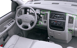

Remove the screw. Now, gently pull on the radio bezel in the locations indicated here to free the bezel
A/C, Heat Temp Control Back light replacement-esztitw.jpg

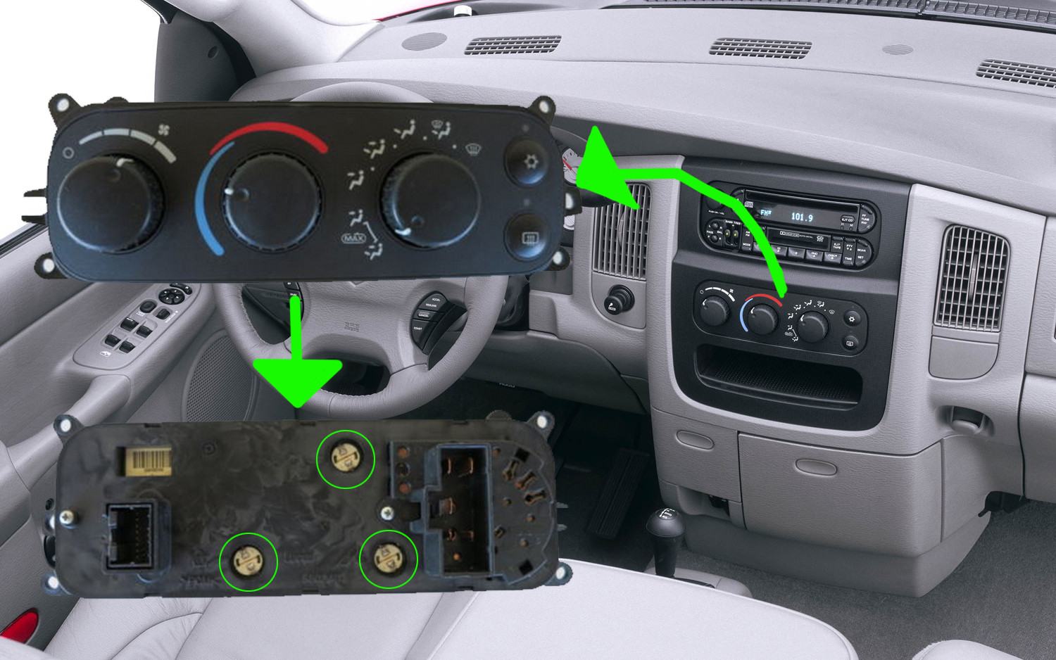

With the bezel free, gently move it away from the dash and disconnect the connections at the back of the HVAC control unit.
A/C, Heat Temp Control Back light replacement-cizyhdd.jpg
Inspect the unit, locate the three bulbs as indicated above. Twist them to remove, insert new bulbs and twist to lock.
