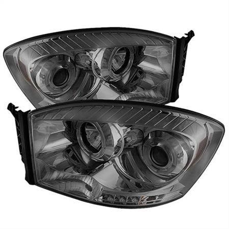

I've found headlights im interested in. They are Spyder LED Projector headlights that use T10 LED Ultra white LED bulbs.
