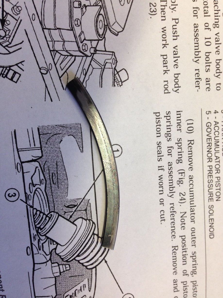

Hi, I have a 2003 2500 4x4 Cummins 250hp with a 47RE gearbox that started to shift badly.
I took the oilpan down from the gearbox and found the part in the picture.
I think the easiest way would be to find a used 47RE but since I live in sweden its not so many to find here.
I know that I have the early version of 2003 and I found a gearbox from a 2001 V10 4x4, is this gearbox compatible electronically?
