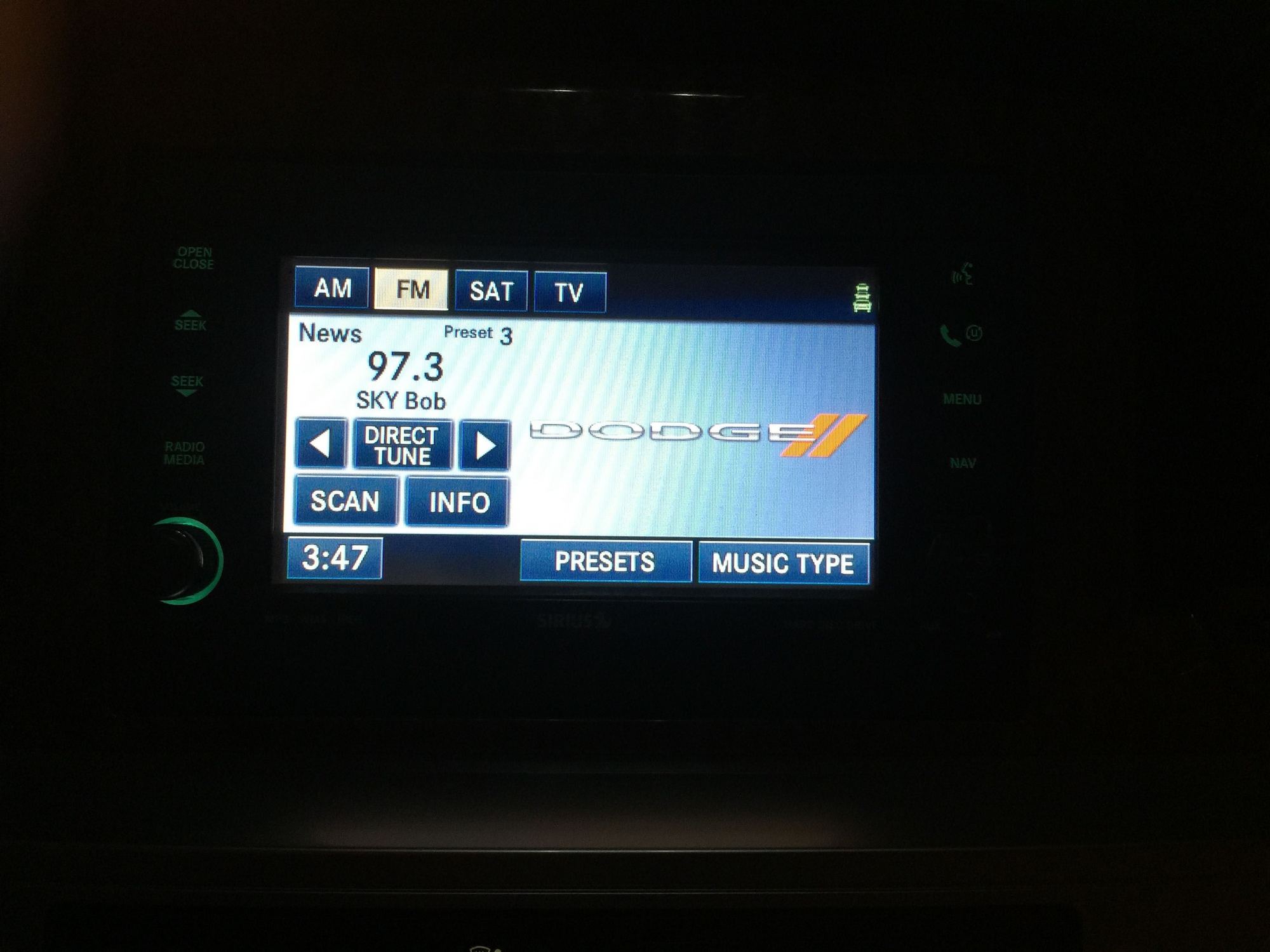

I thought I'd post something a little more up to date then some of the past MyGIG installs and let everyone know what's needed to do it.
First, you need a LowSpeed CAN Bus MyGIG. This site actually has a great breakdown of all of the MyGIG models along with what vehicles they came in.
My new MyGIG RER came from a 2008 Chrysler 300 with a 1 year warranty. You can expect an average price between $500-800.
Then you need to buy the interfaces. My Laramie came with a REC Radio, which included Sirius, Nav and UConnect.
I purchased the MyGIG Lockpick Adapter, which also allows you to hook up your reverse camera (if installed), along with adding other features, such as a Video Entertaining settings, video while driving, enter destination while driving, etc. You can find more information here.
Along with that interface (which comes with the FM/AM antenna adapter), I ordered the Sirius Extension cable (the MyGIG has a built in Sirius unit, so you unplug the harness behind the glovebox, and plug THAT harness into your new extension. The other end of your new extension goes to the back of the MyGIG.
You'll need a new GPS antenna. Pop your forward dash cover off, unscrew your old GPS antenna and you can just cut it from the wire, then install the new antenna and route the cable on the outside of the defrost channel that comes up to the dash.
You'll also need the UConnect harness. Just like the Sirius, the MyGIG has built-in UConnect. So you unplug the existing harness (behind glove box, to the right by the kickpanel) and plug the existing harness into the jumper. Plug the other end of the jumper into the back of the MyGIG.
From there, install the new MyGIG into the dash, button it up and turn it on. (Actually, turn it on before buttoning everything up, just in case something goes wrong). It does take 30-60 seconds for the Lockpick to initialize on first boot. My Nav took a couple of minutes to start working correctly (Make sure you set your home state).

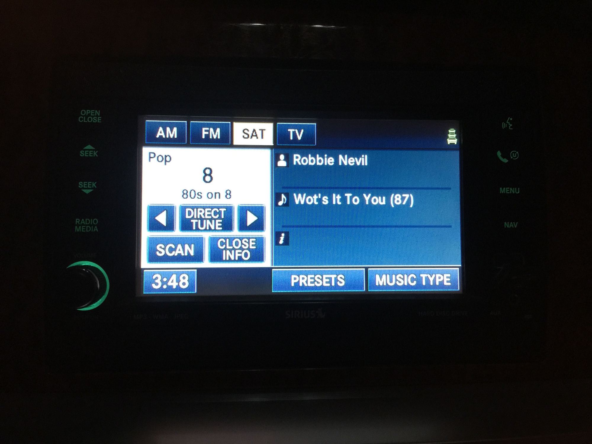

The Bluetooth paired up, too. When the MyGIG says to enter a code, just enter 0000 then on your phone, it should start the pairing process. (I have an iPhone 6+ and have no problems). It downloads the phonebook from your phone at startup.
I also purchased the Mopar iPod adapter, but found out it only works with 2009 and later MyGIG's, so it won't work (Harness actually has a SLIGHTLY different plug on it). That's fine, I've already loaded a ton of music on mine. The logo changed from Chrysler to Dodge and I've got my Sirius activated and the UConnect works, too. So far, so good.
I've uploaded the latest firmware for the radio along with the latest grace notes database. I'm not sure if I want to spend the $140 on the latest maps yet. We'll see. Either way, I checked on the Navquest site and it accepted my VIN for a update order.
Two problems of note:
1) The clock will not set. I tried manual and GPS and after you touch SAVE, it reverts to a random time.
2) The first day, the MyGIG would freeze for about 10 seconds then reboot. This would happen as I was playing with settings. As of last night, it hasn't done it again. Not sure why but the MyGIGS seem to go through a learning phase for the first couple of days.
