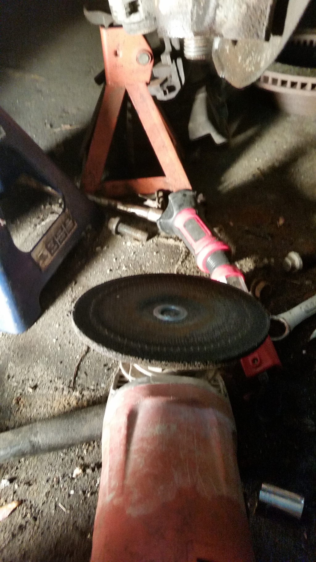

Alright, here's how hard I've beaten on this thing...

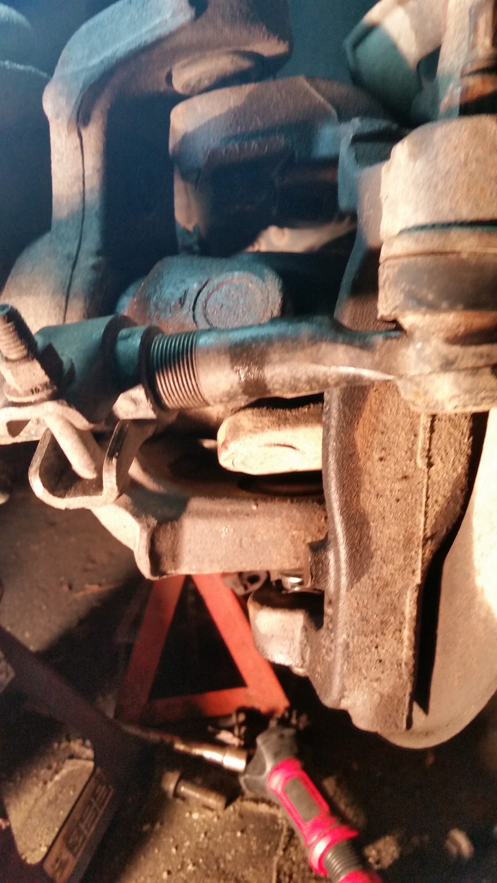

I removed the nuts from the upper and lower ball joints and dropped the knuckle to get more room. I'm lucky enough to have a Metabo, a high speed side grinder. However, it didn't have enough reach to cut through the lower joint. So I brought out my 9" grinder. Unfortunately, all I had was a grinding wheel, which is much thicker than a cutting wheel. Oh well....

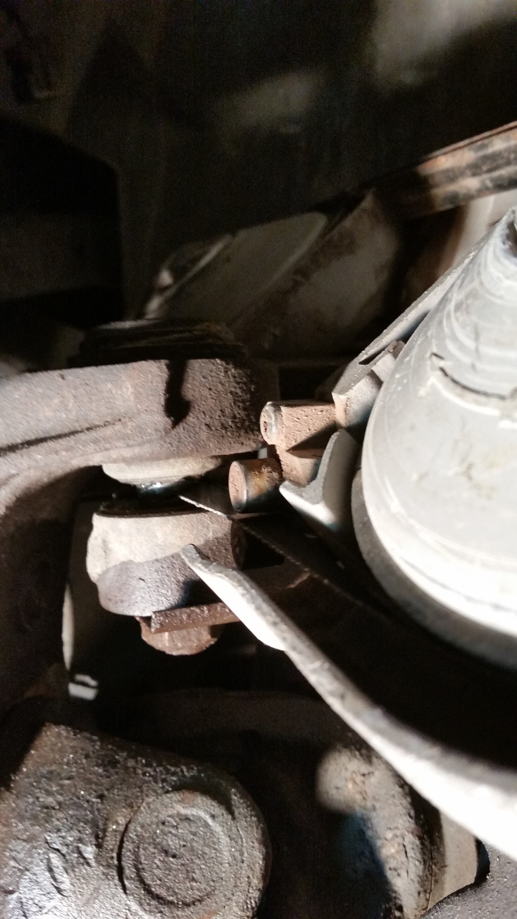

It's hard to see, but this is how far I got with my Metabo...
