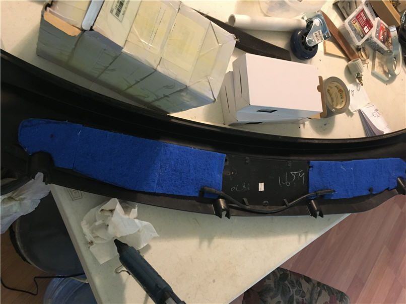

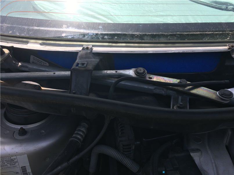

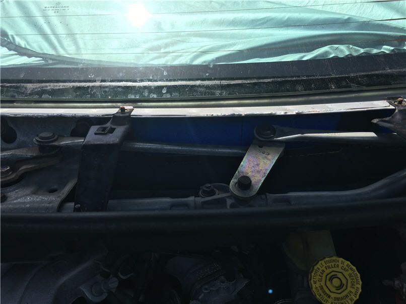

When you're done it should look like this:
Finally ....
You've still got 6 sponges left....
You're going to trim and hot glue those as single layer pads to the underside of the cowling like this:
**this final step keeps the driving rain DROPS from 'exploding' as the pass through the (factory designed) 'screen'... to be sucked into the plenum as water spray.
Your 'pads' are a much better design to prevent this 'explosion' of water into your assembly tray.
You're done.
Everything can breathe and your vehicle will stay dry and smell nice.
