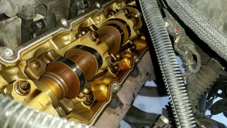

The 4.7 is an SOHC engine, meaning it has two camshafts, one on top of each head, that directly interacts with the rockers. There are no pushrods to bend.
Here's whats under the 4.7 valve covers
