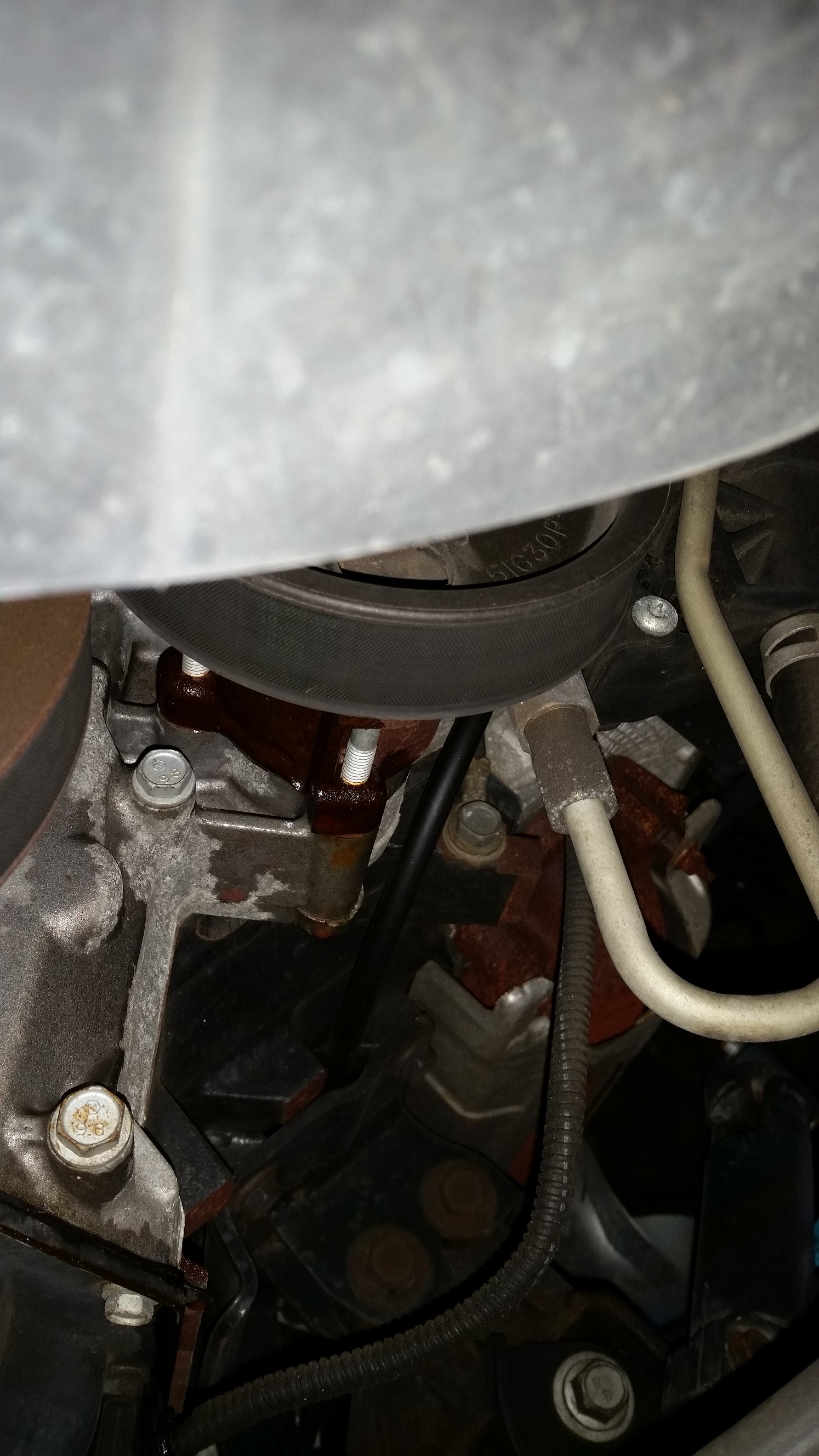

Just noticed an external coolant leak today. After looking around through the other threads, I'm thinking it could be the water pump, but cannot find the weeping hole on the pump so I'm not sure. Let me know what you guys think from the pictures. Its a 2005 5.7L Hemi, 87K

Water pump would be the most logical place to start.

Ok that's what I'm thinking too. Thanks

Your leak is most likely the water pump. I would suggest getting an OEM rather than an Auto Zone reman. They are a PITA to replace, and you don’t want to do it twice.
