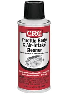

Originally Posted by MikeHTally
Yep, you have to keep the motor up so no cleaner gets in it. Also, non-chlorinated brake cleaner only.
Use this stuff:
Throttle bodies have special coatings that other cleaners can remove.

Originally Posted by Gary-L
Use this stuff:
NO!!!! Brake cleaner only! Dodge released a TSB on this years ago.
