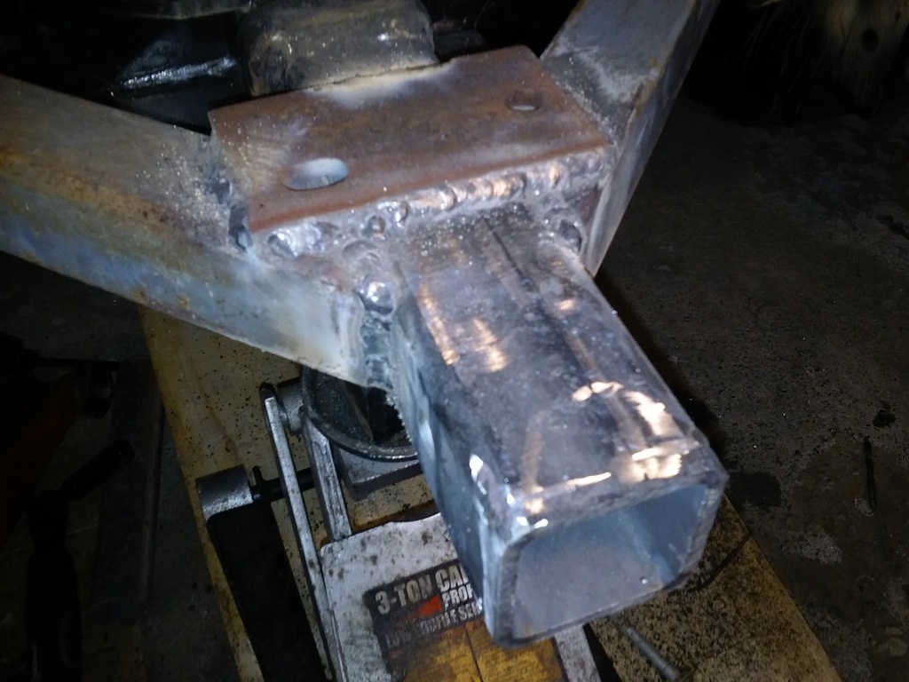

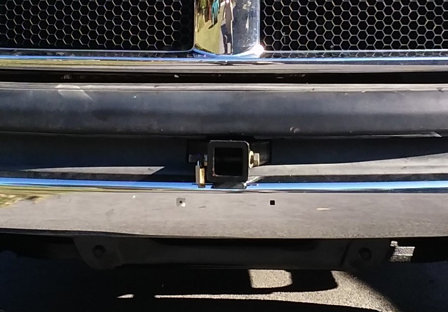

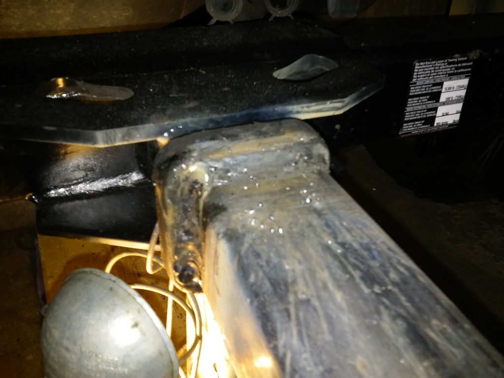

I started with a draw-tite service truck 16,000lb rear hitch (part no.41990-07). Cut the tube to 30.5 inches and welded the end plates on. To get it out in front of the bumper i welded a 14'' extension tube in front and (2) 45 degree supports.
