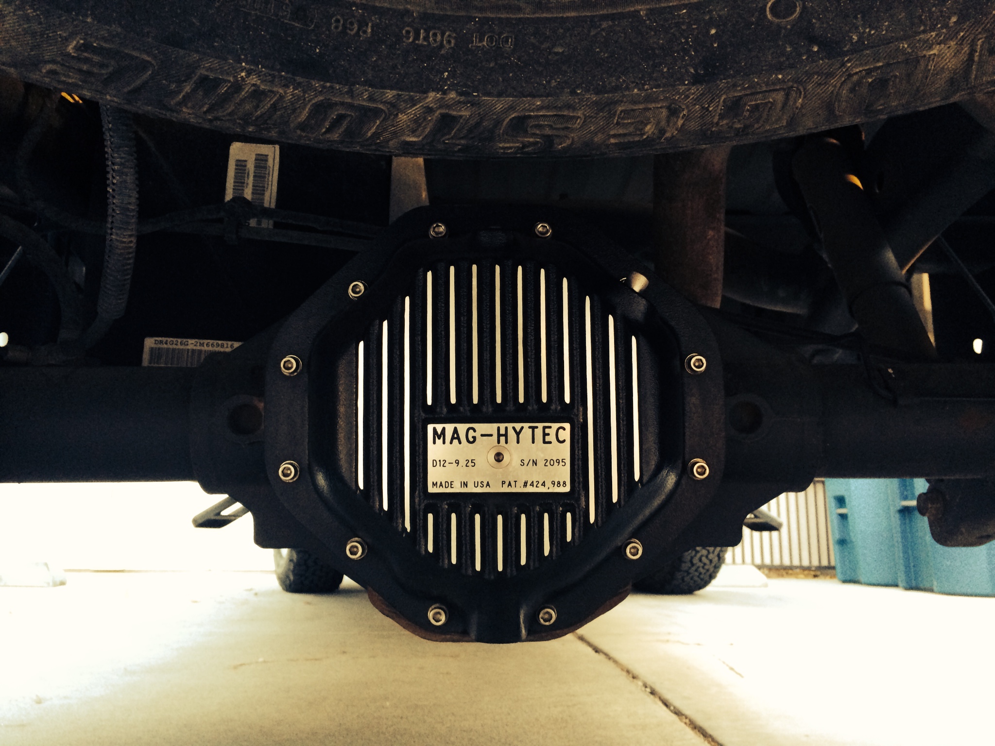

I changed the fluid every 2k with mobil 1 until it was clean (took 3 changes) and then went with the Amsoil. Also put a mag hytec cover on so I can keep an eye on it with the magnet. It holds a little bit more fluid; maybe 1/2 qt.
Hope this is of some help to you!
