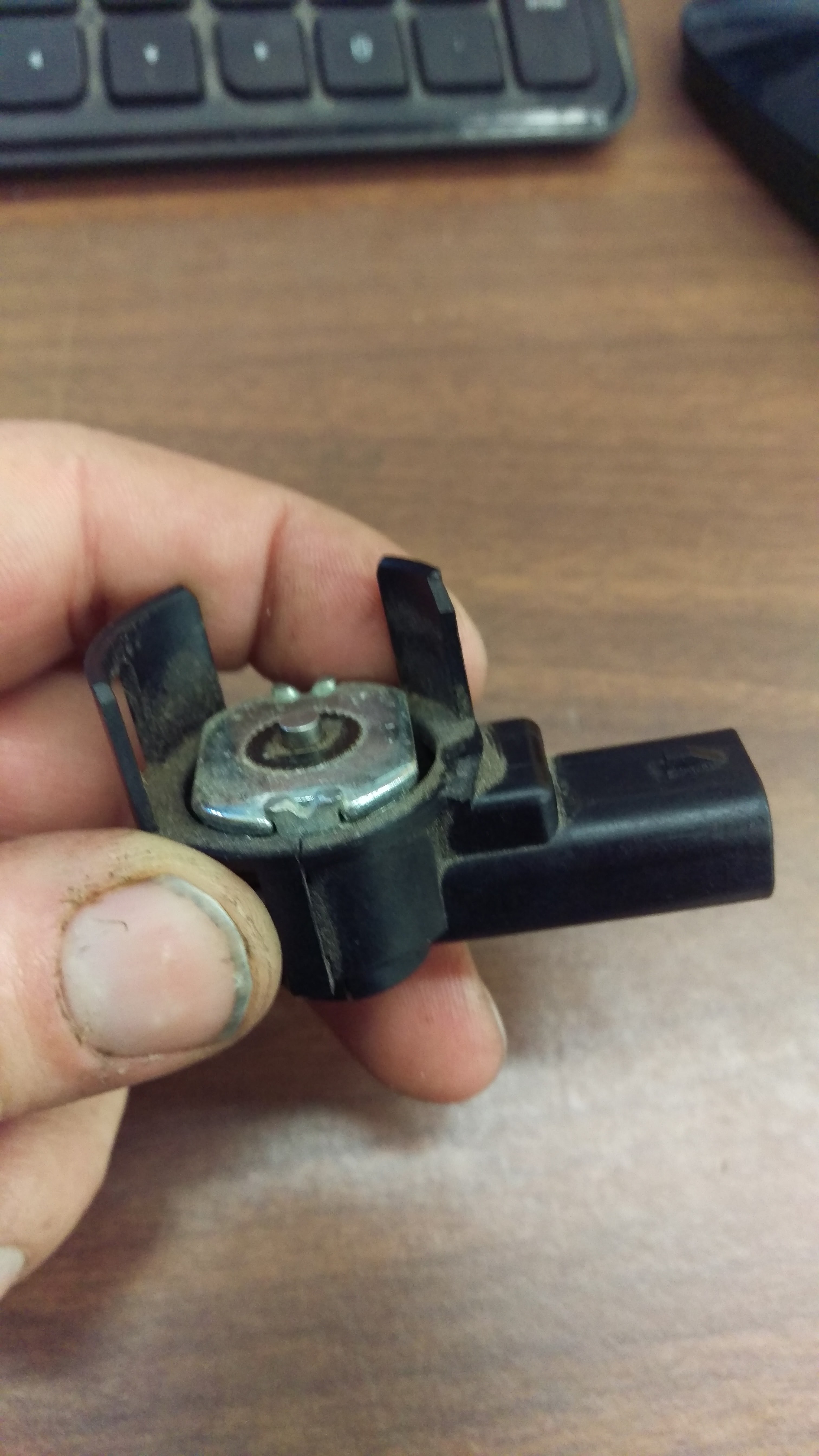

Found this dangling by drivers gas pedal.
It gets hot.
Unplugged it truck still runs OK:-)
Anyone know wtf this is?

Being the part gets warm/hot means its magnetic usually... just reach under with it as see what the parameter is that it will reach...bound to see where it came off at...

That almost looks like it might be a magnetic lock pin

Can you shift out of park without pressing the brake?

It is the BTSI connector. It's what prevents you from shifting into gear without stepping on the brake.
