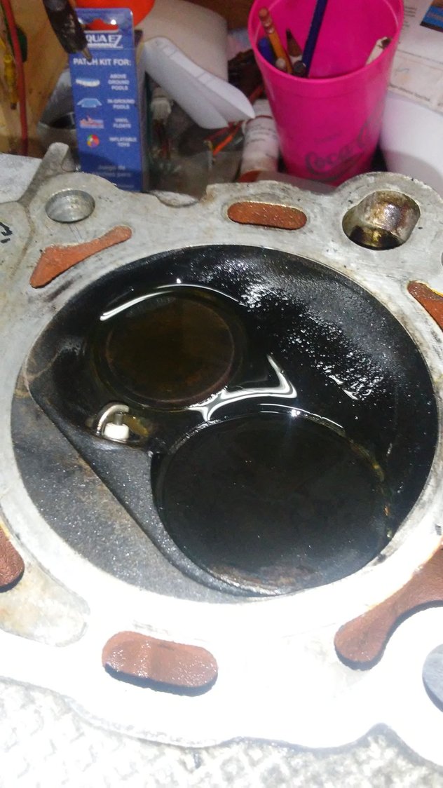

Intake valve either needs replaced or relaped. Ill keep you guys updated on the progress The combustion chamber was filled and within a minute it was like this
