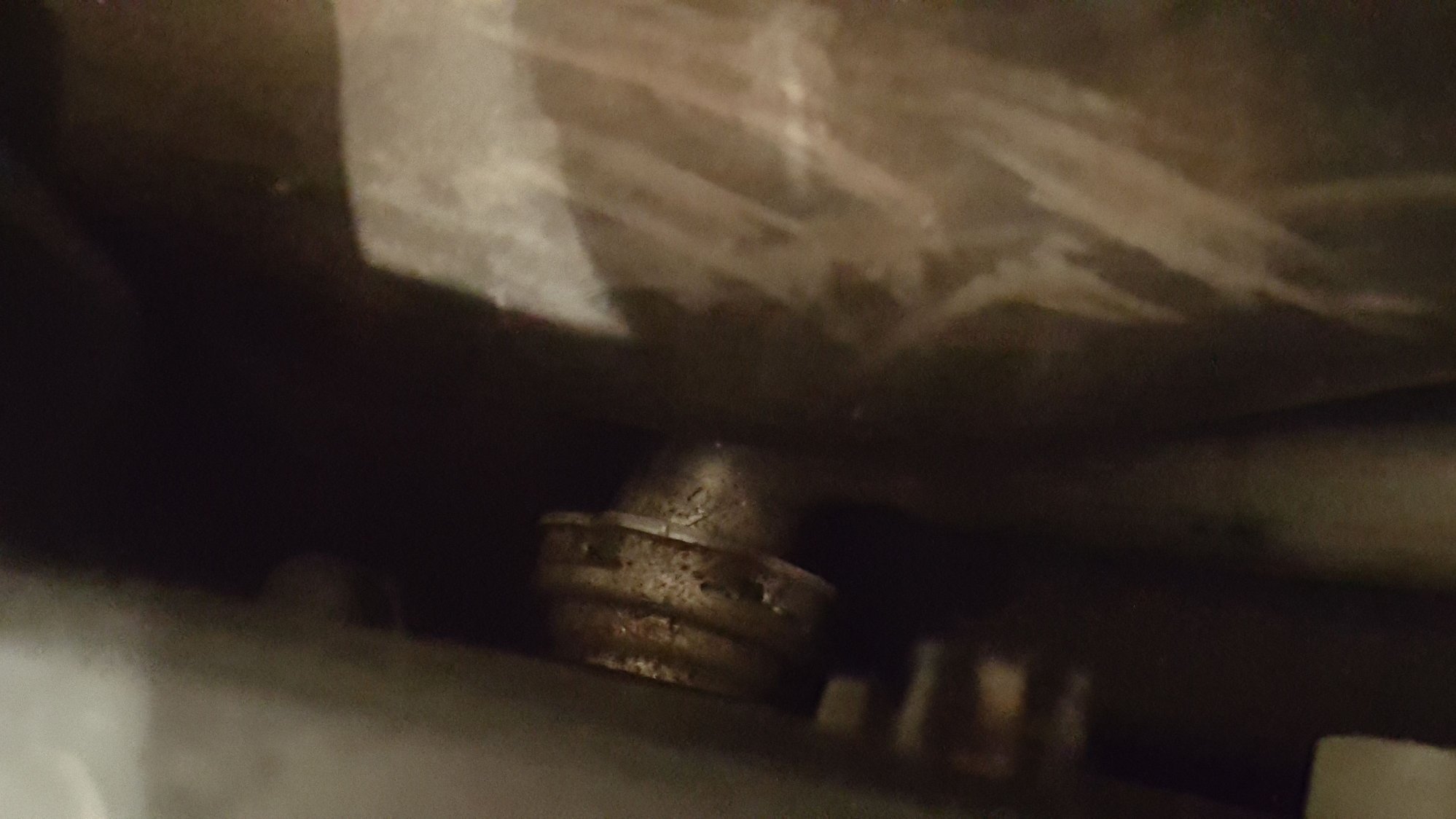

Default Output seal can't handle the pressure from the pump
Learning experience
so despite not having a new core yet I decided to just get a look and feel for the work and find the problem. This is the output of the heater core. Turns out it can't handle the pressure from the pump no more, the core itself works just fine. Spent last night and this afternoon pulling the dash out to see this, but now I'm confident in myself doing this job when I get the new core, I won't have any problems doing this again. I imagine all the time this wasn't hooked up maybe the seal internally rotted away. next time I'll have to make sure I have the proper equipment to discharge the freon to take this box completely out, didn't do that this time. There is a way to open it without doing that but it is destructive to the box itself and I don't want to do that.
