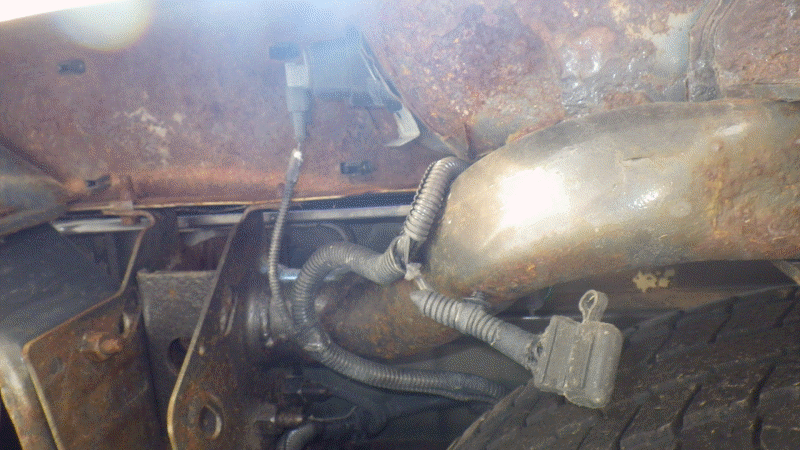

Mine has the 7 way receptacle through the bumper and the 4-way behind the bumper...........

Looks factory, or at least it matches what my truck looks like.
