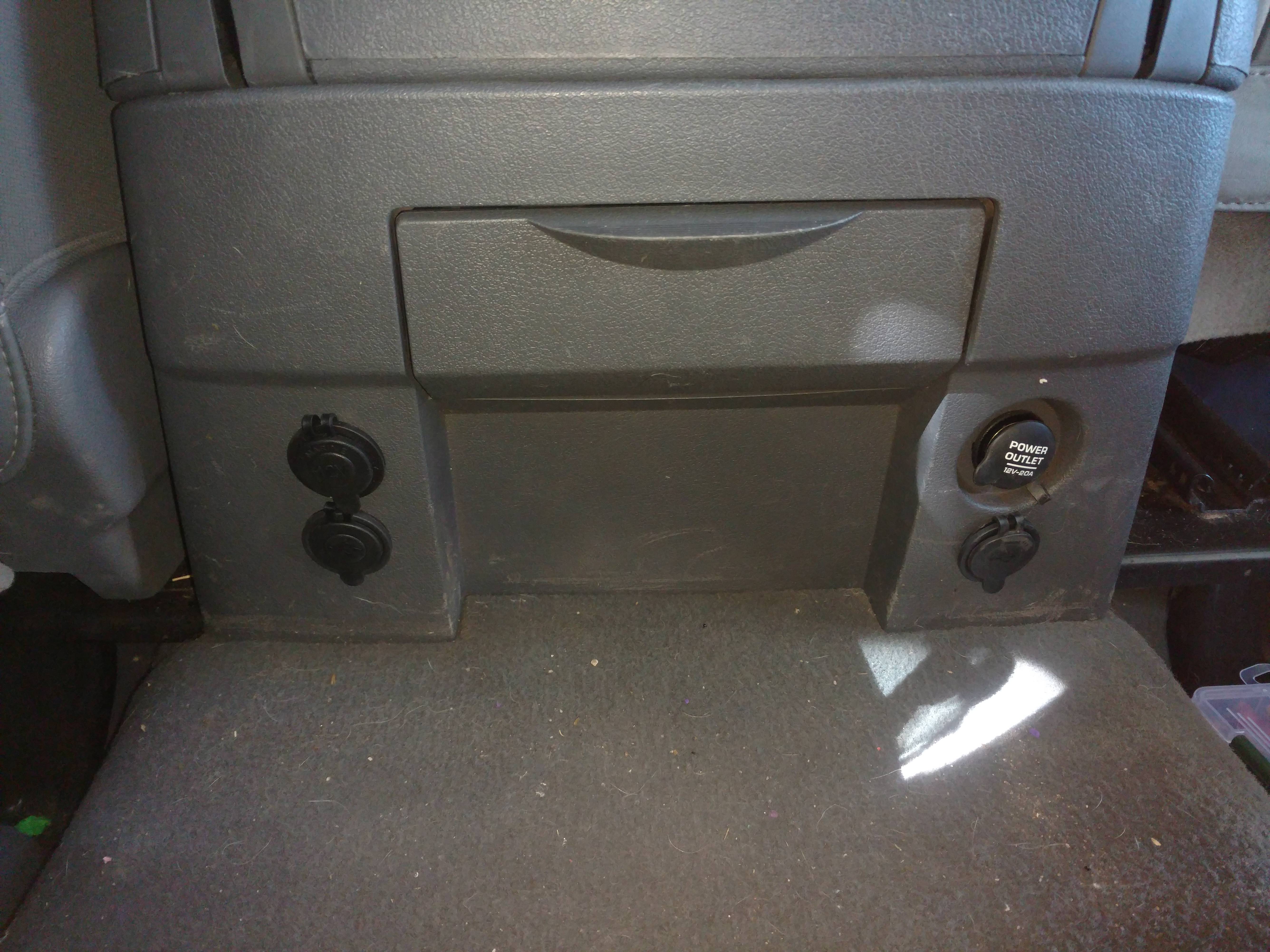

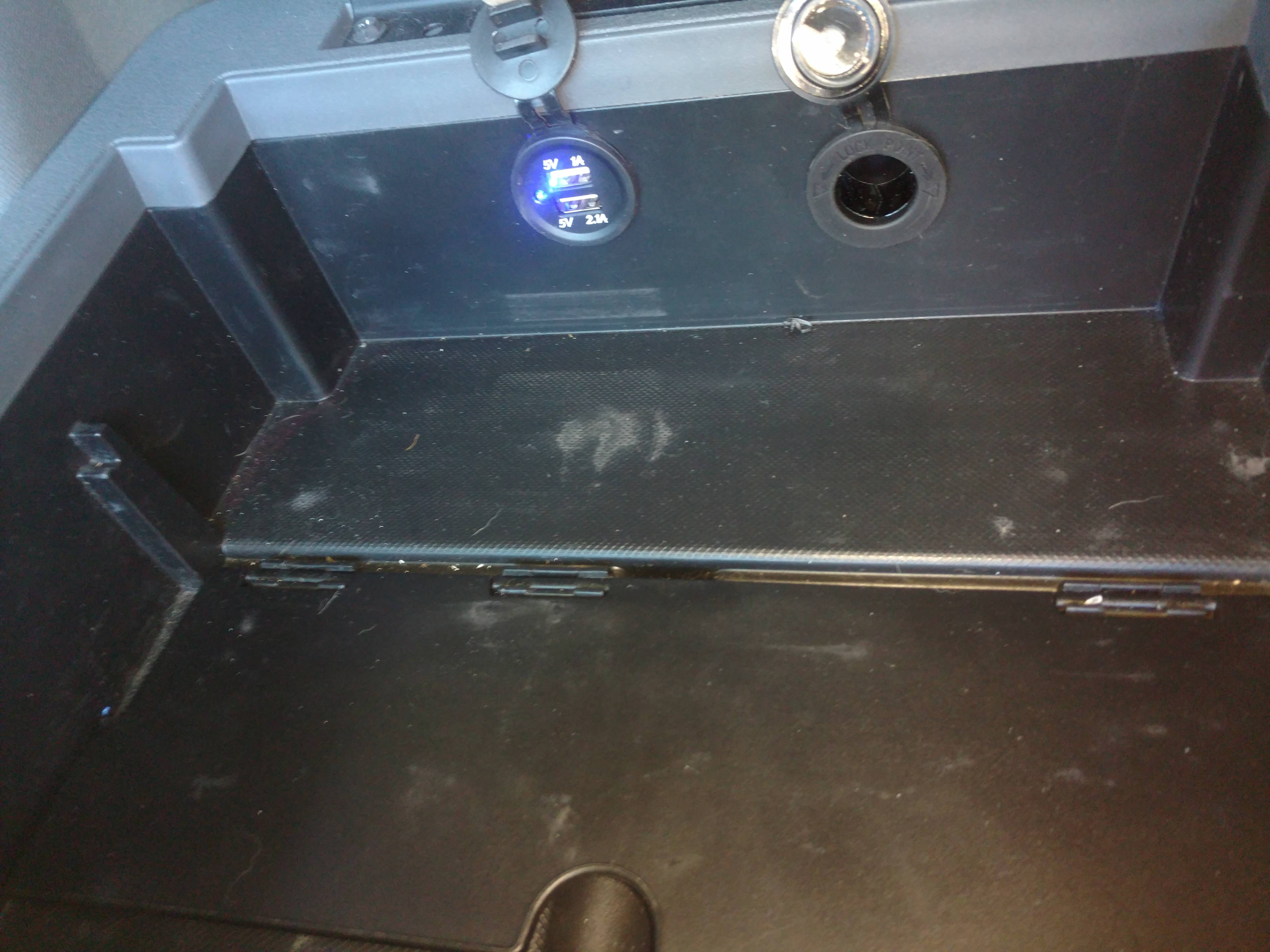

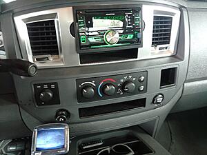

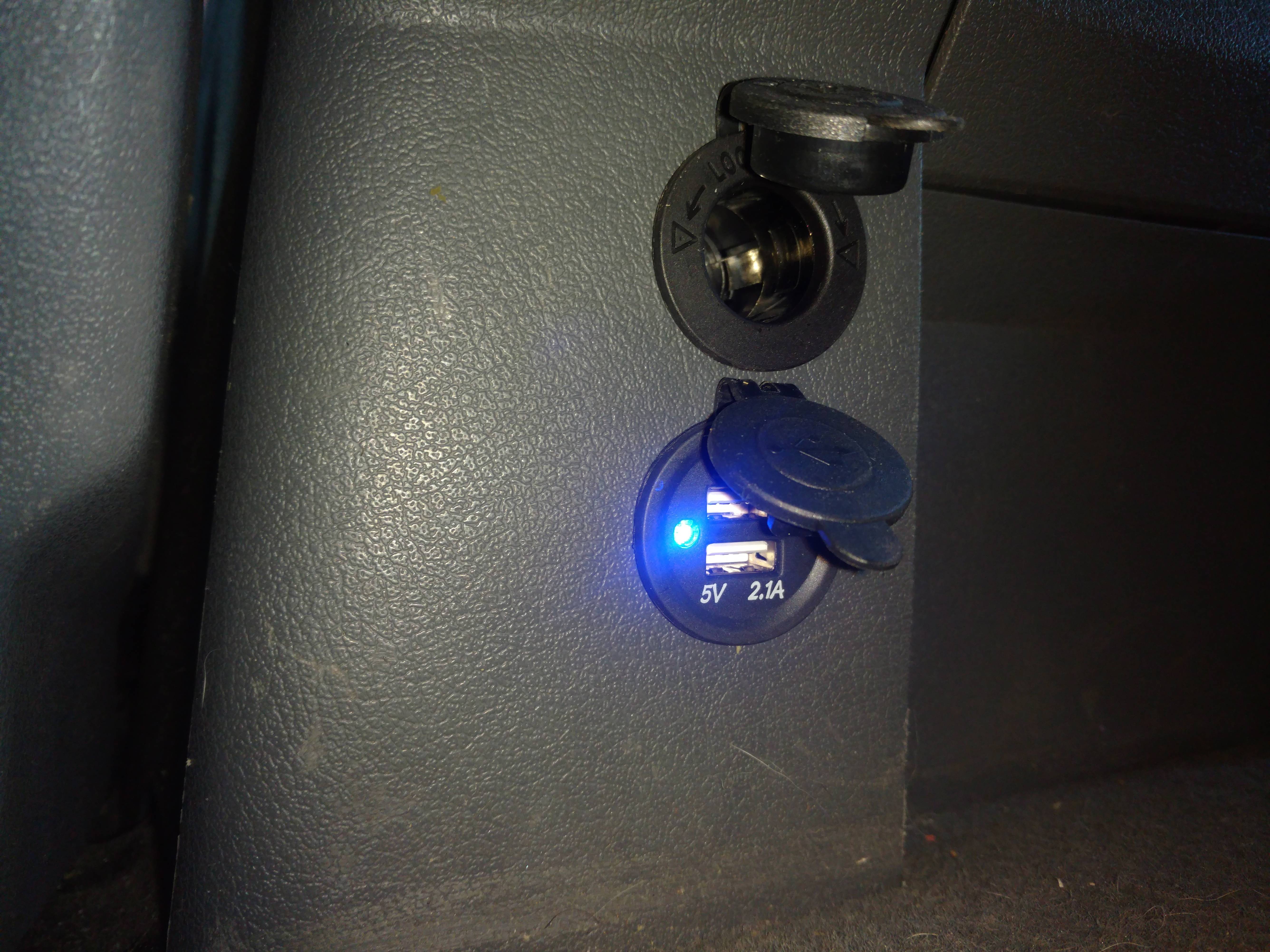

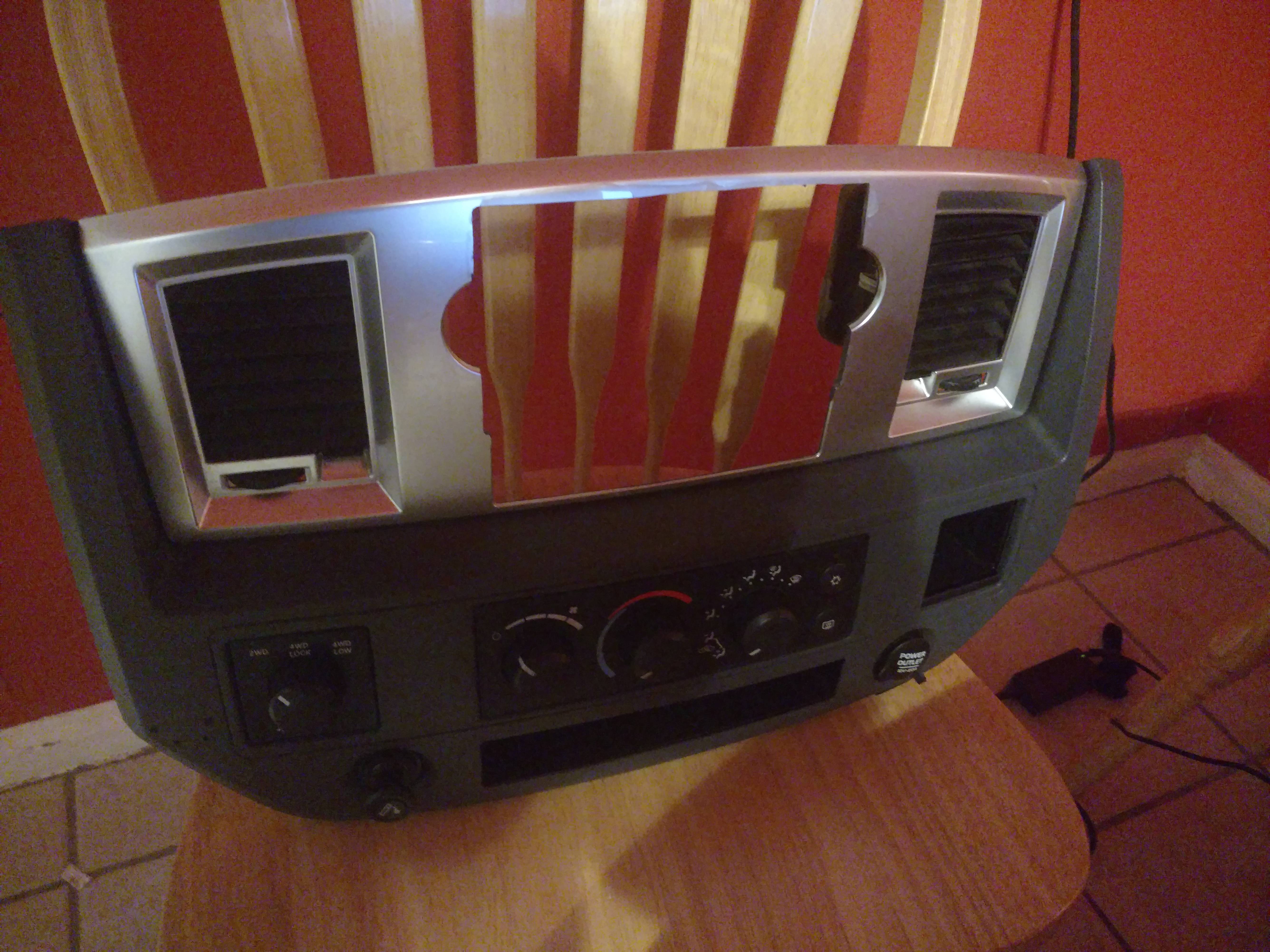

I installed a Kenwood USB Bluetooth Double DIN radio in my 2007 Ram. I'll post up a few pictures of the modifications. Also, I bought several USB chargers and 12v outlets. I placed them inside the center console and the on the back side for the rear seats. When you have kids, they all have a phone or tablet that needs to be charged up.
I also installed a license plate rearview camera, the monitor is seen in below. I bought an extra camera for the back of my travel trailer when I'm towing.
Double DIN radio install and USB/12v outlets-8jfqp5a.jpg

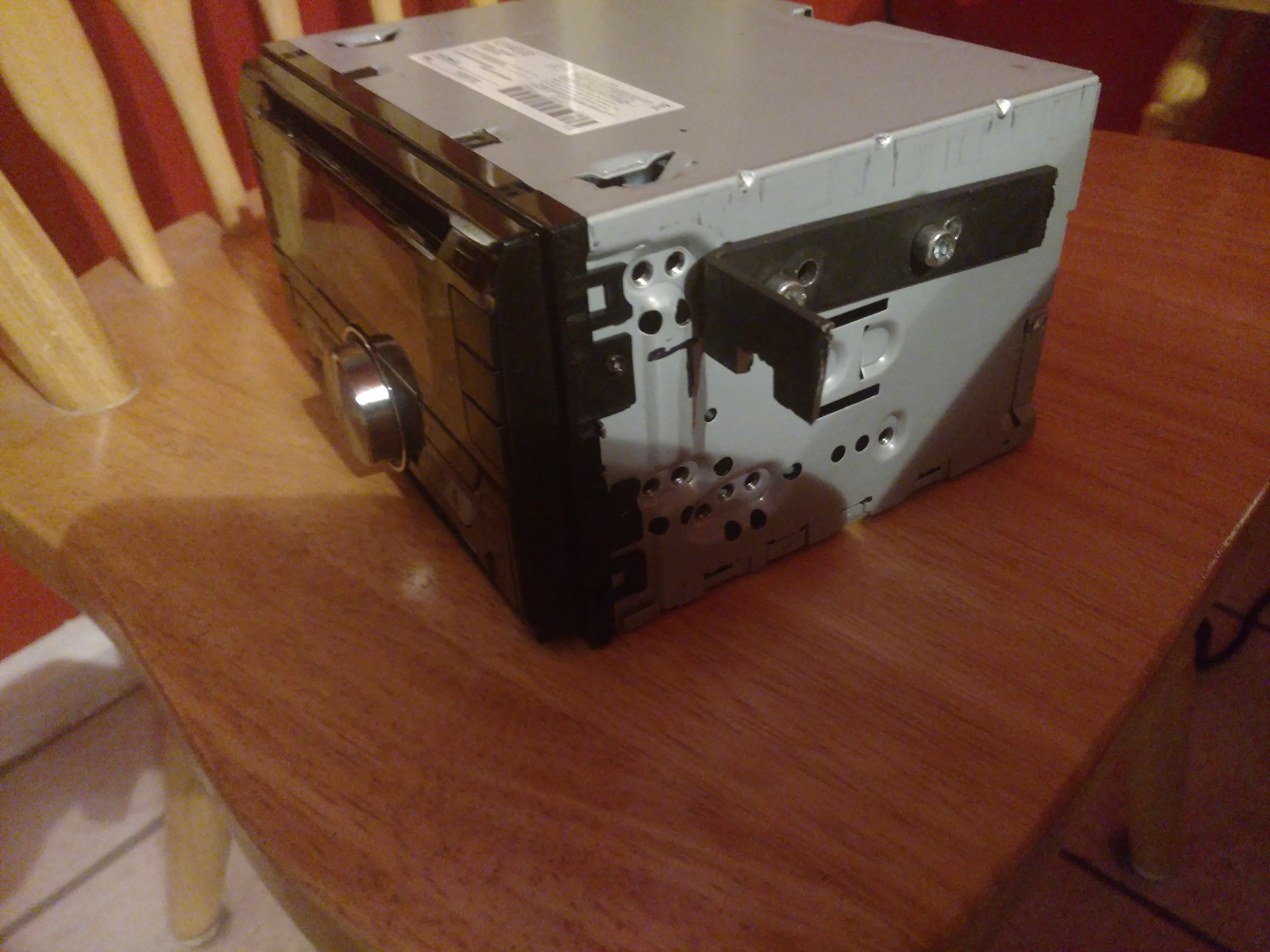

On the radio, I had to make some brackets on both sides to bolt on the radio up.
Double DIN radio install and USB/12v outlets-8tgahrr.jpg
I cut down the trim piece below the radio and filed down the upper edge

I bought these dual USB and 12v power outlets from Ebay for $8 for a set.
Double DIN radio install and USB/12v outlets-hqviszv.jpg
Double DIN radio install and USB/12v outlets-qalnuh1.jpg
Double DIN radio install and USB/12v outlets-jxc27fy.jpg
Double DIN radio install and USB/12v outlets-ppdf8in.jpg

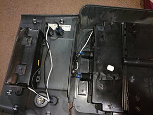

Here is the underside of the panels
Double DIN radio install and USB/12v outlets-q7w9ec2.jpg

They are super easy to wire up. Just normal crimp spade connectors.
