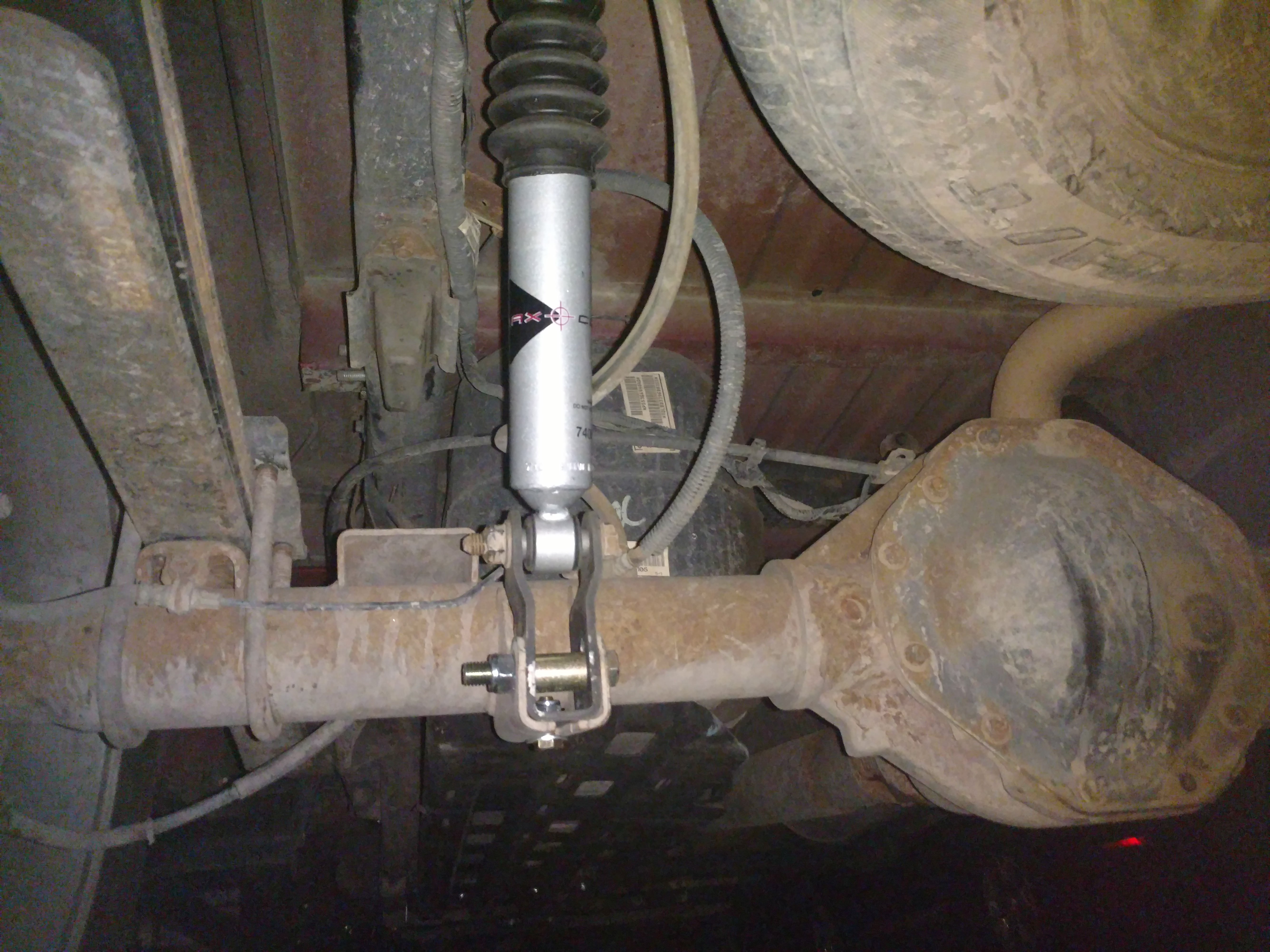

Once installed I noticed the rear shocks were not fully extending as much as when the suspension is fully extended, so I ordered these Ram 2500 shock extensions, they only needed the factory shock hole drilled in a lower position than the provided hole.
https://www.ebay.com/itm/Rear-Shock-...NaU~8C&vxp=mtr
For shocks, I went with Gabrel MaxControl Shocks.

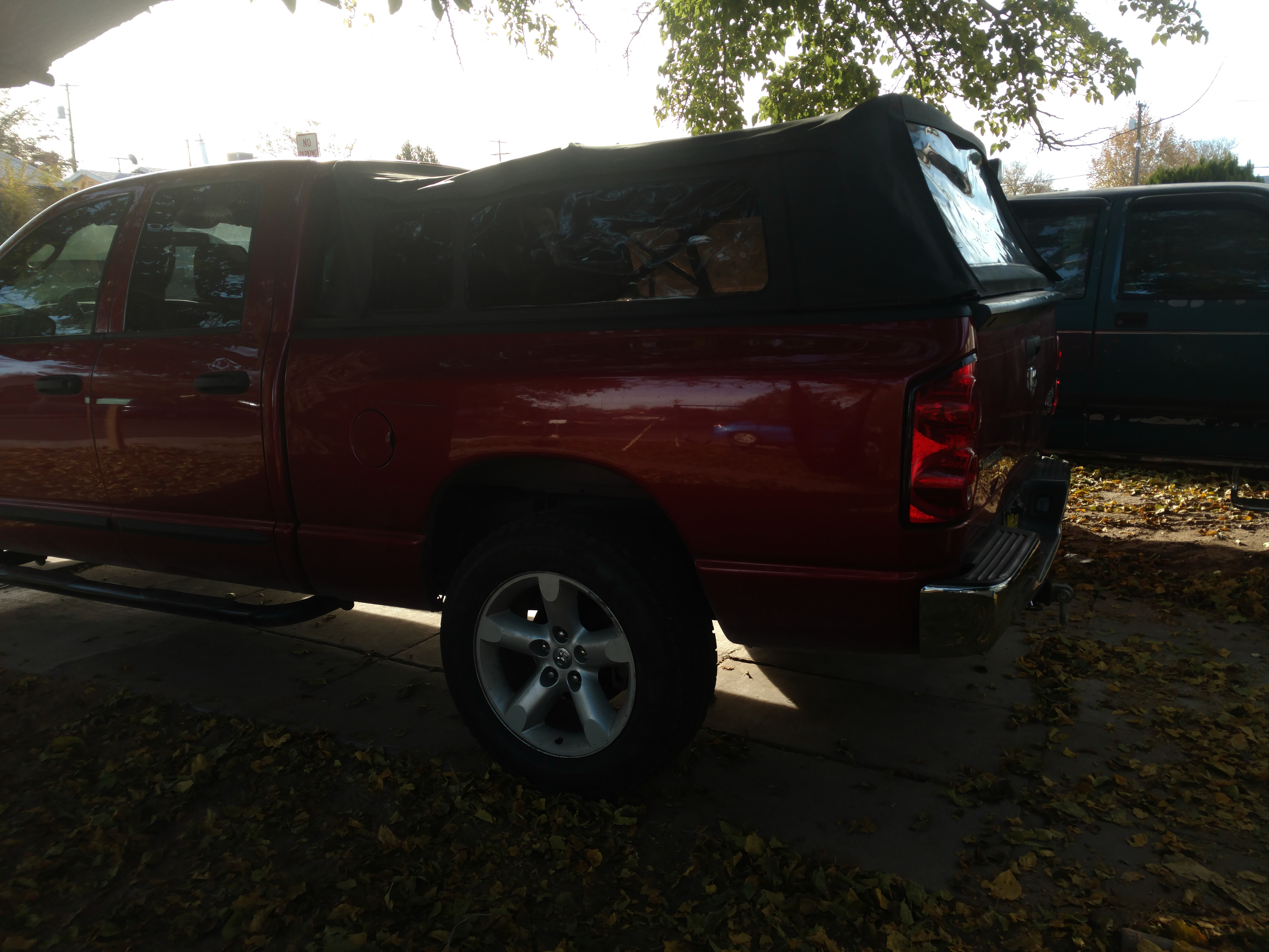

For camping, I found a soft top camper shell from Bestop. I love the easy setup and disassibablity. Aluminum and fiberglass shells are heavy and you have to have somewhere to store them when not in use.
