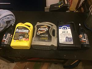

Here is the most recent fluid line up poured into my Ram. Front to back.
