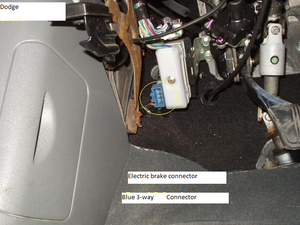

No OEM controller prior to 09. There is a plug with length of harness you can get that does plug in under the dash that you can connect to a controller.
