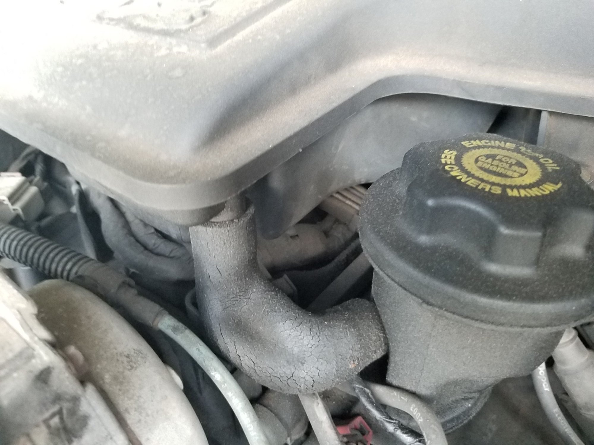

I'm going to learn my way around this engine, but this may be an easy way to start. This hose is pretty destroyed and I want to go ahead and replace it. What is this called?

Breather hose of some sort.

Mopar Crankcase Vent Hose 2003-2004 Dodge Ram 1500 5.7L #53032786AB

Thank you, chasing an Evap leak code around the truck. Could this attribute?
Nope, internal engine ventilation only. might want to post up the evap code (problem) too.
