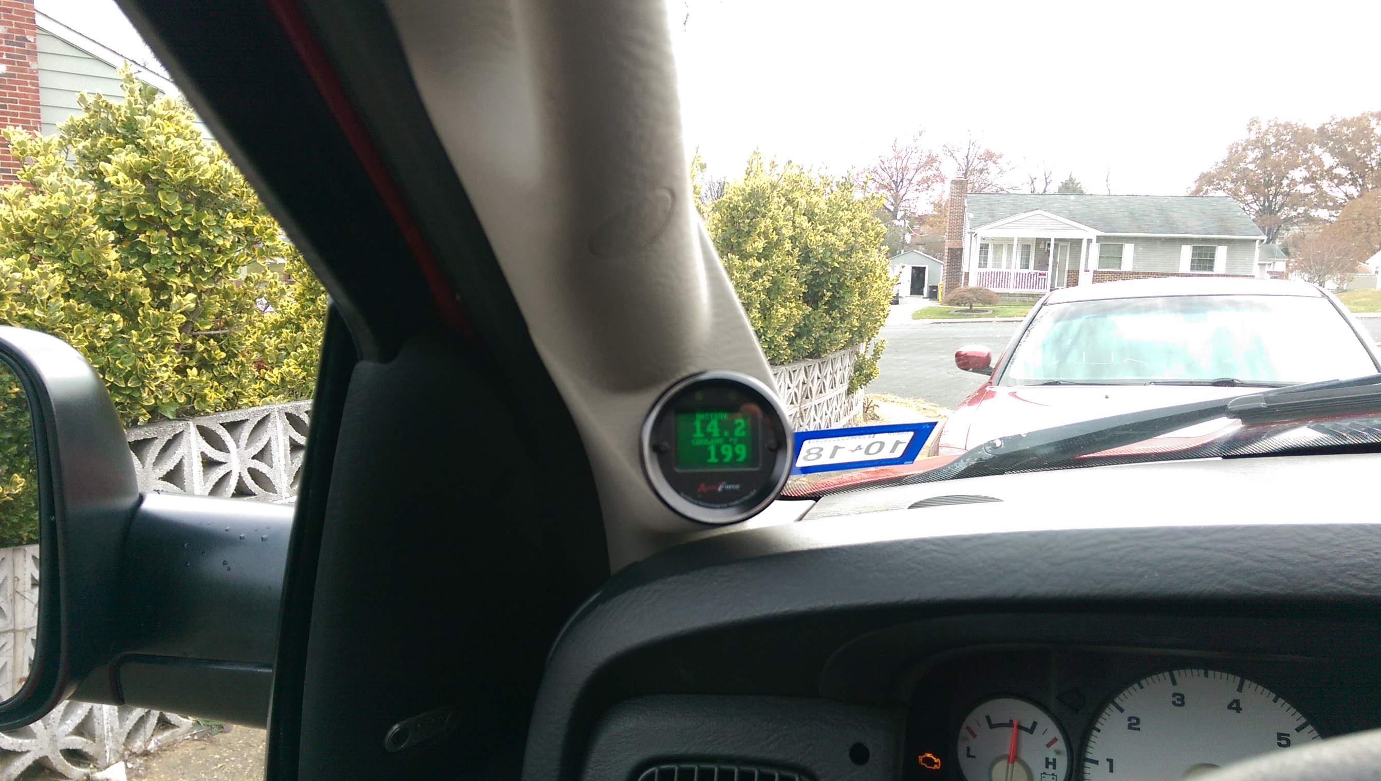

Plenty of ways, I am partial to this one:
