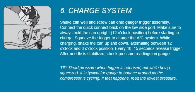

Don't turn the bottle upside down. You always want the valve at the top. It can be at an angle, but not upside down. You want gas, not liquid going into the system. Upside down you risk a slug of liquid cavitating. If you're in a hurry, put the bottom of the bottle in how water. I've only seena slug of liquid crack a fitting once, but it can happen.
Sorry should have been more descriptive in my reply.....
