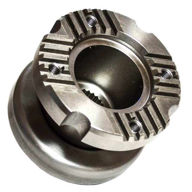

I would check cv axle and make sure its secure an in proper place,,I had a 2007 2500 4x4 once that that front Pinion Flange go out and brought truck to a complete stop ,,unsure about yours having this but it will grind ,,perhaps check oil level in front an rear differentials , make sure there not low as this led to the flange failure
e Pinion Flange
I'm pretty sure my '04 1500 is almost a completely different animal underneath than a 2500. My in-laws have an '06 2500 4x4 and they have a straight axle under theirs.
