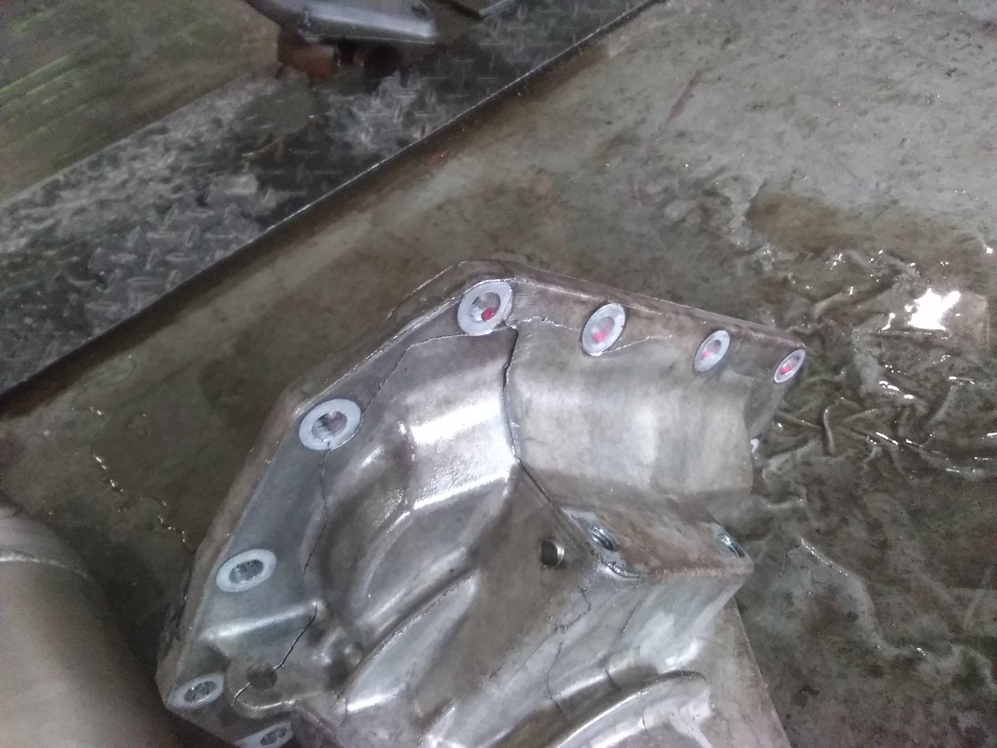

I have an 03 quad cab 1500 2 wheel drive.My Ram is Superchip tuned MSD ignition wires, K&N black tube cold air intake, the rear end has been changed to the 04 SRT10 with 4:10 gears. I've had to have a custom driveshaft built and now Im having problems with tail housings on the transmission. First tail housing cracked on a long trip. The shop that swapped my rear end replaced the tail housing and assured me that they were no problems with u joints or drive shaft. 5 months later on another long trip tail shaft housing completely blew up. Had to have the truck towed back to the shop purchased another tail housing, and being told by the shop that the tail housing is building up too much pressure causing the housing to crack or blow up. So they're adding a vintage yoke to the housing to relieve the pressure, I don't think that this is the case. I believe that there must be some type other lineman tissue with the rear end and the driveshaft going into the transmission. Does anyone have any advice on what could be going on?
This is the first tail that cracked at the face bolting to the transmission.

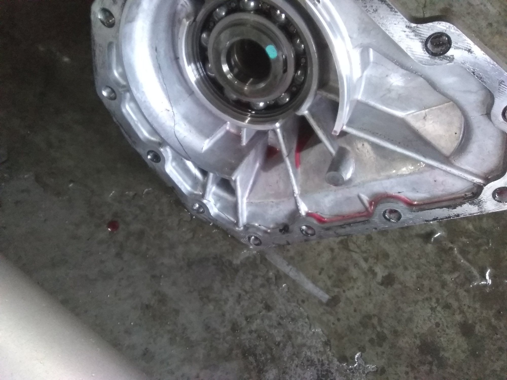

Inside you can see the crack
Outside crack

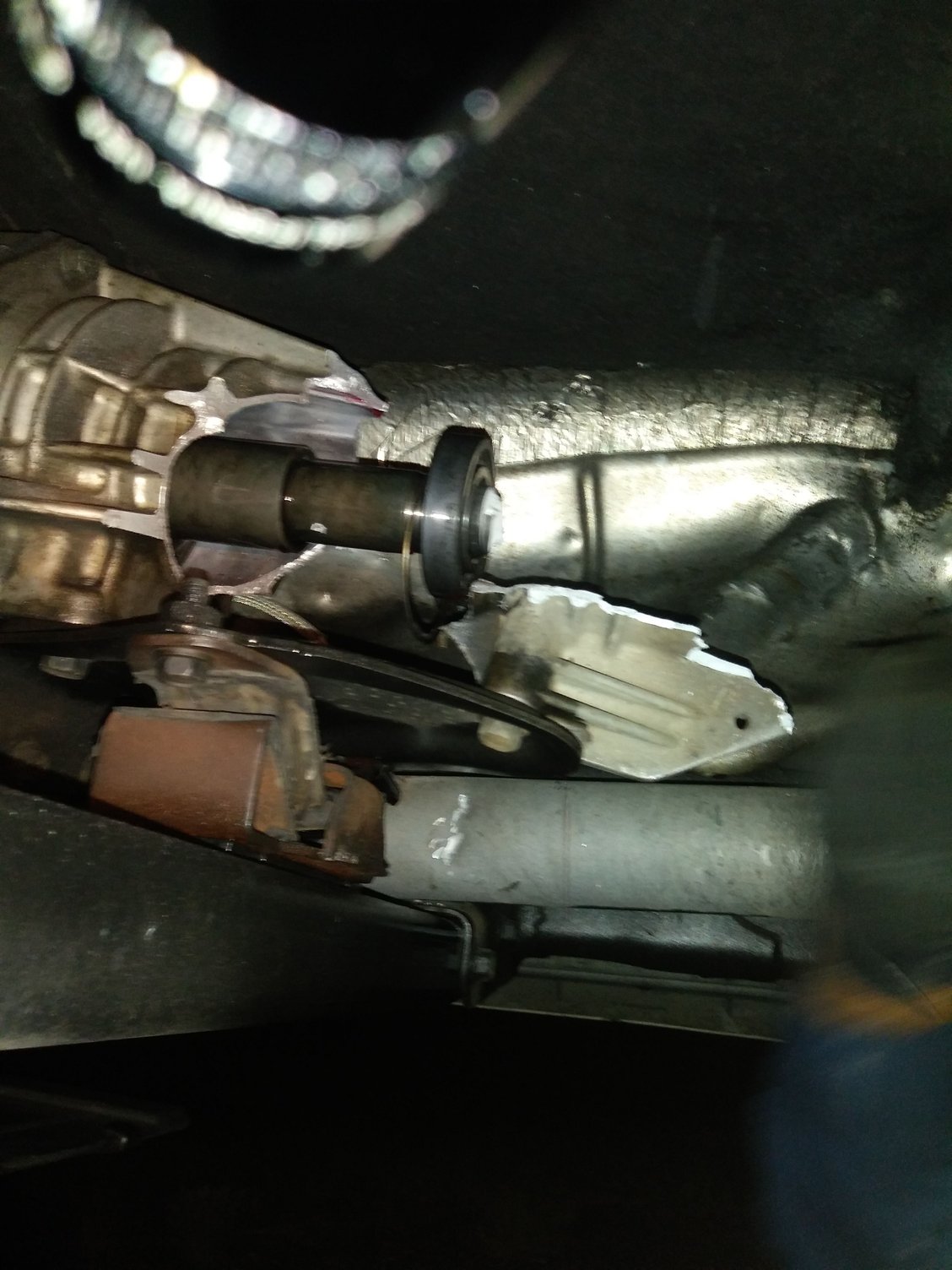

2nd tail housing complete blow up.

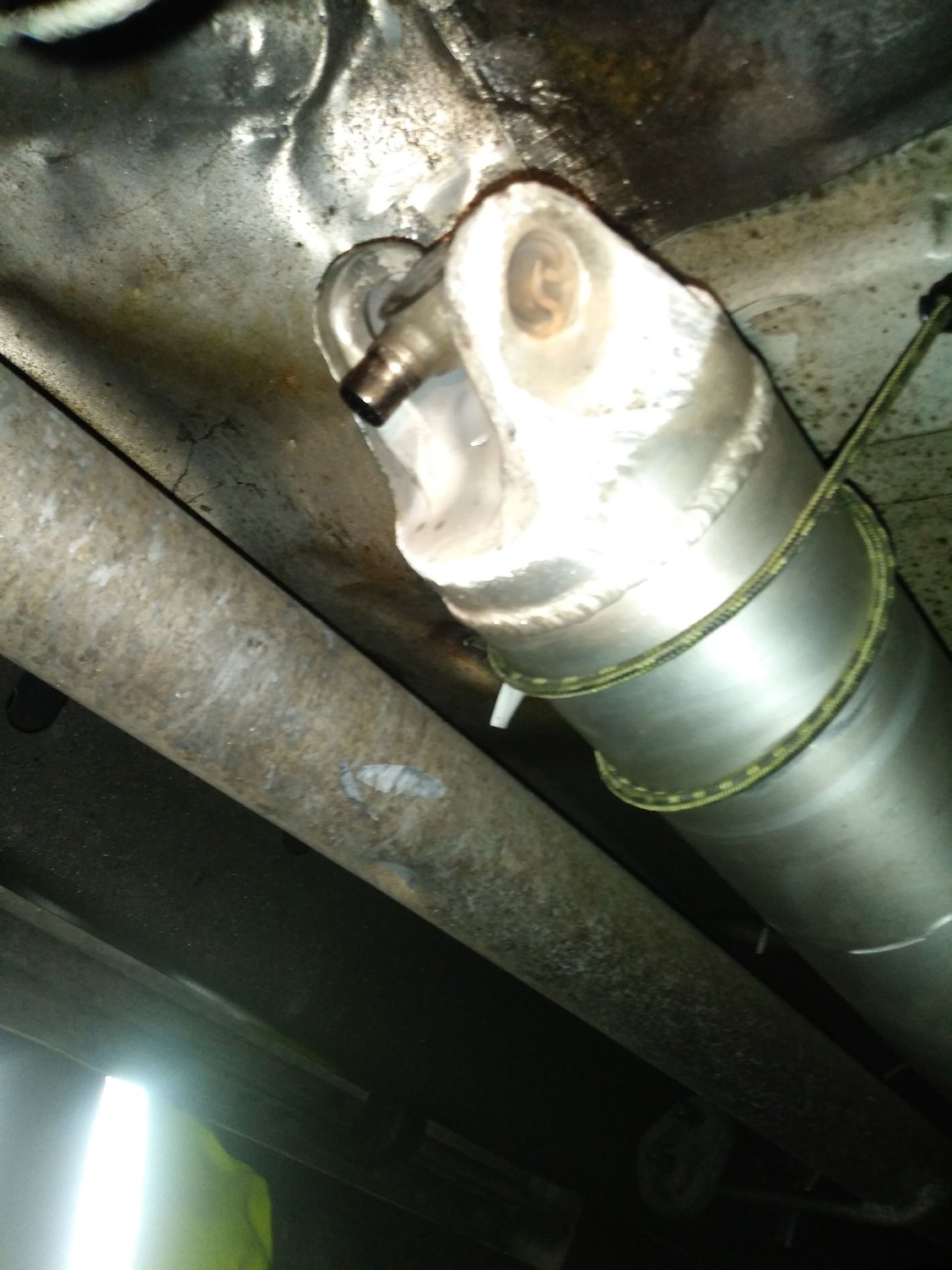

Custom driveshaft after the aftermath.

If you beat the snot out of the truck every time you drove it, I could almost see that kind of thing happening.... almost.... Are you getting any driveline vibration? Is the driveshaft too long, and it's pounding into the tailshaft, or housing? Are the driveline angles acceptable? Or maybe the shaft isn't long enough.... and putting undo stress on the housing??

Im agreeing with HeyYou regarding drive shaft lengths and angles. Im thinking we need more info. Guessing a custom drive shaft was required to work properly with the SRT differential? When first explosion occurred was the output shaft of trans replaced? Looks like that 2nd to last pic shows output shaft sheared off ? If so, is it possible output shaft was cracked on first explosion and it was missed when installing 2nd tail section ?

The slip yoke goes onto the output shaft of the transmission.
The ouput shaft on yours looks broken behind the bearing as seen in your pic.

How did the bushing the slip yoke rides in look after the housing blew itself to bits? Was it scored? Galled? Overheated? How much space between the rearmost u-joint, and the yoke on the differential, when the slip yoke is stuffed all the way into the trans? How does the slip yoke itself look? Is it turning blue anywhere???
I still think the driveshaft is too long, and on bumps is pounding itself into the tailshaft of the trans......
