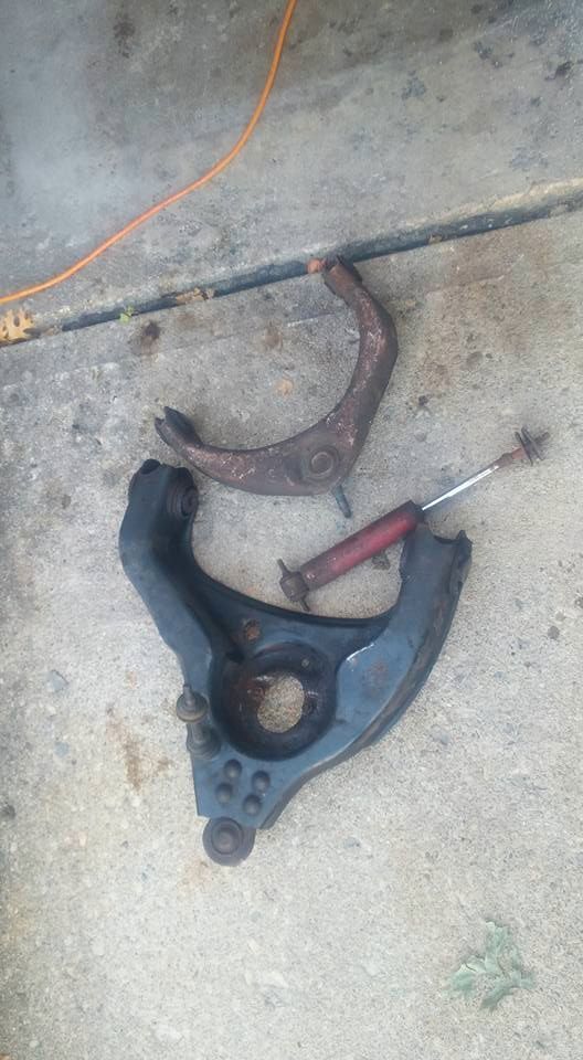

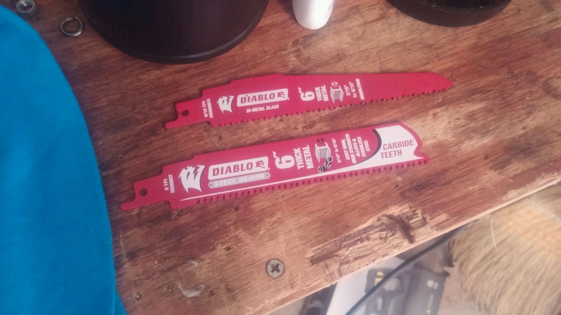

with 195,000 miles on her, I'm replacing the upper and lower control arms, shocks, and sway bar end links and sway bar bushings. it's a 2007 2WD 4.7 SLT and I did my driver side last weekend. Both lower shock bolts broke off in in the A-Arm and then 1 of the A-Arm cam bolts was seized in the bushing so I cut it out with a Diablo carbide tip sawzall blade.

Cutting fronts shocks off is standard practice. You have to use a recip saw like you did because a cutting wheel won't fit.
Greaseable upper ball joints looking good!
