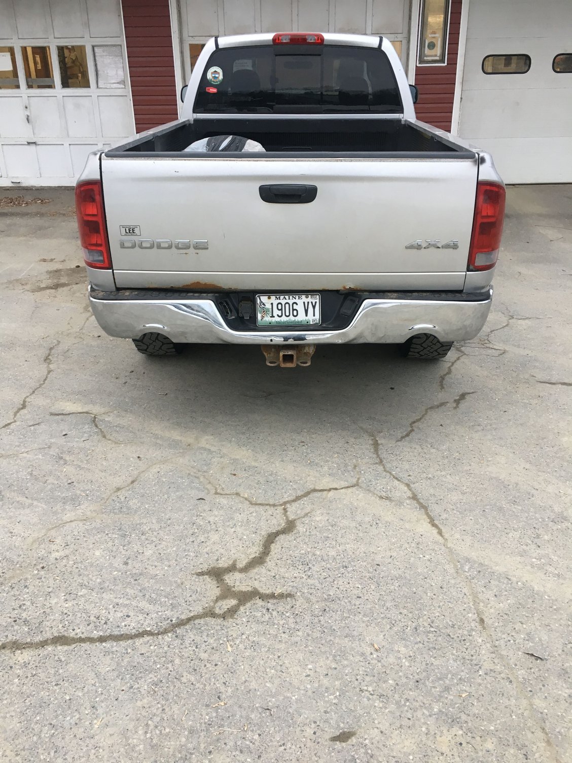

so first question. I acquired a brand new rear bumper for free through my job...I run an automotive shop....but the bumper is from an 06. I already know I’ll have to switch brackets from old bumper but will it fit? The wrap around on the corners is a bit extreme it looks like but otherwise aside from brackets it looks the same. How much modding would I need to do to make fit...I have not tried anything yet so I can’t tell you what I’ve done so far.
