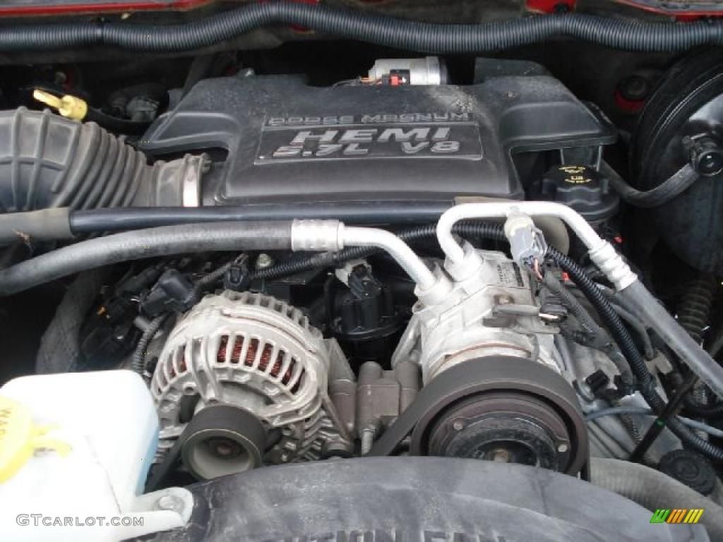

Let my try pictures...this is your current engine:
And this is what you're trying to use:
Like I said, you can't mix and match computer components. You can mix and match some physical components, but depending on which ones you will have to change some things. I can't explain it any simpler than that short of actually doing it FOR you (and that isn't going to happen). Again, I don't recommend you tackle this yourself as you don't seem have a fundamental understanding of engines, much less the differences between these two.
