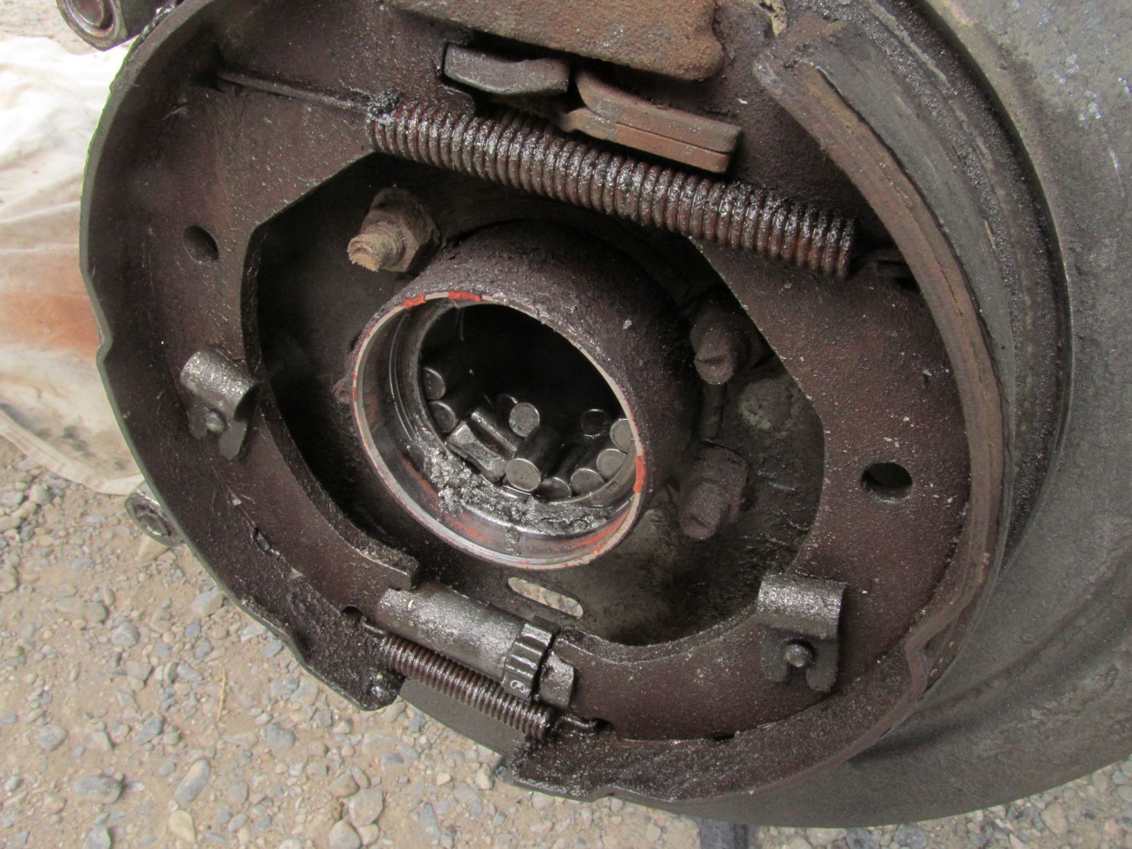

Got the cover off and pulled the bolt holding the cross pin to drop the axle. Couldn't figure out why the pin was so hard to remove, usually they kinda fall out. I rotated the differential and got the pin free. BIG mistake number 3. I had rotated the carrier and let the spider gears out trying to free the pin. On an open diff, no problem, but the 4x4 OffRoad has a limited slip diff. The pin was free, but the C-clip was jammed.....couldn't push the axle in far enough. The clutches were pushing the side gear in against the clip. Nothing about this in the cheese d**k Haynes manual I carry around. My HUGE mistake number 4, poor judgement based on lack of accurate/credible information. Just as bad, big mistake number 5, I had only 1 jackstand. I took it to hold up the front of my car hauler after I bent the jack off road in Texas, another summer fixit project. Since I blocked only one side of the rear end up, to pull the axle, there was enough side load from the left wheel to push the axle tight against the cross pin, making it hard to remove. Now I'm thinking I'm truly f***ed. I can't get the axle to load back against the clutch pack, even with a pry bar, gonna have to pull the carrier and rig up a press to collapse the clutches and let the cross pin/spider gears back in. Do NOT let the spider gears out, they hold the side gears in place.

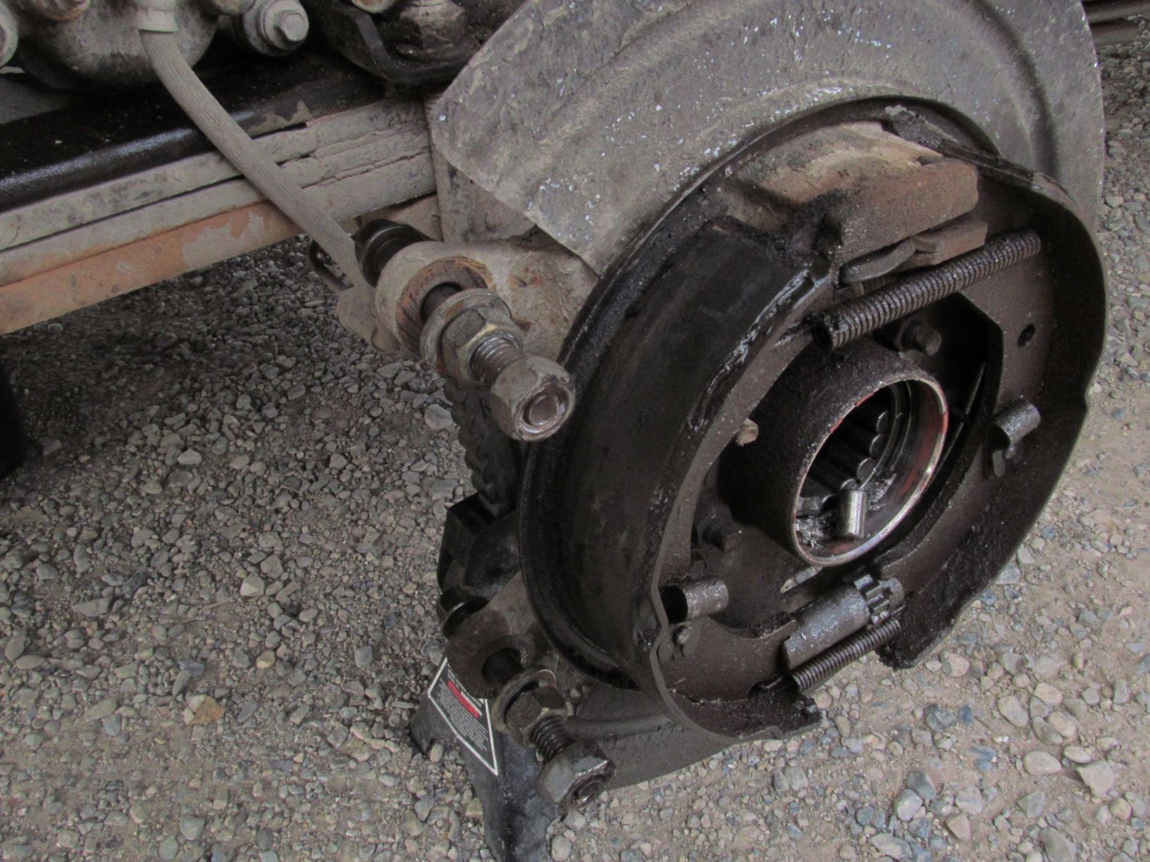

Worse, after the usual struggle to get a rust frozen rear rotor off, I can't get the axle free. Bearing has got to be trashed and binding up the axle, no other possibility.

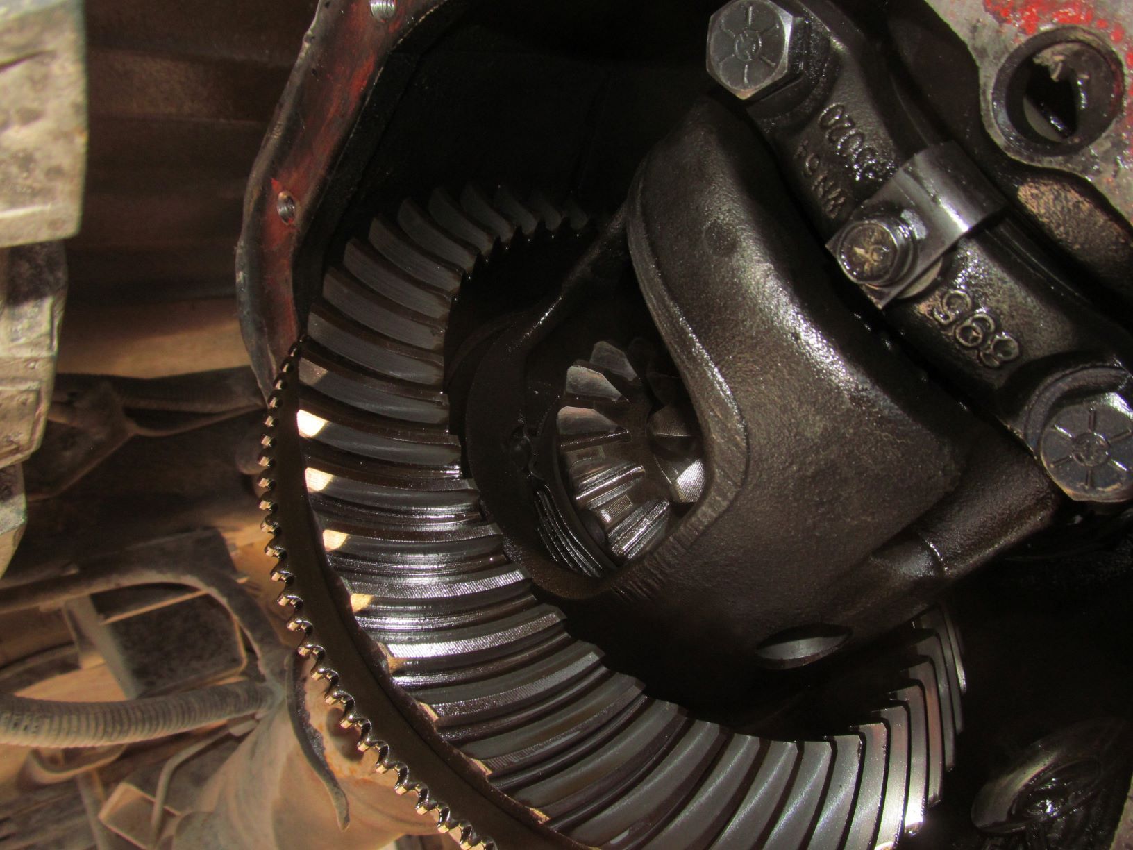

Big carrier is the LimitedSlip, can see the side gear collapsed in after I got the axle out
Left side clutch pack pinning the C clip in.

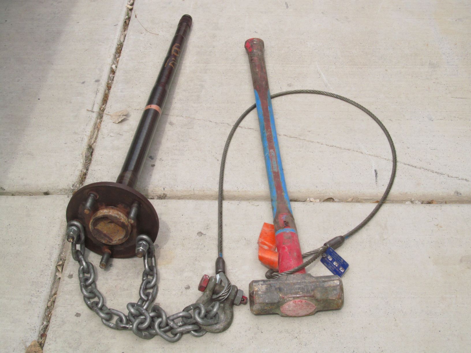

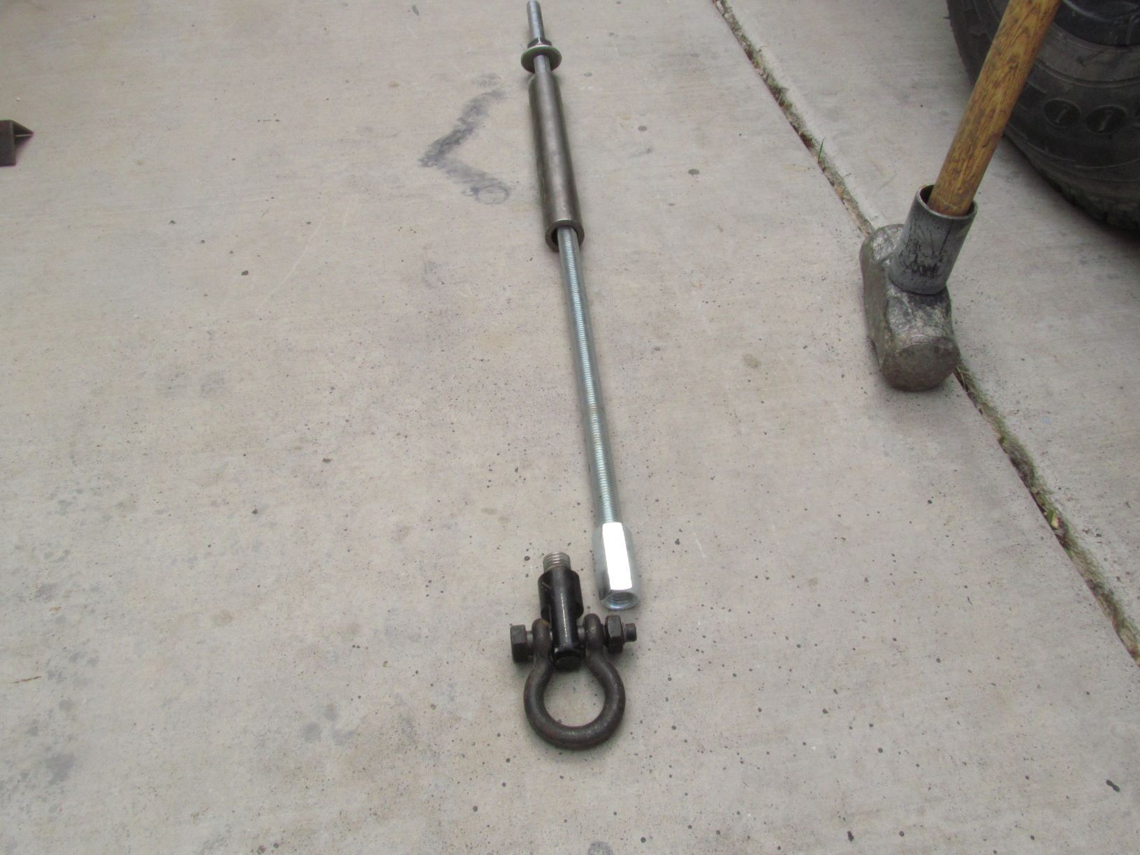

I have a ton of stuff with me for the summer's work so I build a slide hammer from bolt stock, a strange little shackle I found in the dirt in Texas which I believe is for pulling valve seats out of a mud pump, some 3/4 nuts/coupler left over from framing in DeathValley, and some .250 wall DOM tubing I bought to make bushings for my snowplow.
I had my Lincoln Ranger on the trailer and thought about welding a nut onto the axle for the slide hammer to bite, but settled on the little shackle and a chain bolted to the lug studs.
Slide hammer does not do the trick, so I need something else. Had I known before hand what I needed, could have left the trailer off to the side and used the loading winch to give it a tug. Like wise, the come along and straps/choker I had were not quite long enough to reach the fence post nearby.

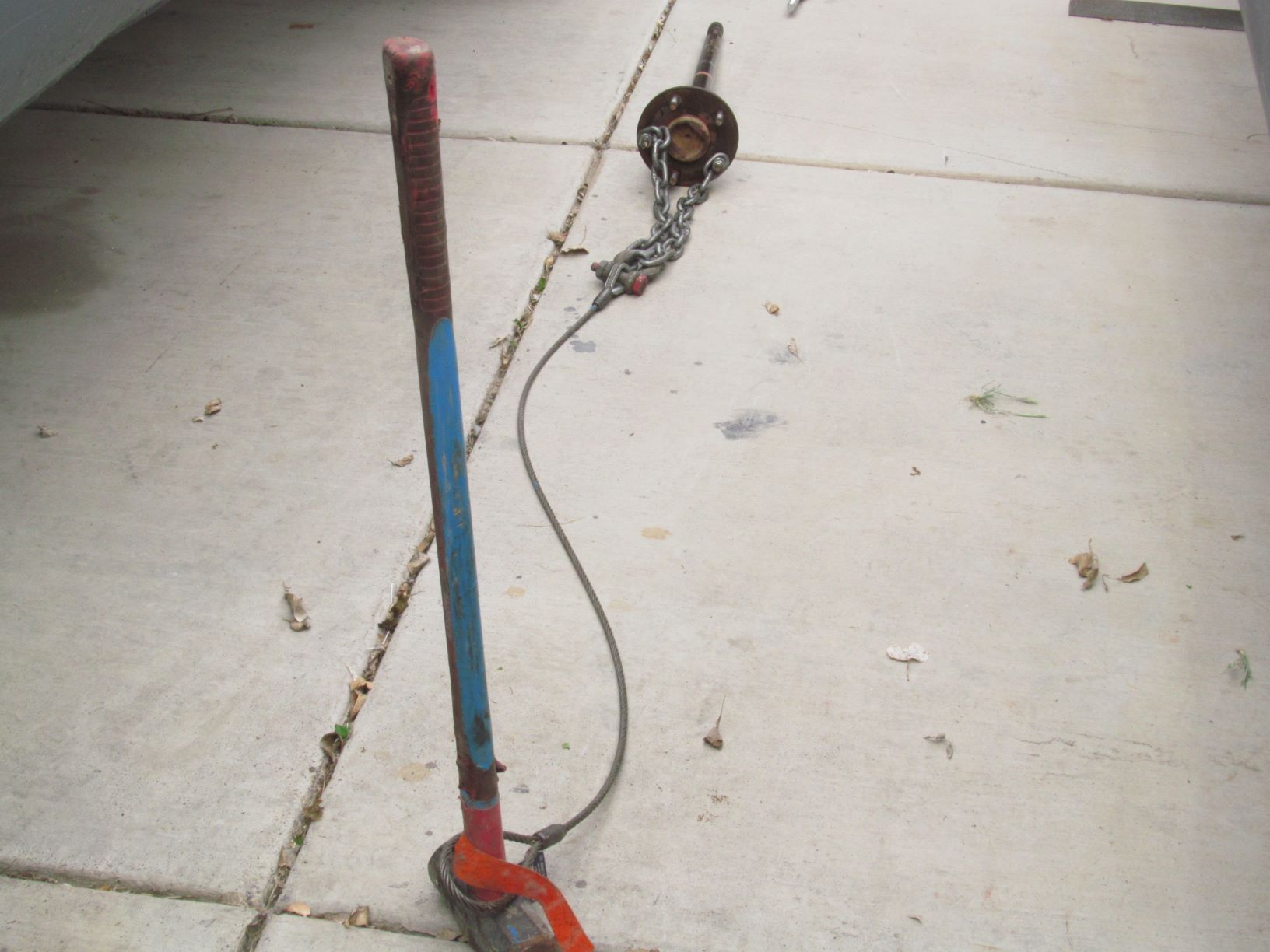

What I settled on was a "Swing"hammer.
I rigged this up at the house to show how it works. Swing it like a golf club, the chain and cable does the pulling.

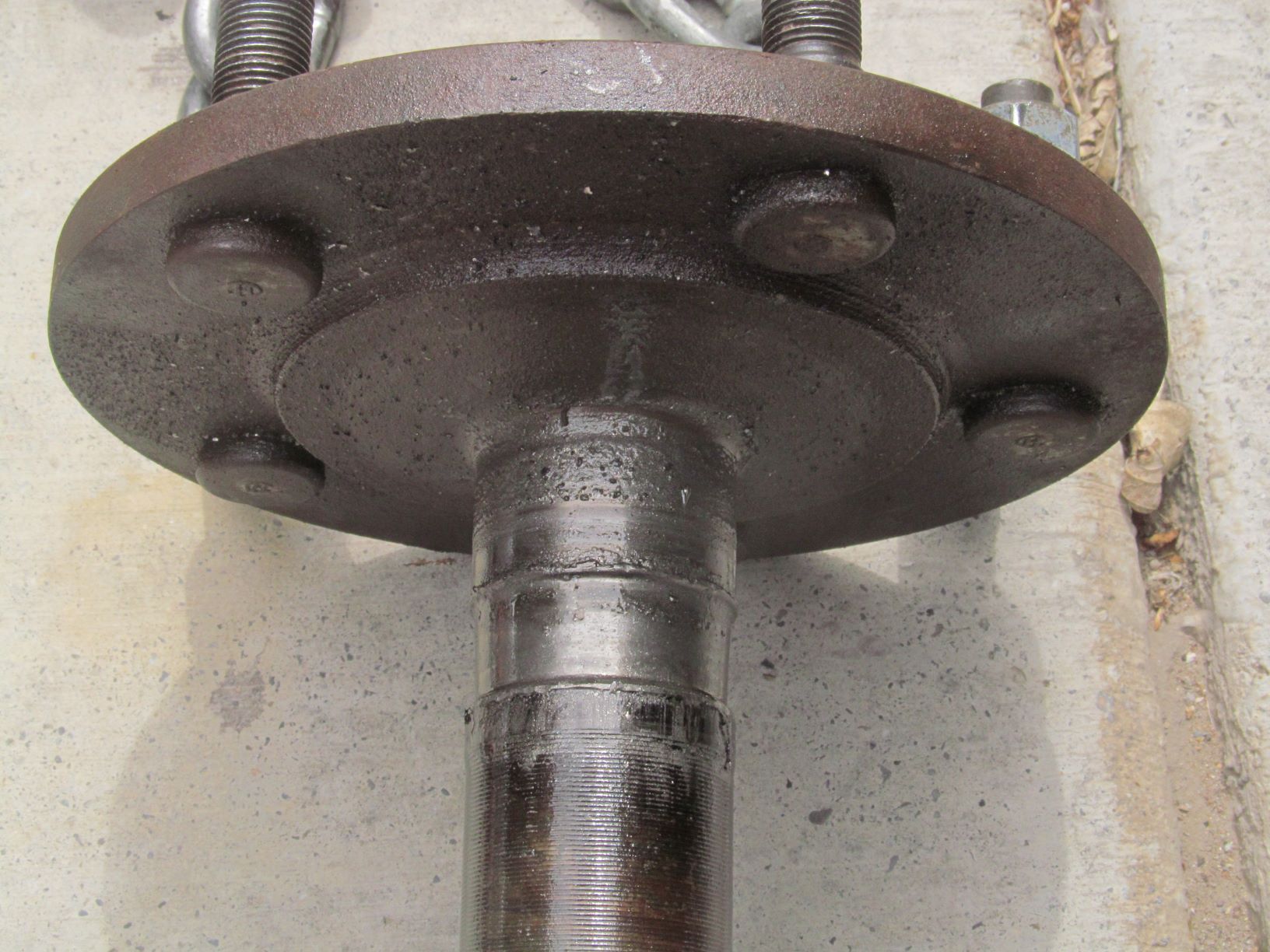

This is the axle and why it stuck.
Carnage, never seen a three sided roller bearing before
Rigged to push the rotor off with a couple of spare V-10 head bolts. Be careful, it was tight enough to bend the caliper ears before it popped. The park brake fought me as well. For those old enough to remember drum brakes, these are not self adjusting. Turning the star wheel down backed the shoes out of the way.
