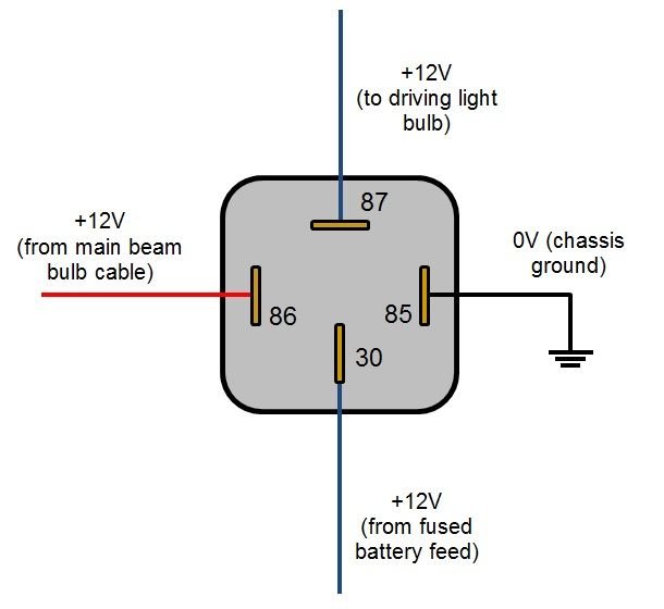

I have an 05 ram 1500, 3.7,auto trans.
I need to wire after market Fog Lights. The lights with brackets mount perfectly.
The problem is the wiring harness that came with them is too short, it has inline fuse and (5 pin relay) which I do not want to use the 5th pin.
Does anyone have a straight forward wiring diagram as I'm 71 and this would help.

Just ignore the 5th pin, center 87A.
