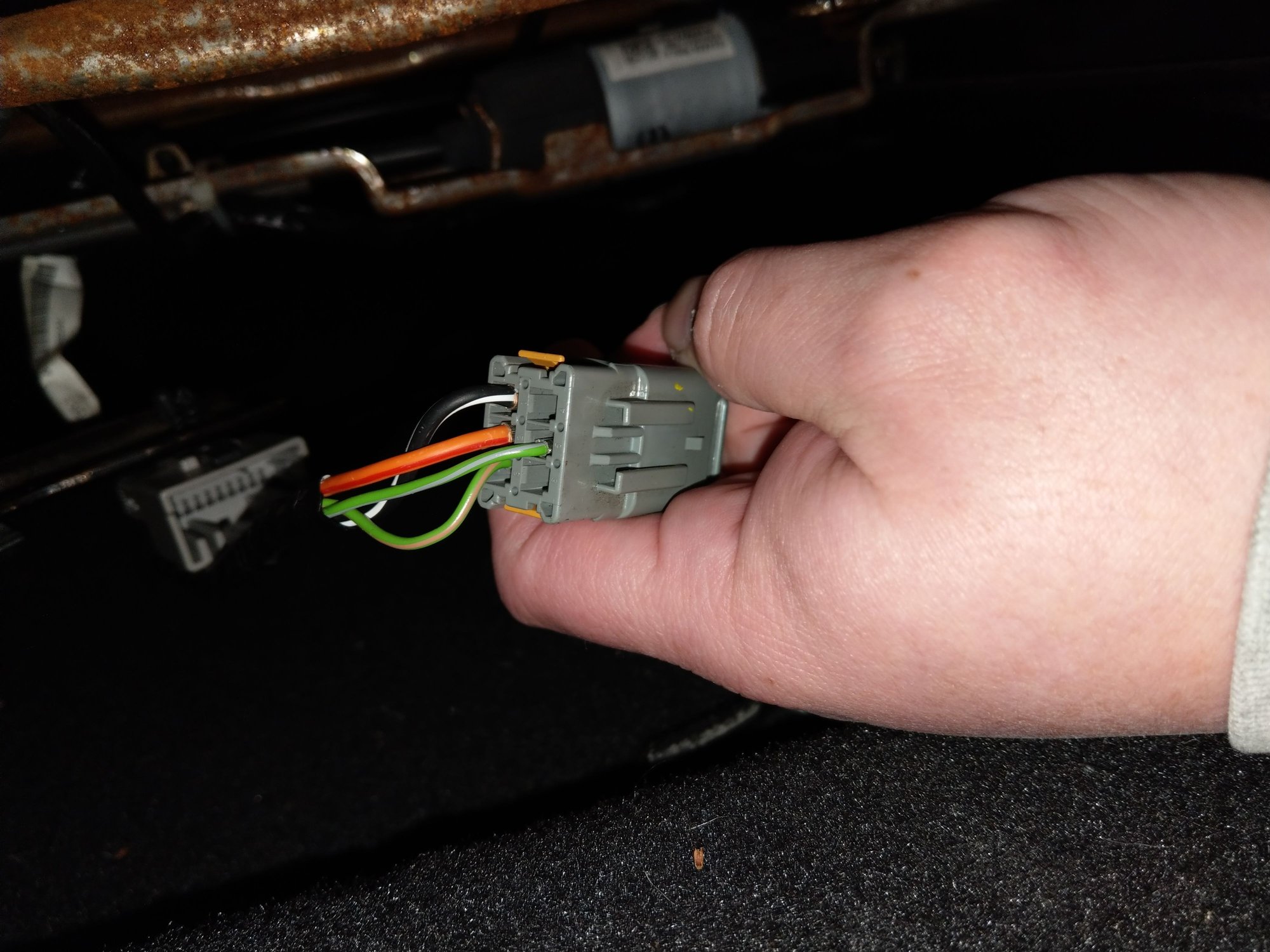

Will the power seat controls just plug right in?
Old Sep 9, 2020 | 11:02 PM
Magnoom's Avatar
Magnoom
Veteran: Navy
Veteran: Coast Guard
Joined: Apr 2019
Posts: 1,685
Likes: 262

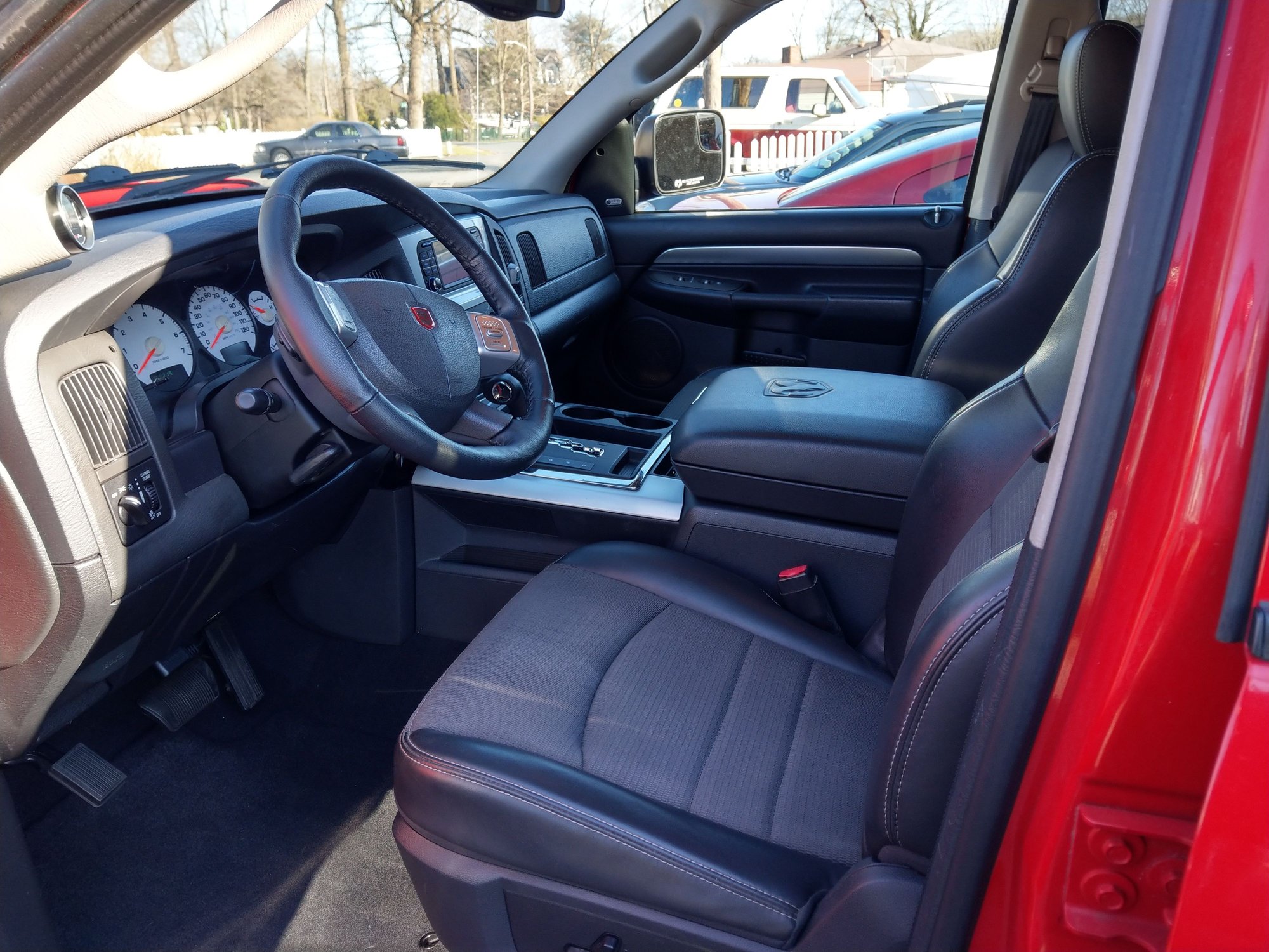

Not as is. To do it properly, unpin the connectors from your original seats and the new seats and insert the pins where they need to go to match up with the truck. Hot, ground, seat belt. All the seat motors come off the hot and ground as does the lumbar support.
Finished product in a 2003 (with a few extras):
