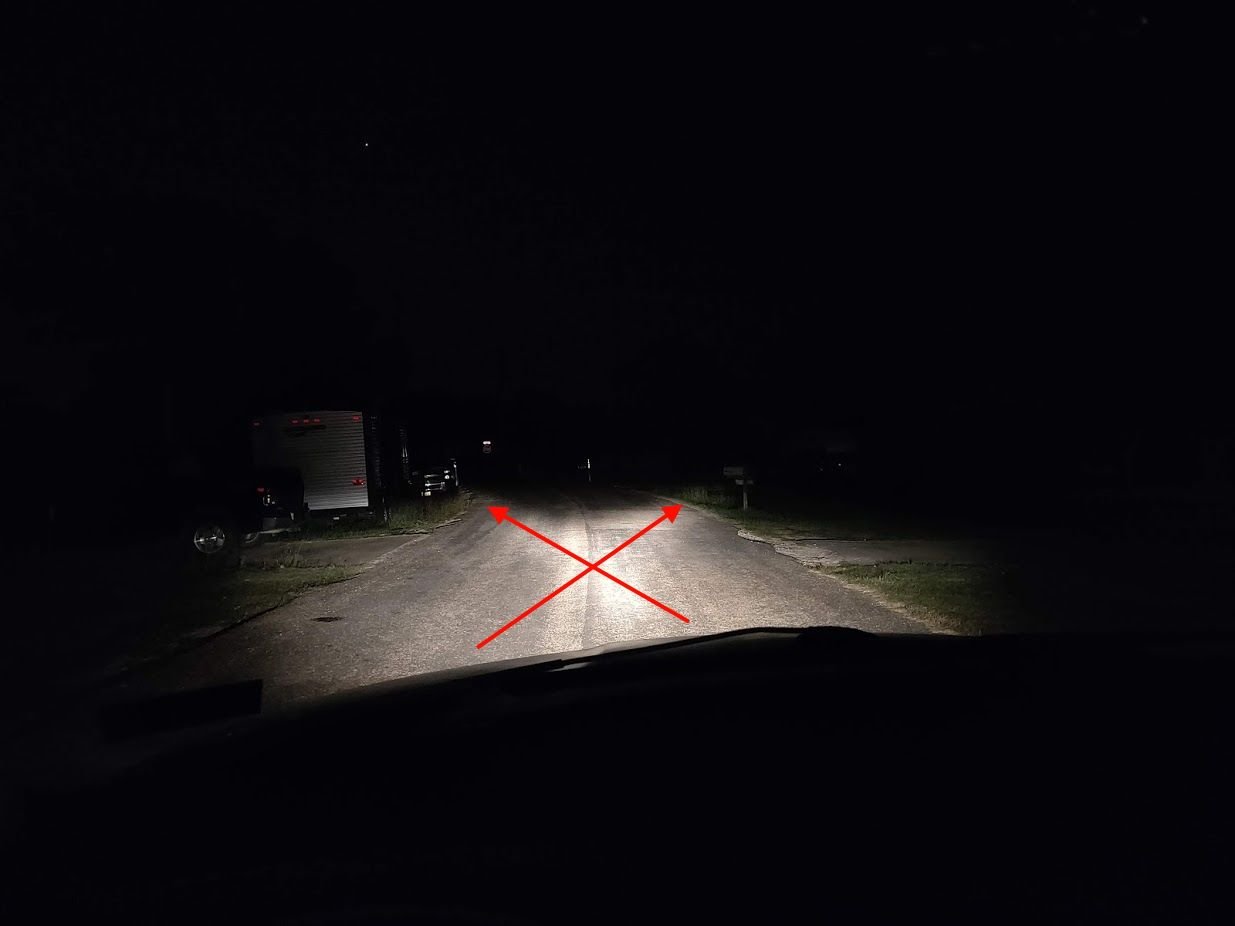

So I sent them photos of what the beam pattern looks like. So check this out:
This is just the left headlight plugged in and as you can see it's pointing off the road not even 30 feet in front of me.
Here is one of both headlights turned on. This is what puzzles me. What are the odds that I would get 2 head light housings that blast light like this at this extreme of an angle? They're both installed properly and seating decently.
I'm not entirely sure I can shim these enough to correct this. So they offered to send me a new set and said, "This will allow us to have your new replacement inspected and tested to ensure full working condition prior to shipment."
So I give props to this company for going this far over this.

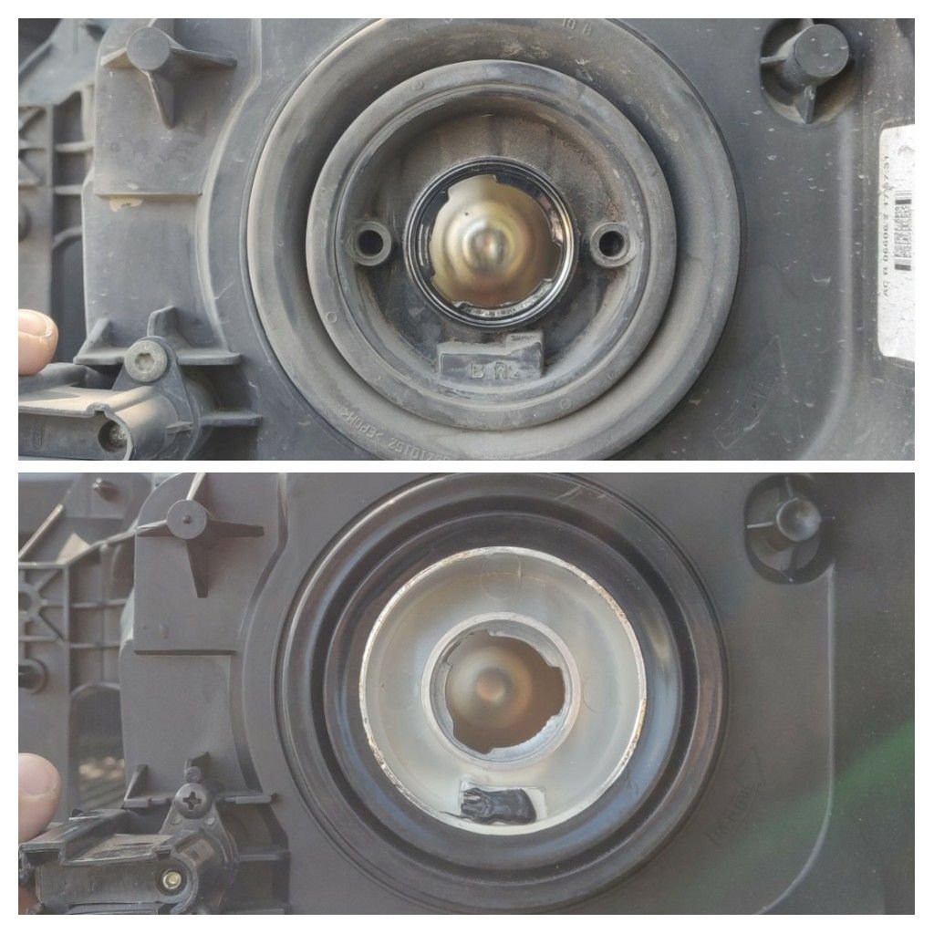

So the retailer was supposed to send me a return label. When I asked them about it their return question was if the product fixed the issue. I told them it did not, then took a bunch of pictures showing the fitment and mount points. While stuffing Taco Bell into my face I sat there thinking about what could cause the issue. Then I remembered on both sets of these new housings the beams curve up towards the center.... Then it hit me.
Check out the notch placement between the OEM top and after market bottom. There is the problem. I have forwarded my findings with the retailer.
But there is the actual issue.
