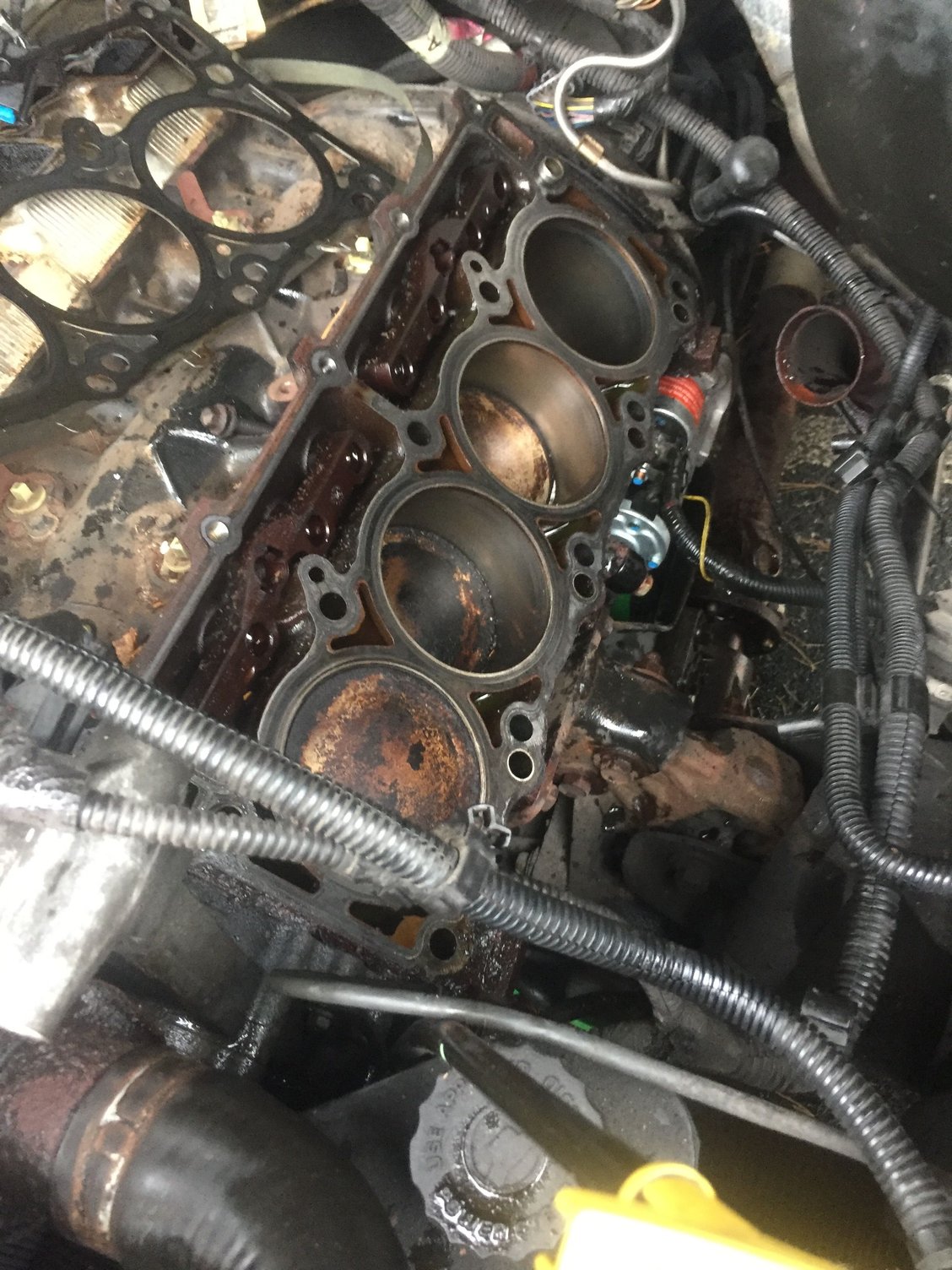

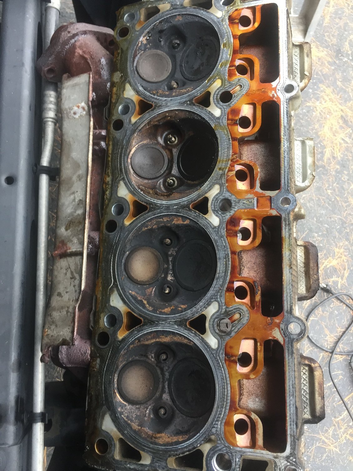

Pulled the head today, worst part was undoing the exhaust manifold flange bolts, took a good two hours for the one bolt that was fighting me. I’m going to replace the exhaust manifold while I’m at it. Found a stuck lifter. Also going to pull other head and replace those lifters and pushrods.

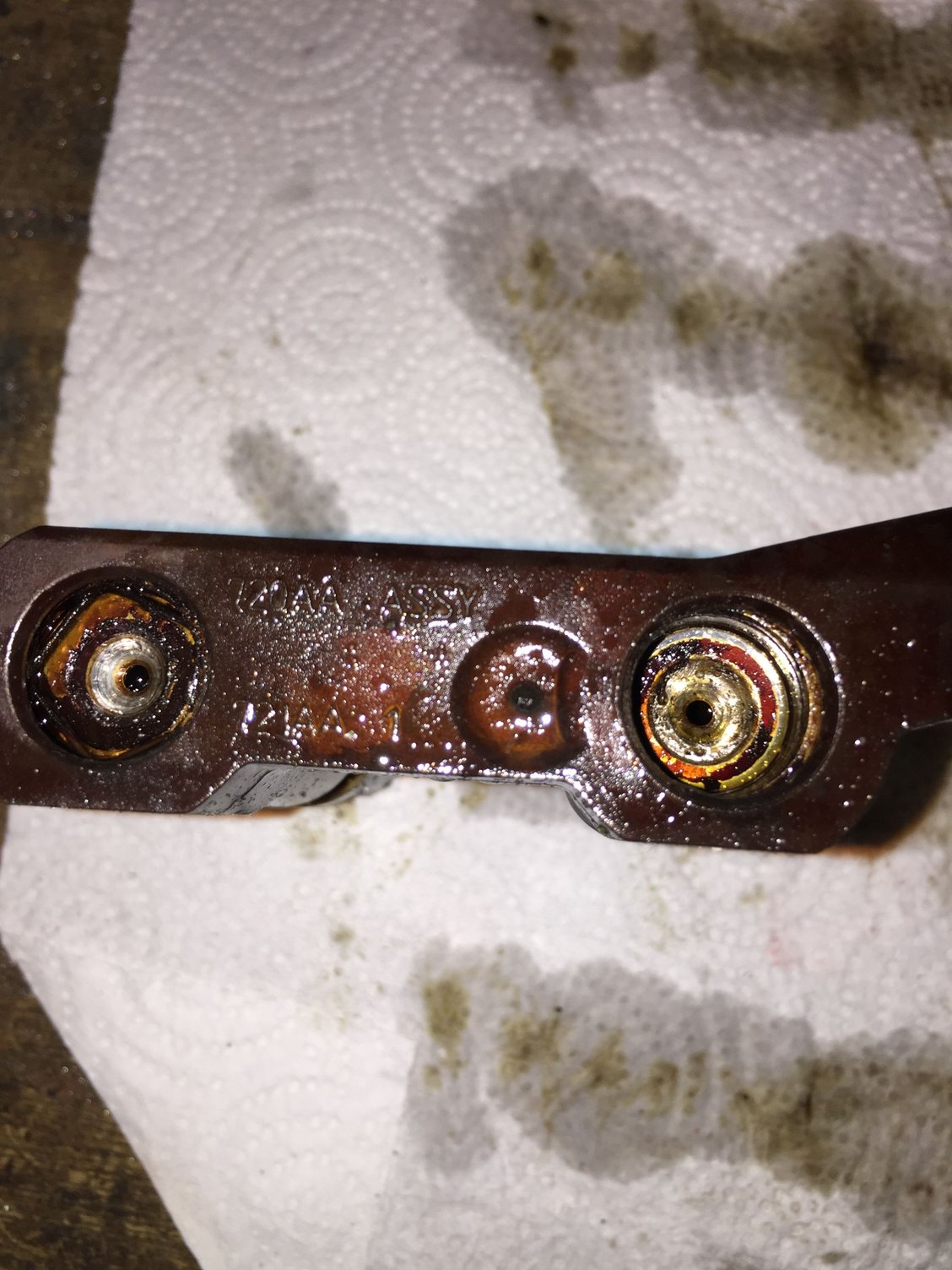

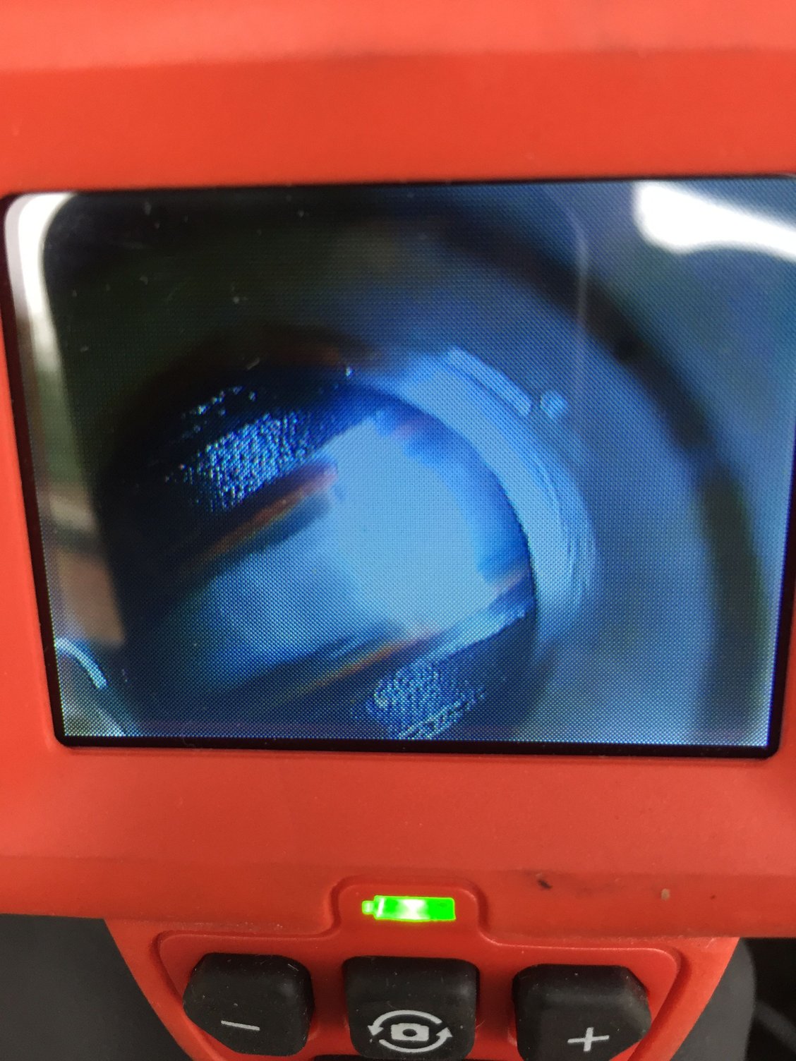

The cam lobes looked fine from what I could tell, I scoped each one. All the rollers felt fine and smooth on the lifters. Thought I just pulled head and lifters for nothing, then I noticed on the back side the one was sitting lower then the rest. (Not sure if picture shows it great).
I replaced all 8 on that side and all new pushrods, I’m planing on doing the same on the other side as well while I’m at it.

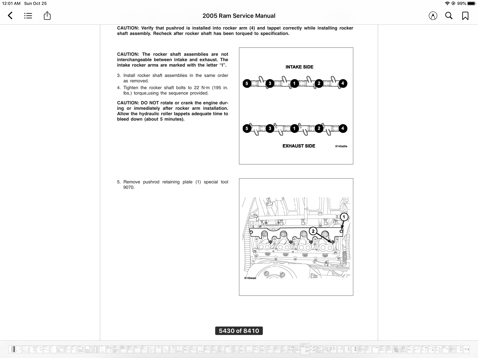

I’m ready to install the rocker arms on this side.. I see dodge has a special tool to hold the pushrods in place on the intake rods.. is there a trick to do it without it? Also my rocker arm sits up about a half inch if I have a pushrod properly seated, ( I double checked the pushrods were installed in the correct location)I didn’t try tightening down the bolts as I don’t want to snap anything.. is it because cylinder 1, the piston is to the top and if so is it ok to hand turn the crank to lower it? I see in the service manual it says not to rotate/crank the engine, so not sure how to proceed.
