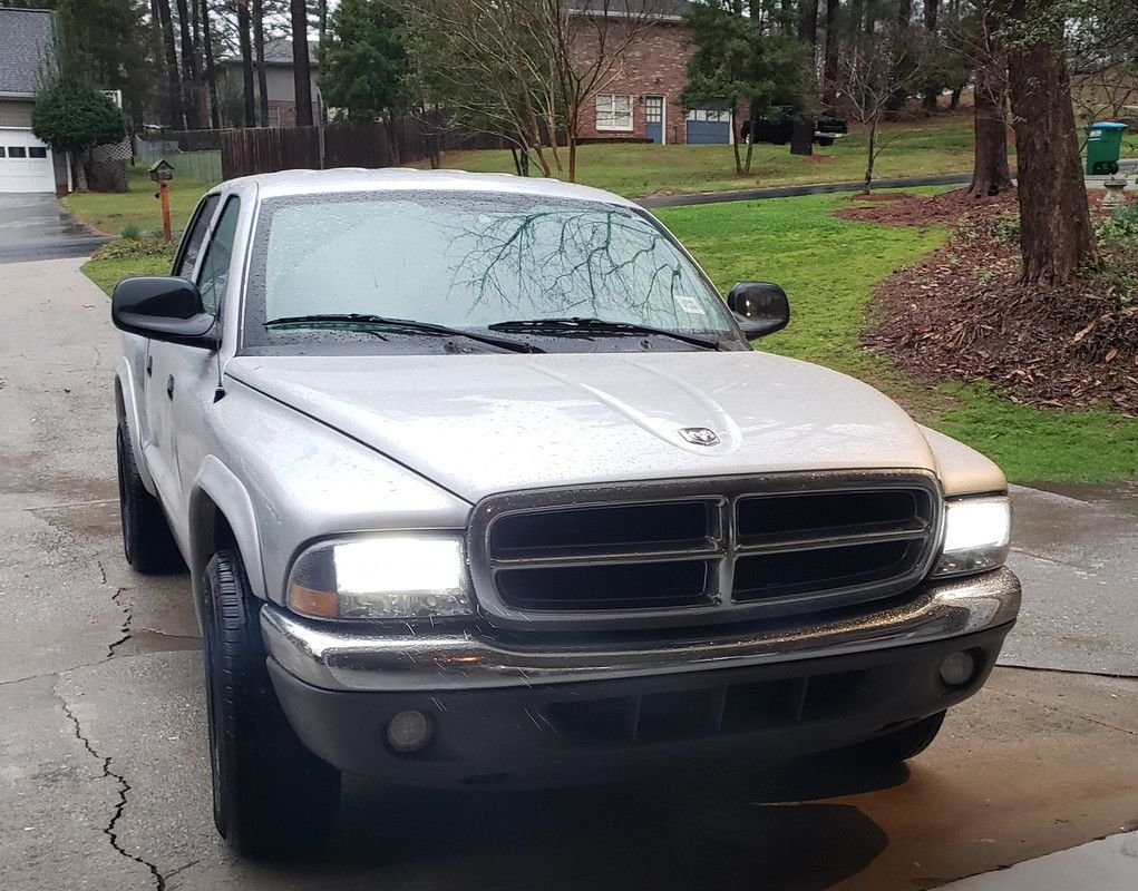

I converted to LEDS (I have a Dakota). First thing happened... low beams were high and high beams were low. I ended cutting the headlight wires and reversing the polarity. Most sellers will send you a converter for things like that. Also, canbus conversion, etc.
The bulbs I got are 9007, which will be the same as yours, however they are no longer available. They claimed to be 1200 lumen and indeed are pretty bright. Definitely an improvement over the halogens.
Whatever you get, make sure they are high lumens and make sure you adjust them properly to not blind oncoming drivers.
