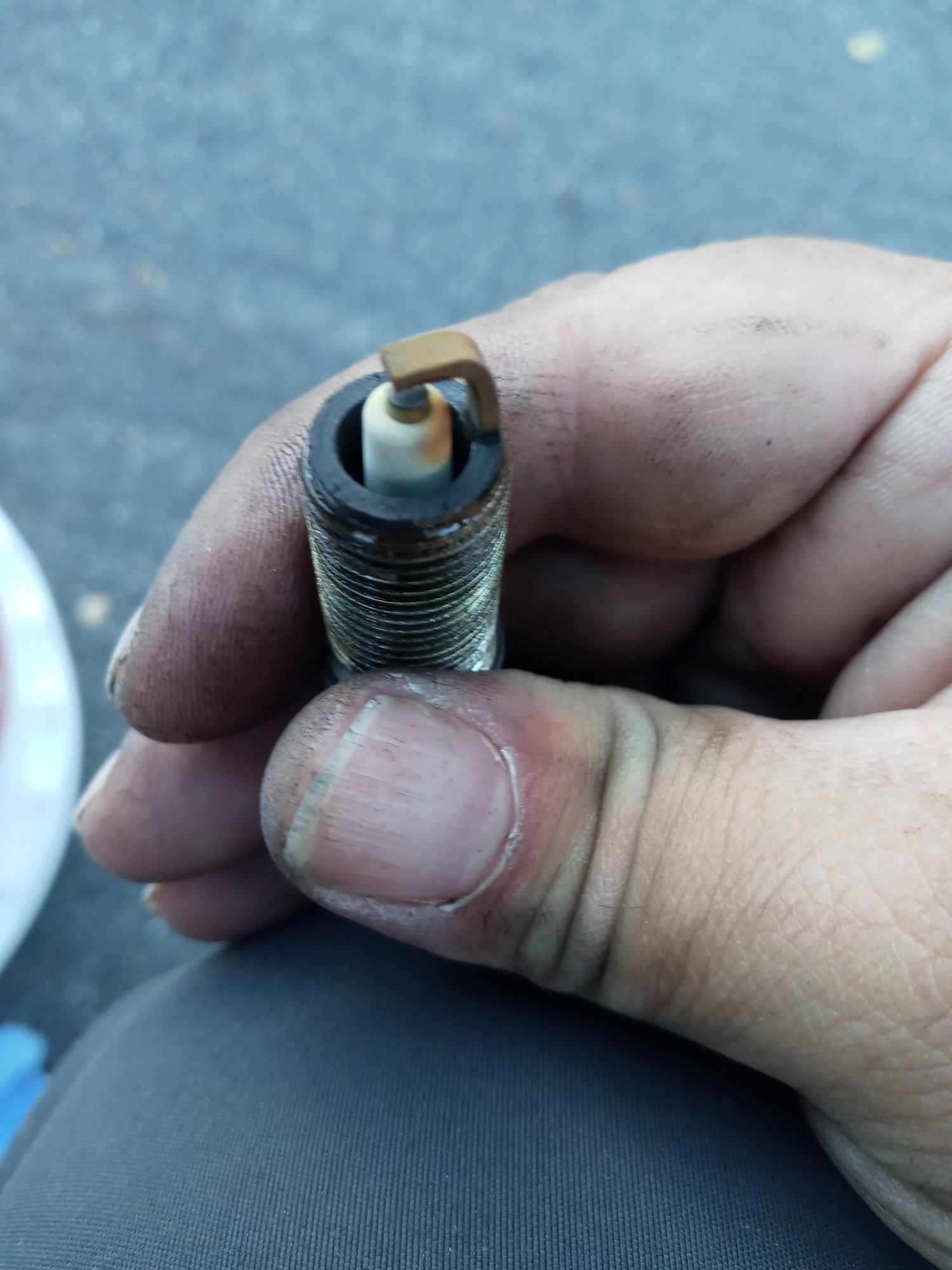

Hello mods and friends,
I have a question about weather or not to add a bit more antisieze if I'm just checking plugs for fouling.
I'm running iridium plugs at the moment I think some plugs come pre applied but I'm not for certain.
However I can't remember if we did or did not .
Which anti sieze to use the copper based or the other kind ?
If I do find some fouling can these iridium plugs be cleaned up ?
I'll assume they can't be regapped though just brushed n cleaned ?
And final question if it's possible too clean the fouling is there a preferable cleaner to use.

Hey Veteran thanks for the comeback. Yes I'm having some long crank then start issues. So I'm starting down theRabbit hole of diagnosis. So Administrator Hey You suggested checking Fuel and spark delivery. That's why I askingAbout pulling plugs looking for fouling, cleaning, antisieze, back in. So it's both a diagnosis and a maintenance tune.
I have about 30k on Irirdium's with Denso long over the top of engine spark plug wires.
Yes I agree to your NGK OEM replacement. Going to do exactly that.
Yes curious about the Shorty plug wire mod that you mentioned.
I'm 88k miles in on this 2005 ram 5.7 hemi 4x4 truck.
Thanks again for the tips.

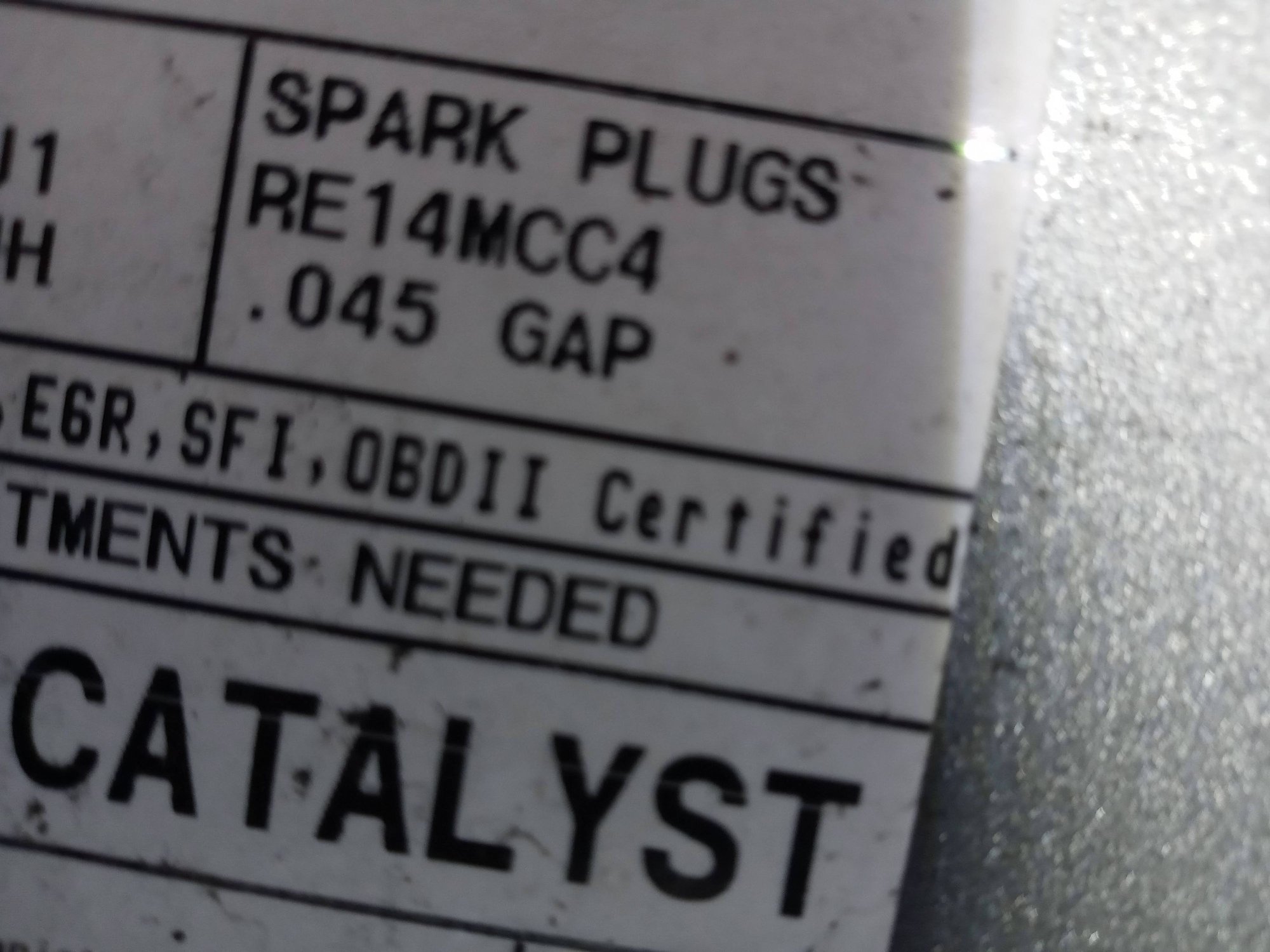

Alright so I did a resistance check on all 8 Denso plug wires.
I worked from driver's side cylinder bank 2 plugs, 2 wires = 2 ohm numbers per cylinder.
Resistance numbers below for each plug wire @ 33" Long plug wire.
C1. 12.98 k. Ohms 11.50 k. Ohms
C3. 11.50 k. Oms 11.75 k. Oms
C5. 12.78 k. Oms 12.85 k. Oms
C7. 12.50 k. Oms. 11.90 k. Oms
Am I within spec ?
I don't where to find spec numbers for the 33" long Denso plug wires.
