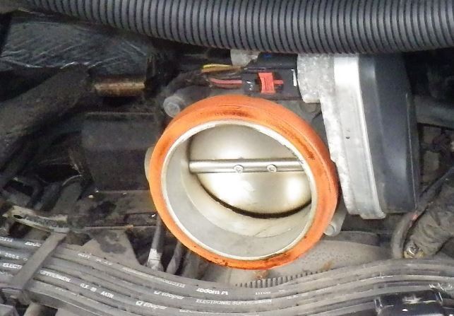

You might try pulling the airbox off and run the engine in the dark. Check for spark scatter and arching.
Any brakes dragging / heating up? Parking brake intact? My right rear lining actually came off the shoe and was floating around. I found that out when I did my brakes.

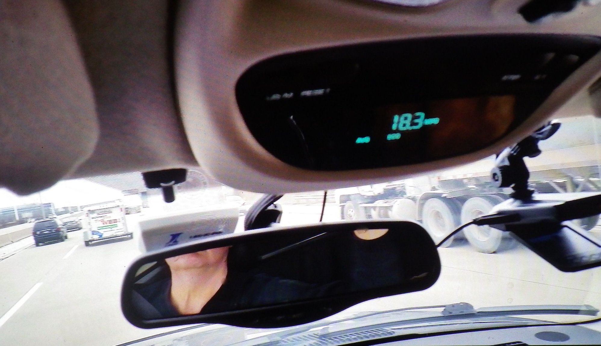

You are already way beyond this. When I lost mileage on my '05 5.7 Ram, per the trip computer, I went from 18 (65 mph on flat road no wind) down to 13 mpg over a couple years. New plugs, air filter, Seafoamed half of my 32 gallon tank, and it didn't help a bit.
Pulled of the air box, looked down the throttle body, and found it was caked with crankcase blow-by buildup. Spent about 45 minutes with several Seafoam soaked rags wiping the grime out as far as I could reach. I got my mileage back.

I did use the spray Seafoam in the air box. I will try some more. Could yours have been from a dirty IAT sensor or just dirty intake?

Originally Posted by 05slowhemi
....... Could yours have been from a dirty IAT sensor or just dirty intake?
I can't say for sure. Other than disconnecting and reconnecting the IAT plug, I didn't touch it. A faulty connection? Perhaps.
Leaving TB on the truck, I just wiped it clean as far down I could reach in the TB with the plate open. Even the plate was caked up. Leaning toward the grime in my case.
