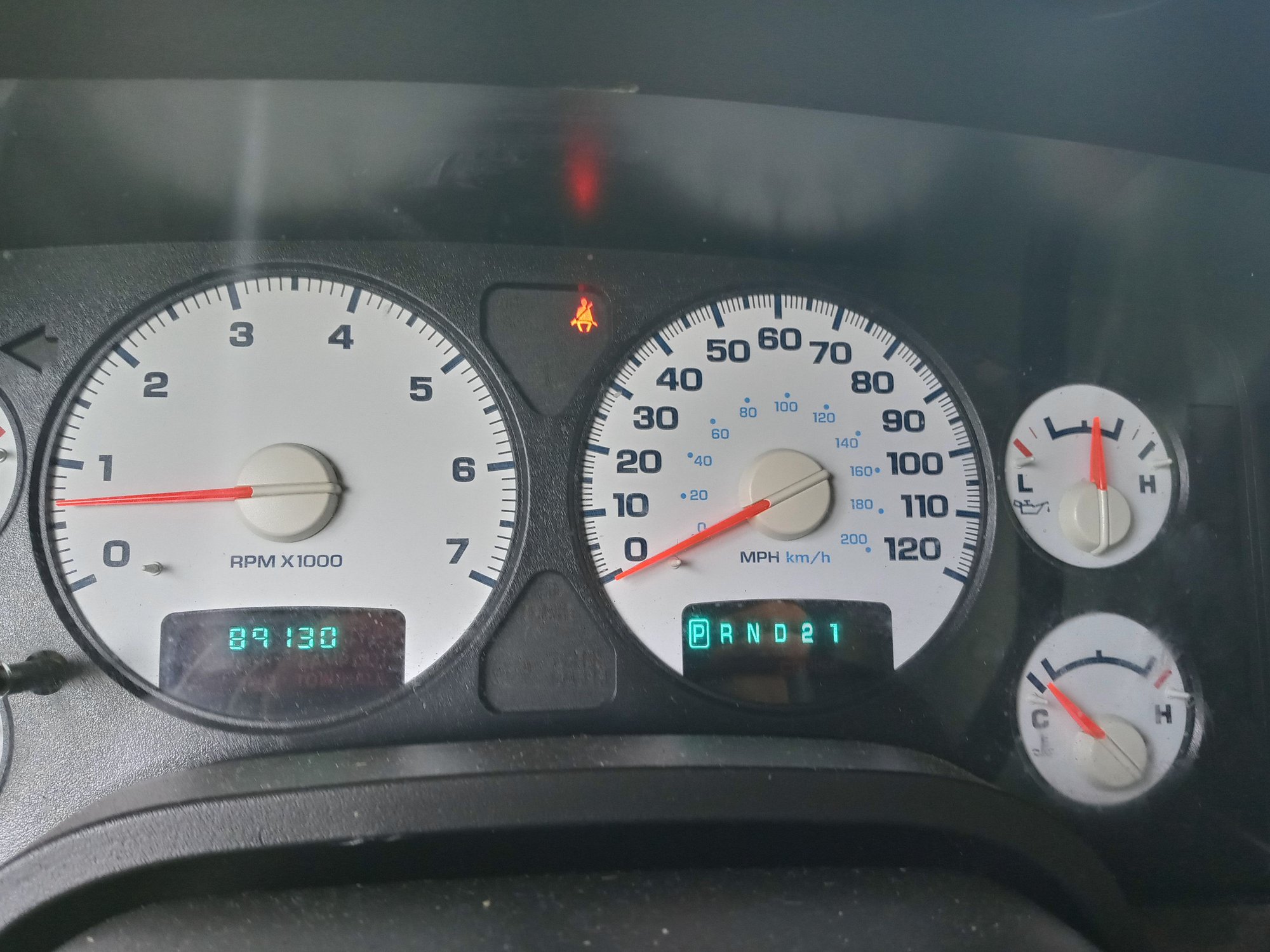

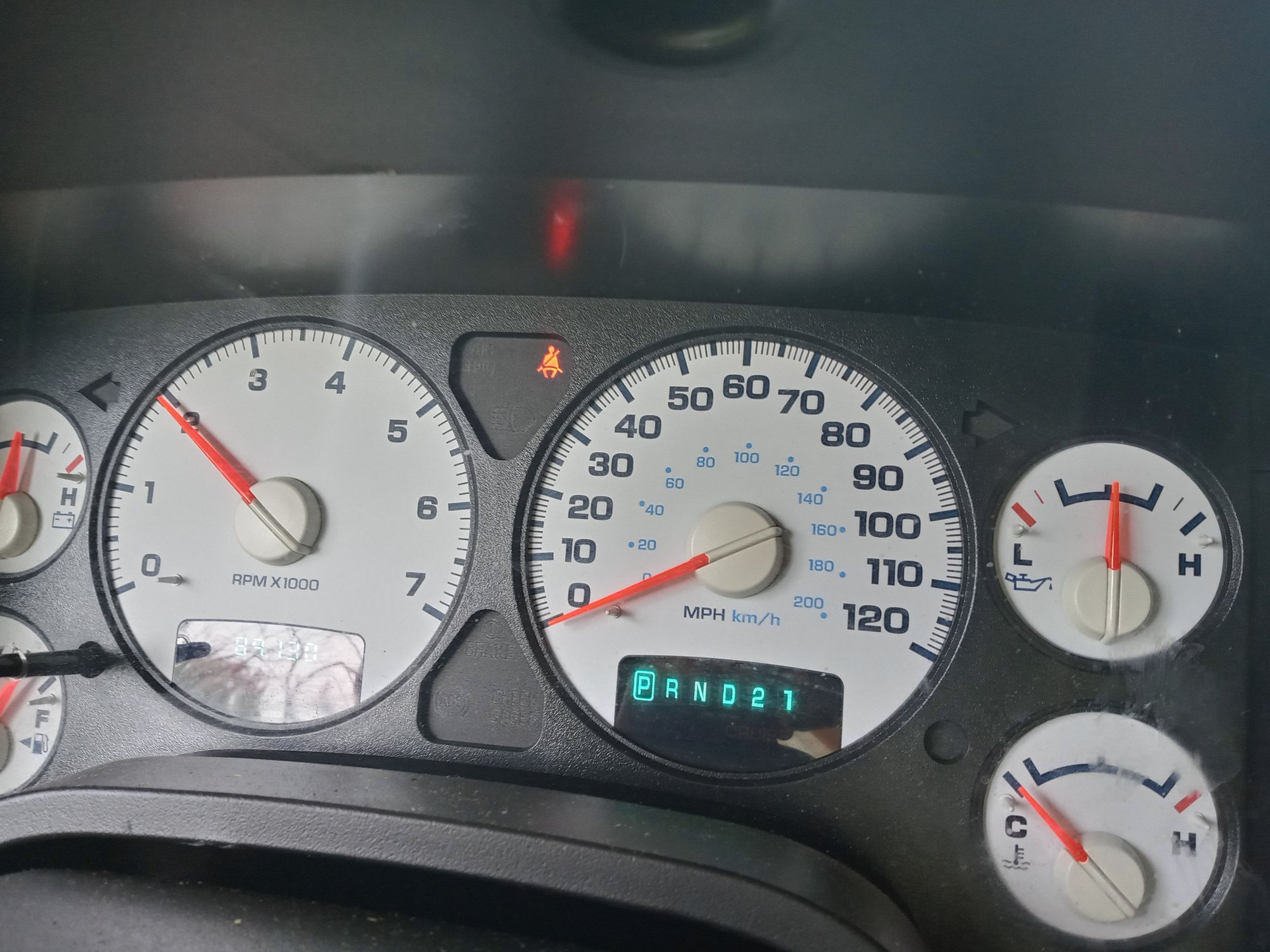

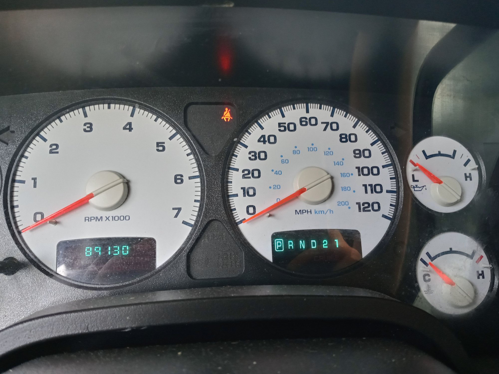

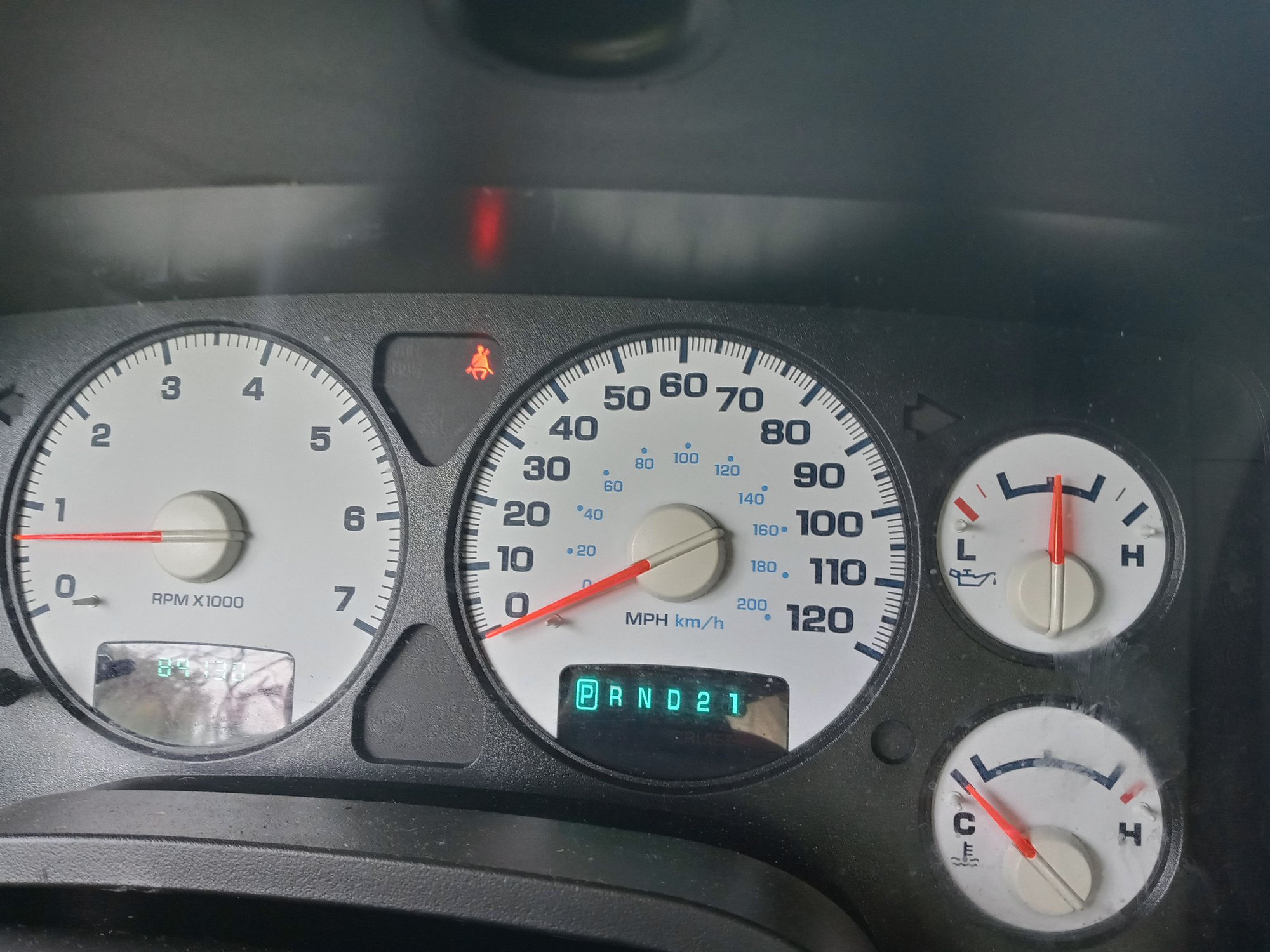

Okay so this is what i can do for now. Cant get ahold of a guage. So had to go with dashboardOil pressy guage. Let warm up for 5 minutes. Oil level is perfect.
With key in the ON position. Oil pressure needle Did not move but just enough to come up off the Resting spike maybe a 1/16 . Almost nothing.
Here we are at an even idle right after START.
Samething here but 30 seconds into an even idle.
And here we are at 2000 rpms even idle.
Old Feb 9, 2021 | 05:47 PM
Posts: 87,483
That looks fine. Right where it is supposed to be. Gotta be something else going on there. (Not a pressure regulator problem)
