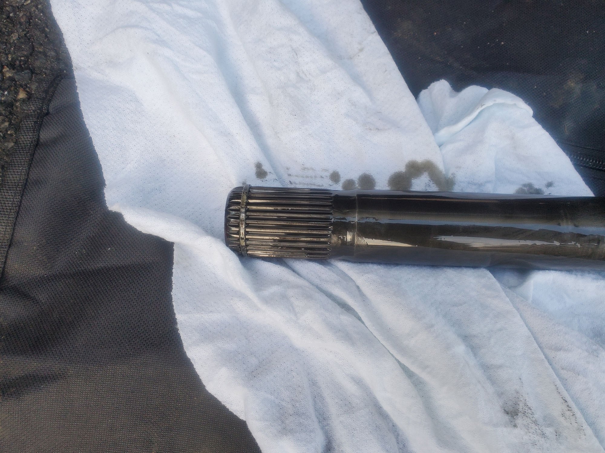

Thanks for the suggestions on this issue. I've checked all the bolts on the sway bar and they are torqued to specs. The Trans axel on the passenger side is also known as the Front Axel Shaft, Dorman part # 630-415. We actually have a snow and ice storm here today and just took the truck out to ensure it is not the 4x4 Bind up that was mentioned in another post. Unfortunately, it is still making a clicking noise while turning in 4x4 with snow and ice on the roads. The only thing I can think of at this point is to replace the Front axel shaft on the passenger side and get into the front diff and check the gears. Other than that, I am at a loss.

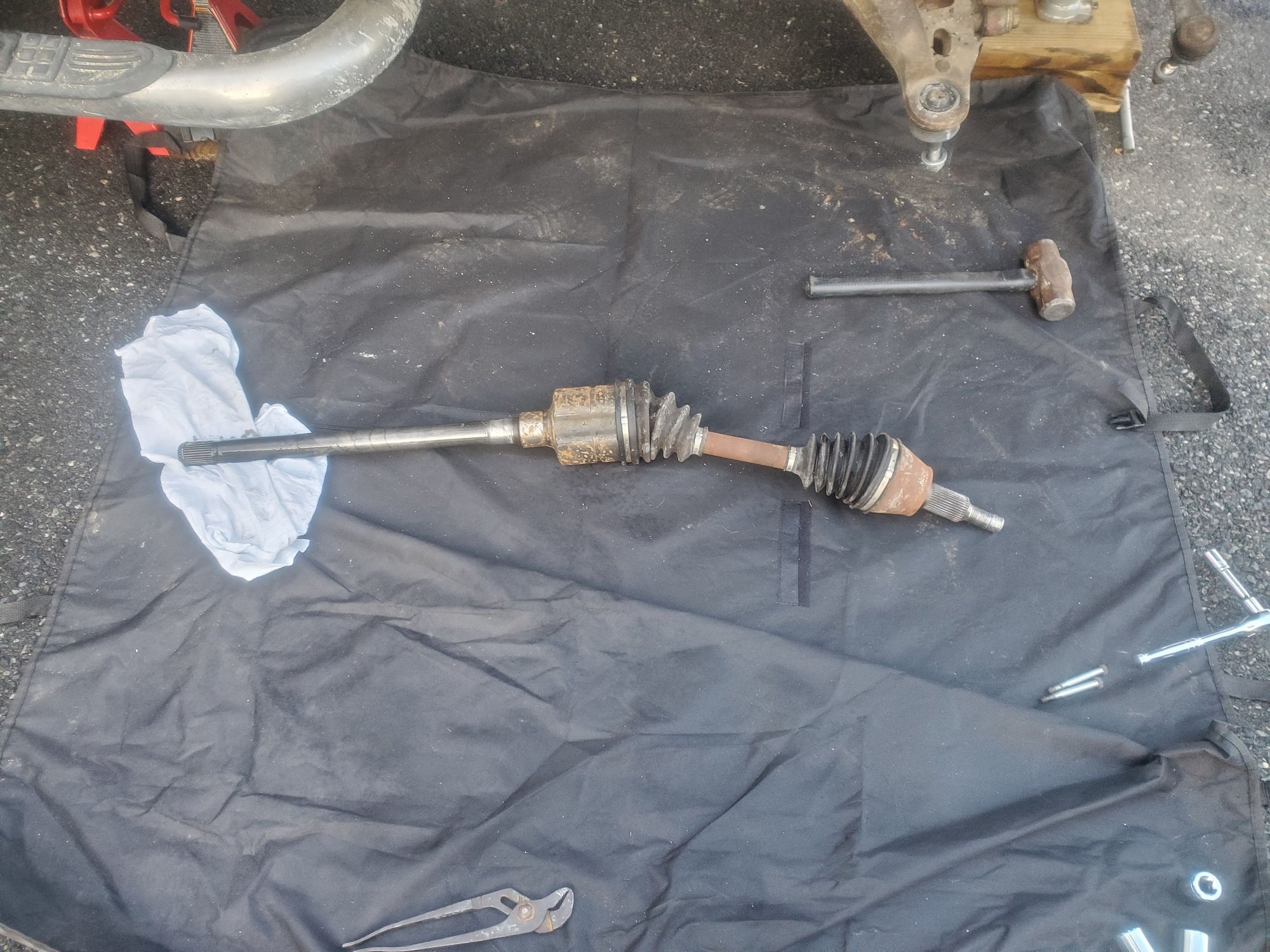

Got the truck all torn apart, again. I decided to replace the Front Axel shaft, the hub bearing, and possibly the CV axel (even though I just replaced it 4 months ago). I am going to tear into the front diff and see what's going on in there. Will post more tomorrow when I get done. These are the old parts...

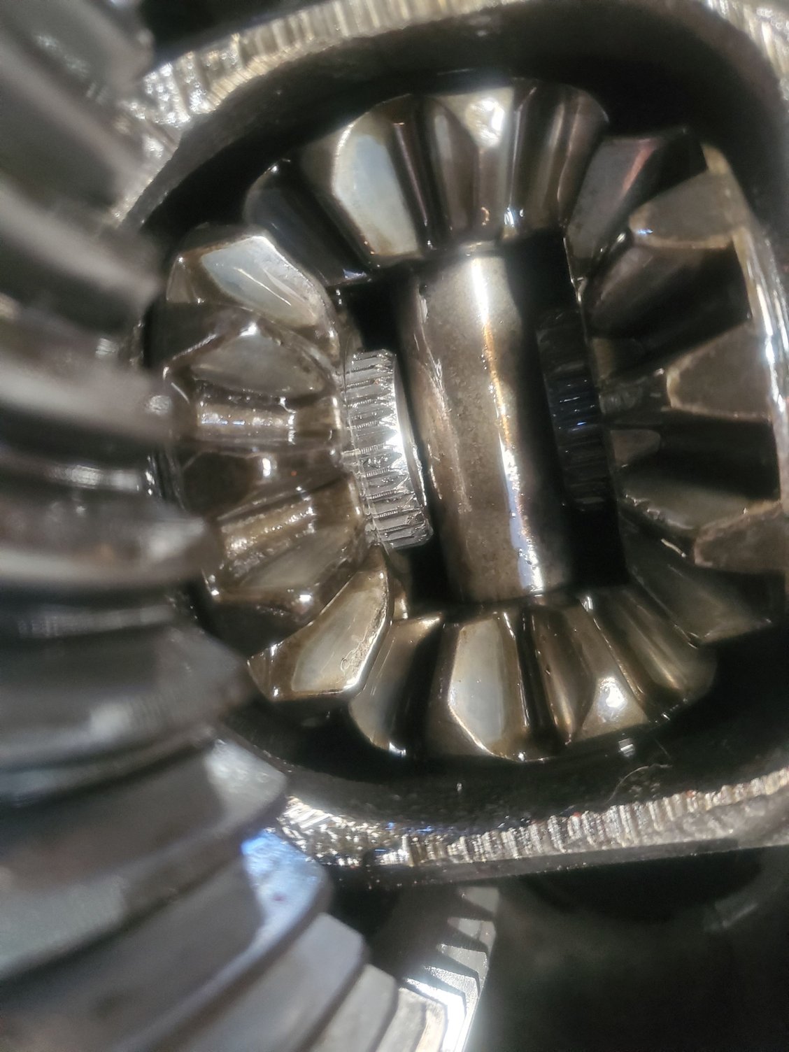

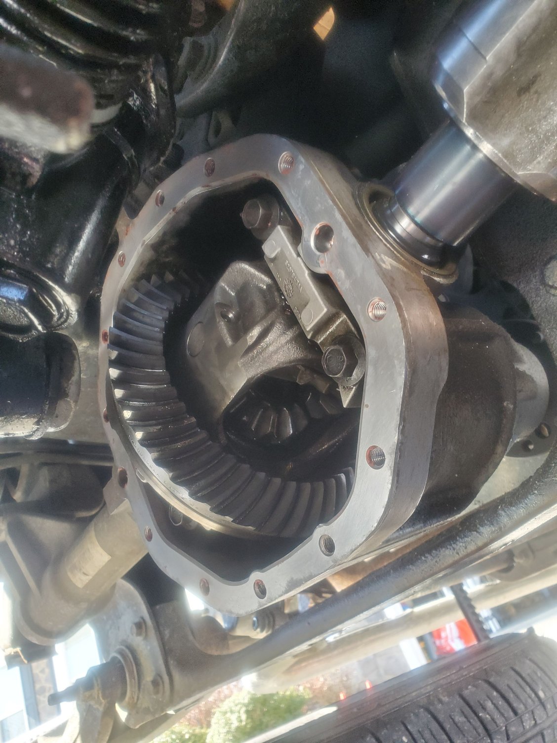

Well changed out the hub bearing, CV axel, front axel shaft, and pulled off the front diff cover. The gears in the front diff looked great....no marks or metal shavings in the oil. Put it all back together and test drove it. Still making a nasty clicking noise when turning in 4x4. This is an issue I need to address. I guess my next step is to move back to the front drive shaft and transfer case. Any advise would help.
