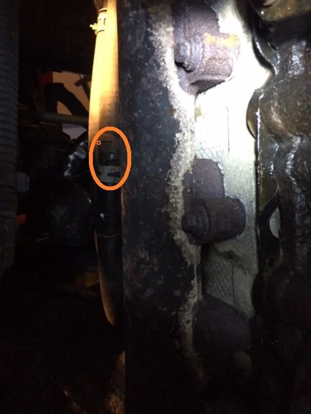

Since replacing the cooling system (New Rad, Rad Cap, Hoses, Thermostat, and complete flush of system) last November I've been losing about a quart of coolant or a bit more each week. The Ram runs fine, never overheats, heat works after driving a mile, and no relevant codes. Finally got a pressure tester today and first tested the rad cap (16 lbs)- goes to 12psi then holds at 10 for 5 minutes. Checked the old rad cap I'm not using and that one goes to 10psi then holds at 9. Put tester on the overflow (no cap on rad for 02) and pumped it up to 13psi and checked for leaks at rad, hoses including heater, water pump, and overflow tank. pressure holds steady with no drop after 5-10 minutes so guess that rules out head gasket thankfully. Found only one slight leak, a drip where one of the heater core hoses in the engine bay has a connector pipe joining 2 hoses with pressure clamps. A drop forms and will drip after 2-3 minutes onto the frame rail so its pretty slow leaking.
Would this be enough to need to top up as much as I am needing to each week?
Pic of drop forming in middle of circle between two clamps/hoses:

The logical thing to do is to fix the leak you found and see if that takes care of it.
Not sure of the Ram setup but the cooling system in my Dak (4.7) is rated at 21 psi max. Best just to pump it up to max and stick a piece of cardboard underneath, then wait for a while for the drips. If still losing after fixing, go get a block tester as u may have a hg issue. If u pull plugs and one looks steam cleaned, that would be the cylinder where u have a hg leak.

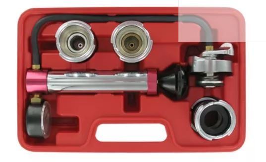

Went to the Parts store today to pick up a rad cap for the Grand Caravan as the one on there had failed completely, no pressure would hold. So go to the parts counter to get a new one and its a 16lbs one like the Ram. As I was returning the tool I asked to test the new one as I suspected a possible bad gauge on the tool that was under reading the psi. Tested some new ones and the all popped air at 12 psi like my newer ram one did. So, seems like the gauge is under reading by 4 psi and the Ram rad cap is good and I pressure tested the Rams cooling system at 17psi not the shown 13psi, with only the heater hose connection leaking (will be changing that and report back).
Disappointing that the gauge didn't read right, and not an inexpensive tool deposit as it was $220, more than most tool rental deposits. It was an "OEM" branded tester :
