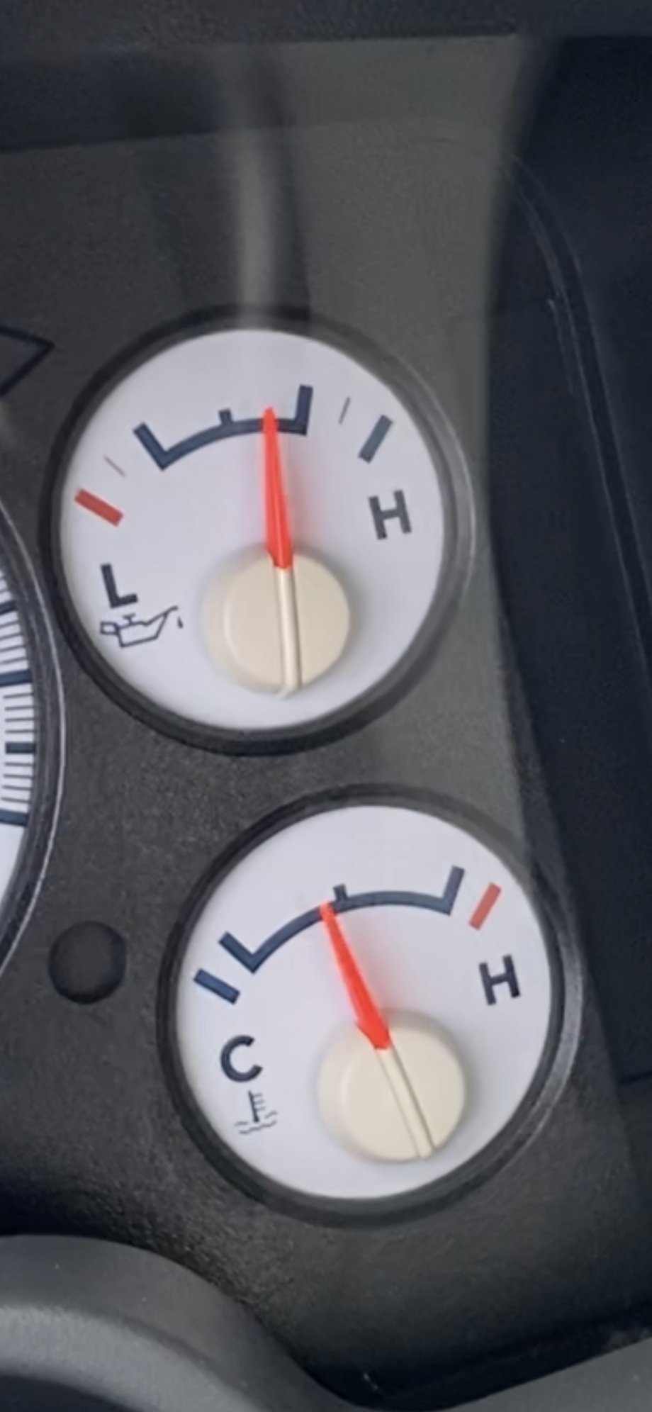

I’ll give it a try. Also just noticed the oil pressure gauge reading somewhat high? Does this appear normal for their vehicle? Could the noise and vibration be related? Photo attached.
Old Apr 13, 2021 | 02:18 PM
Posts: 87,482
Pressure is still in the acceptable range. That isn't your problem. (that would have been too easy. )
