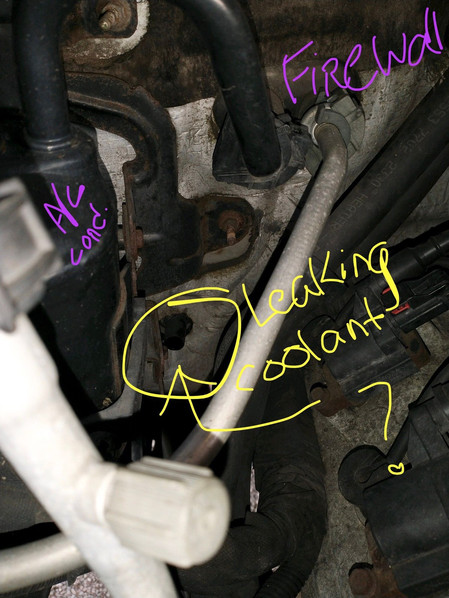

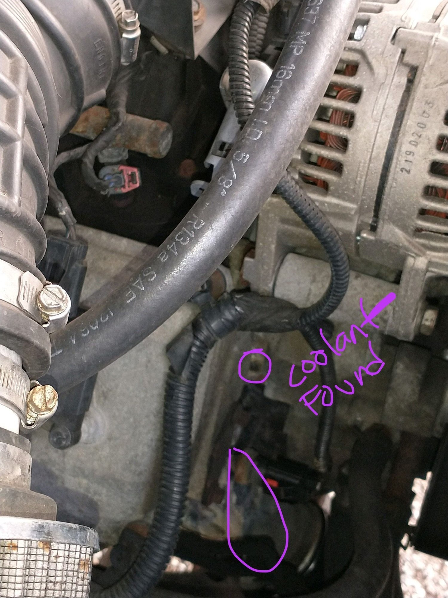

Default Mystery coolant leak in 04 Ram 2500 5.7
What is this tube coming through the firewall circled in yellow? It’s leaking coolant.
Also found coolant in areas circled in purple. Coolant smell inside cab.

The tube coming thru the firewall is the condensate drain for the a/c. With the a/c running, it's normal for water to drip out there. If it's actually coolant... then likely the heater core is bad.
Coolant leaking in those locations on the engine though... that might be a bad head gasket. Unless it is running down there from somewhere else?
