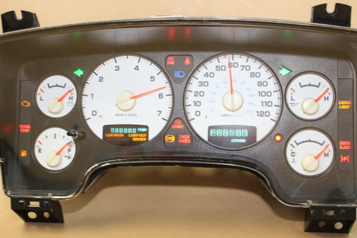

See if this works.
Engine symbol, left side, at the top.
