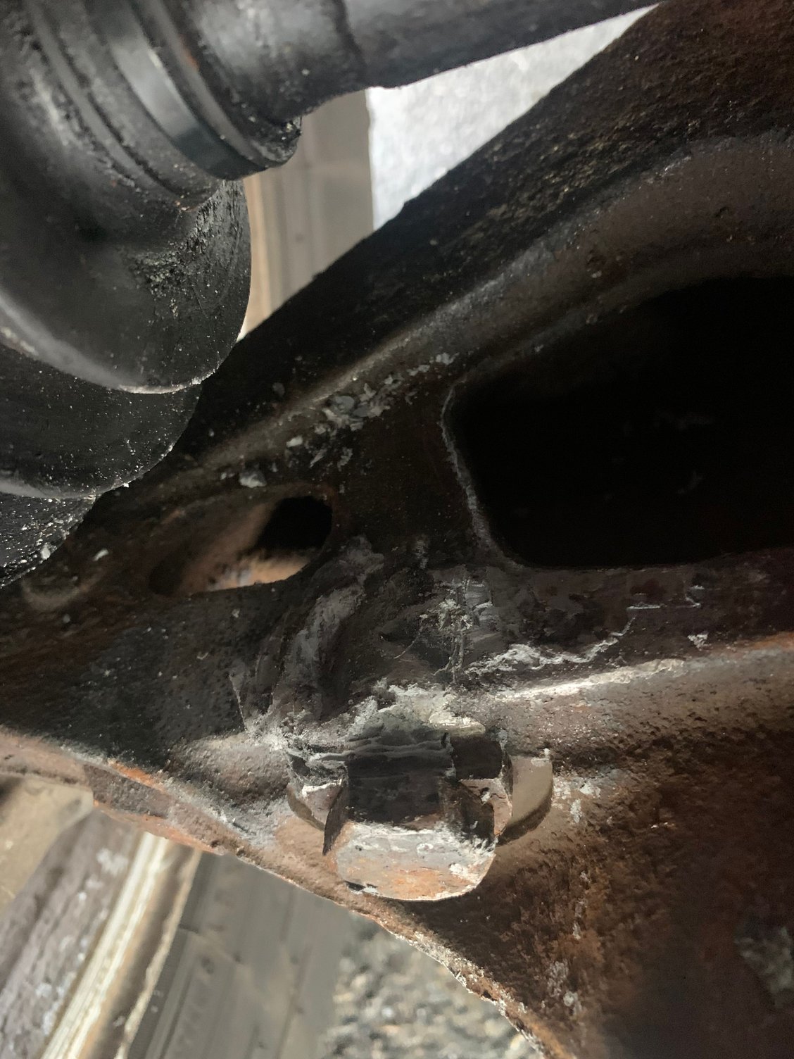

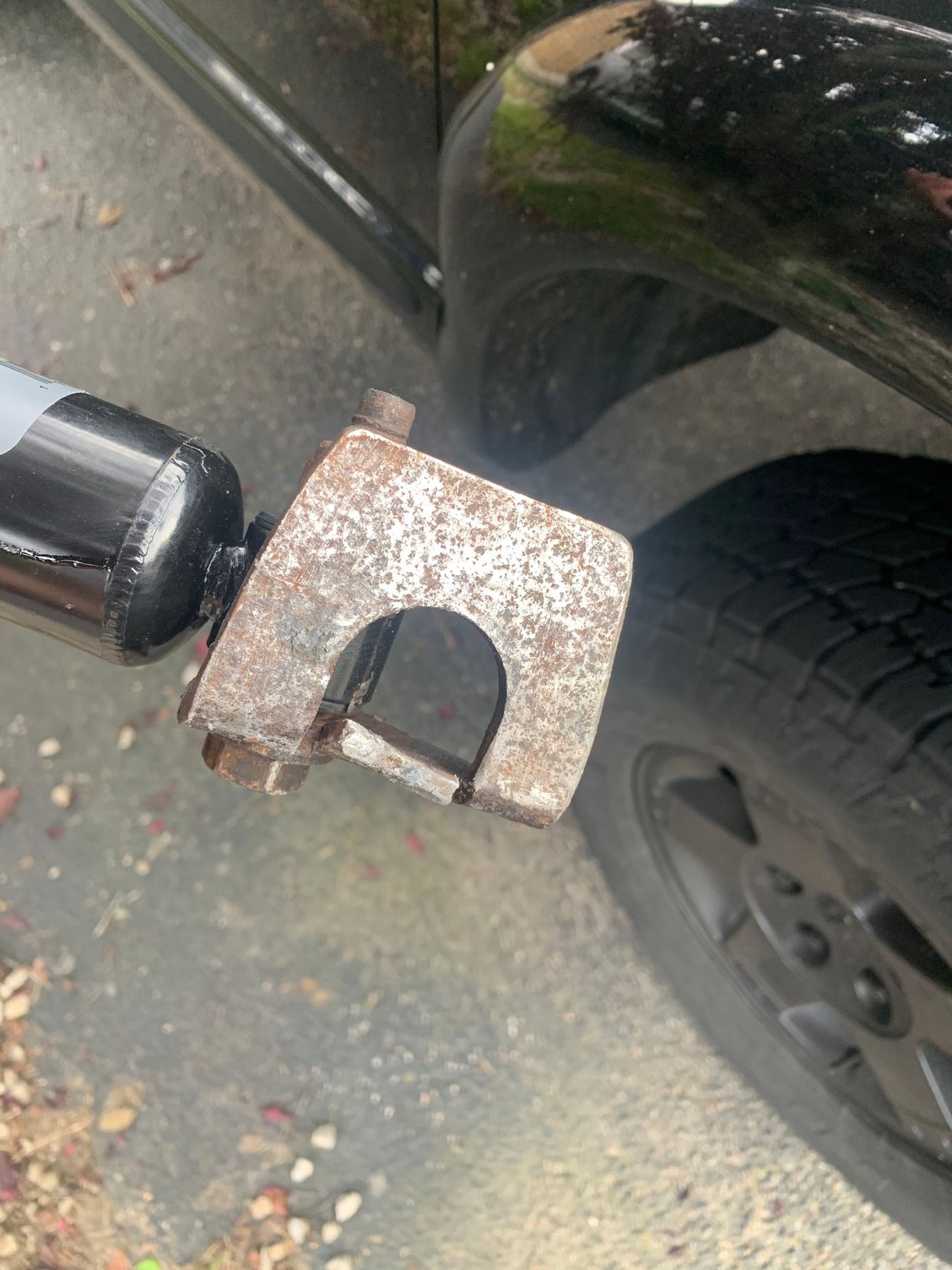

Sorry, I was under the assumption that they’re all the same. It’s a 2005 1500 slt 4x4 single cab 5.7 on a 3” rough country lift and level. The part I’m talking about is the bracket that the bolt goes through that connects the shock to the frame. To me it looks like it’s bolted in but dealership says it’s welded. On my broken part I don’t see any indication of prior welds. I’ll upload some pictures when I get off work

It's only held on by one bolt?? No wonder it broke..... If the one you posted earlier is for a 4x4, then that should work, and solve the problem permanently.

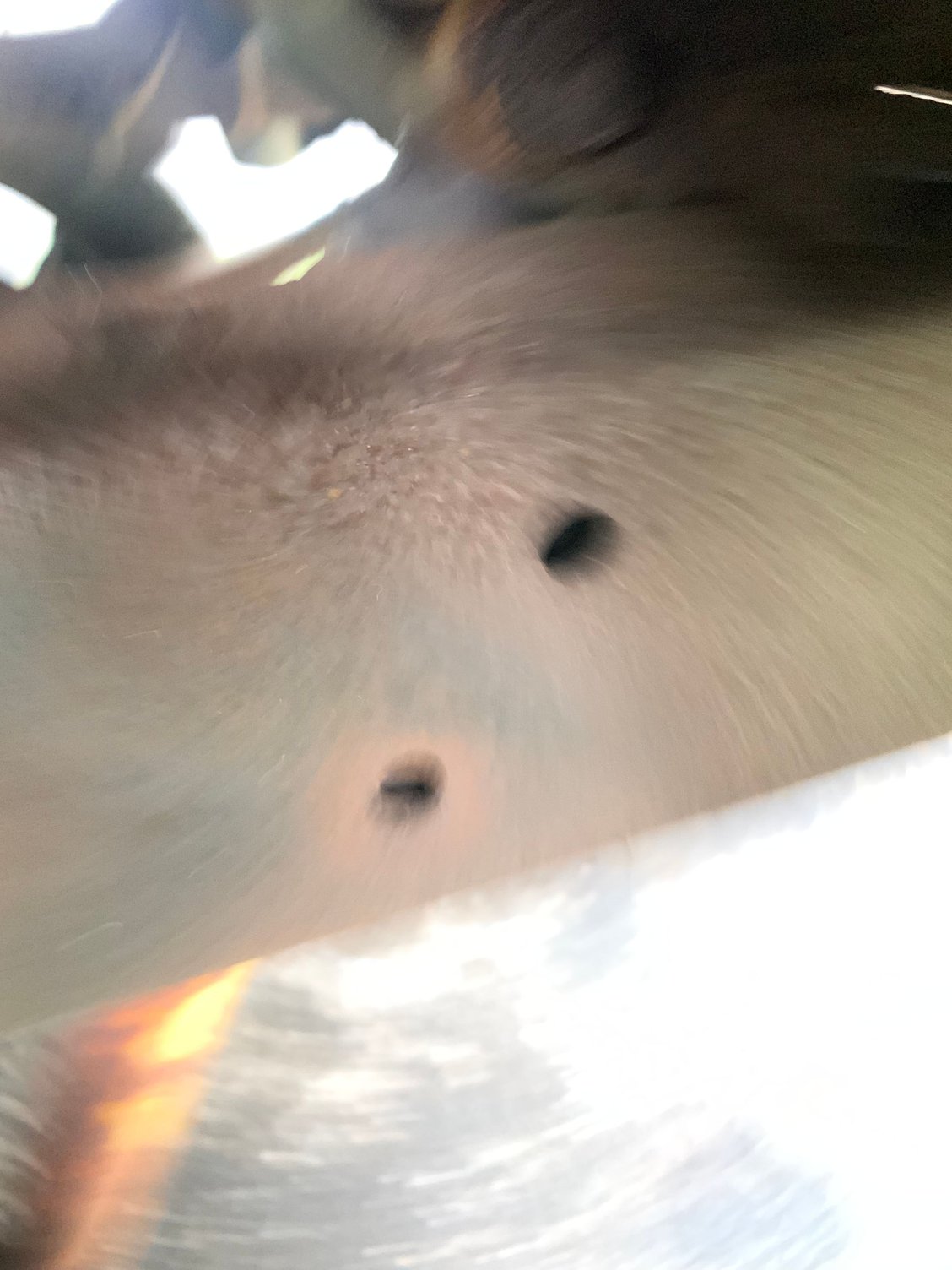

That piece that broke is not OEM. It was likely added as part of the lift.
The lower control arm is machined so that the bottom shock mount fits in the round form.
To mount the shock in the OEM location, you will need to remove the bolt that is shown in the last picture.
To keep your lift height, you should measure the distance between the center of the two bolts in the third picture, and add that to the length of your current shock.

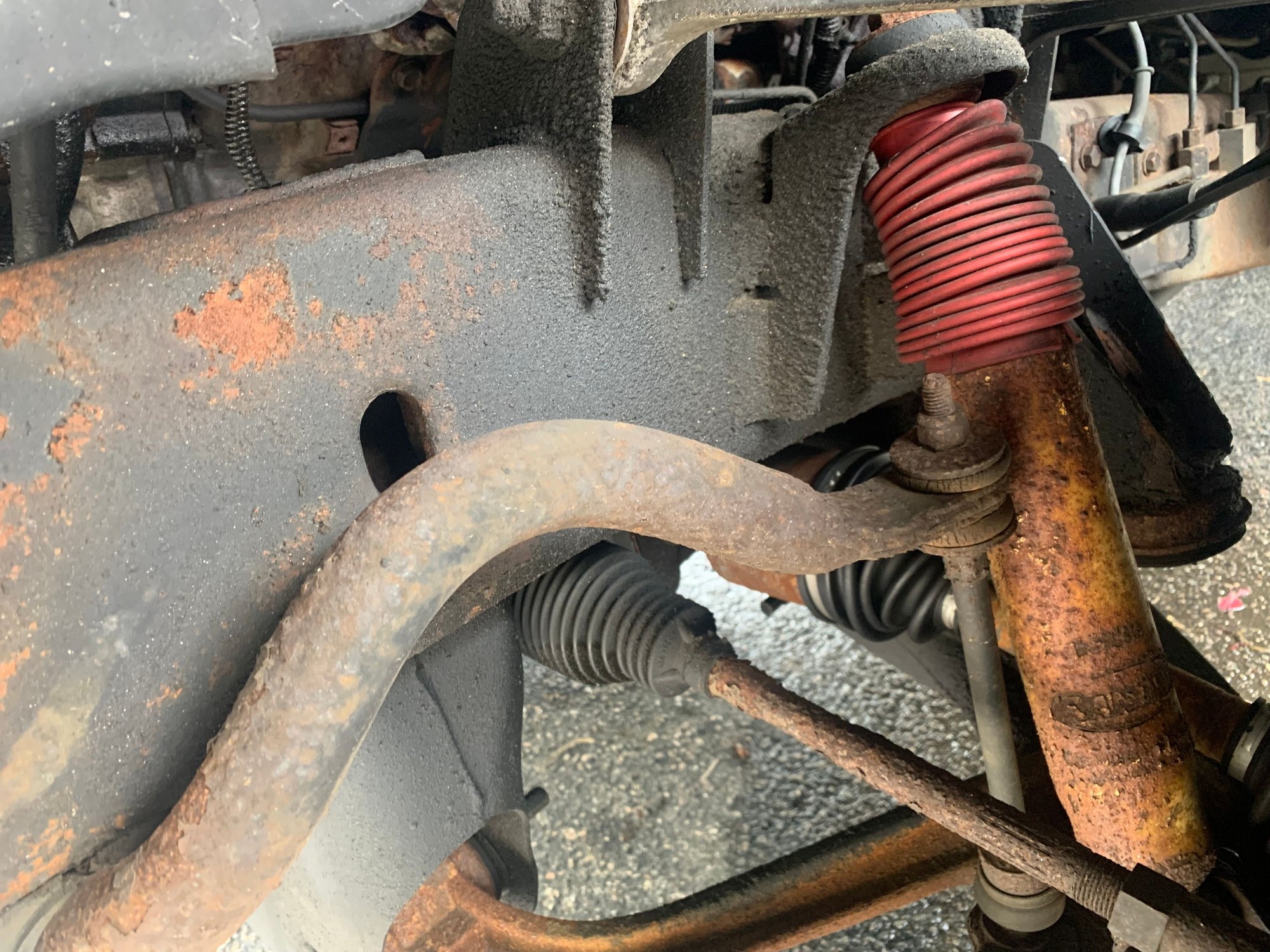

Can you post of picture of the top of the front shocks? I'd like to see if that was modified also. Can you get a part number for the current shock? We can see if it is the stock part or a longer shock for the lift.

I think you're going to find a 1.5 inch spacer block at the top of the shocks. The lower lift (that broke) is probably 1.5 inch of lift also, adding to 3 inches.
You'll need to decide how you're going to configure your shocks and control arm/upper shock mount connections. If you use the new fabtech part then you will locate the bottom of the shock 1.5 inches lower than current. This will lower your front a little and make your ride a lot rougher because you'll be riding on the coil up front.
